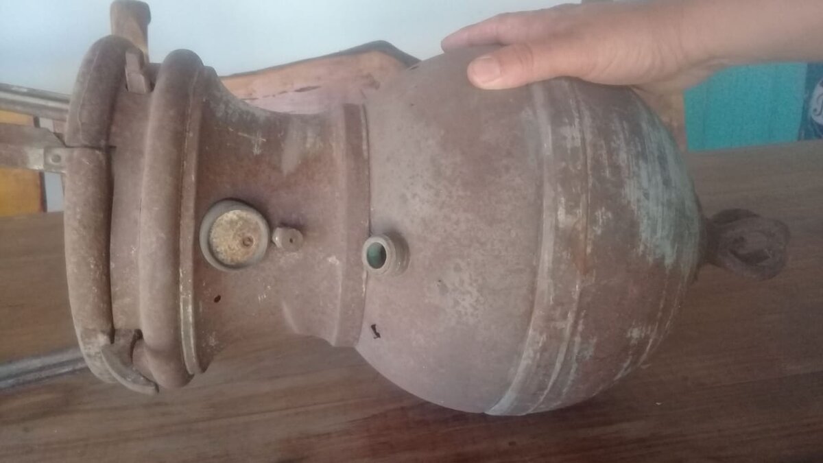

    i will need spare parts for this lamp. can somebody help me
    just bought this one in the shape you can see on the picture
    missing a lot, but i guess an unique piece

    Didier, Lux are very complicated lamps with a lot of parts, and among many, you miss the most essential one; the entire burner with its cleaning needle mechanism. It won't be easy to get hold of one of those. And all the gear around it, preheater bowls, windshields etc.
    The glass won't be easy either. And it looks like you have several holes in the kerosene tank, so I assume the entire tank is pretty rusty and thin.
    How is the air tank? Those are much thicker steel, so I assume it's fine, and the pressure regulator is serviceable, so will most likely work.
    I guess that if you manage to find a burner, the rest will be worth fixing, but a donor tank is probably better than soldering up this one.
    Here's how the burner look like:
    This is the windshield-cleaning needle mechanism-preheating arrangement which all sit around the burner illustrated above

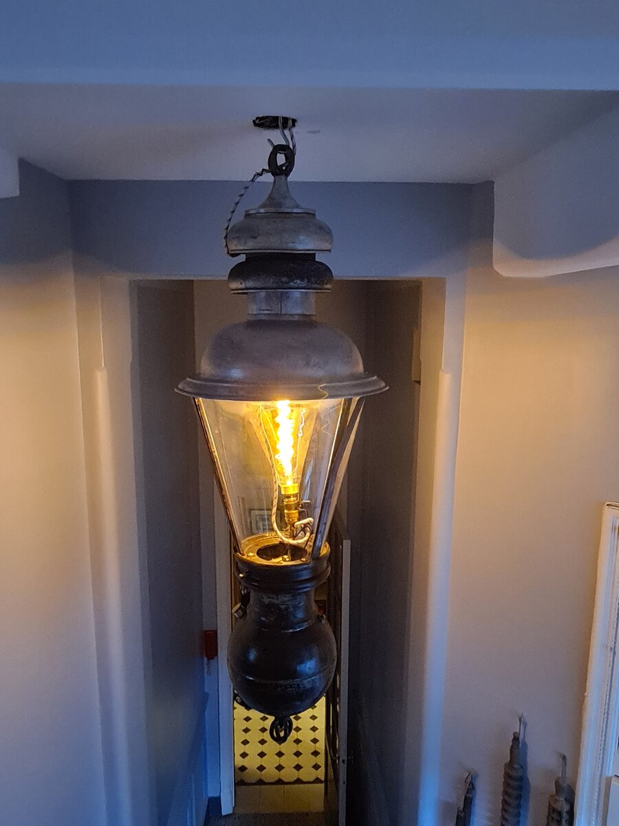

    as said before... FINALLY my glasses are ready...yooo hooo WhatsApp Image 2021-02-26 at 10.20.24.jpeg
  21. didier Argentina
    Dec 24, 2020
    83
    buenos aires Argentina
    it took them a month to make them and curve them to the based and the top diameter..

  29. MYN
    You are magnificent!
    Legend of legends...but why did you electrify it???
  30. Carlsson
    3,963
    Because of the missing burner and rusty tank, perhaps? These burners are very hard to find.
    Better to make a lamp useful than hiding it in a storage somewhere, and this is one way to make it work.
    Didier, well done!
    Good thing that you have a very high ceiling there. Otherwise you hardly would be able to use this giant indoor.
