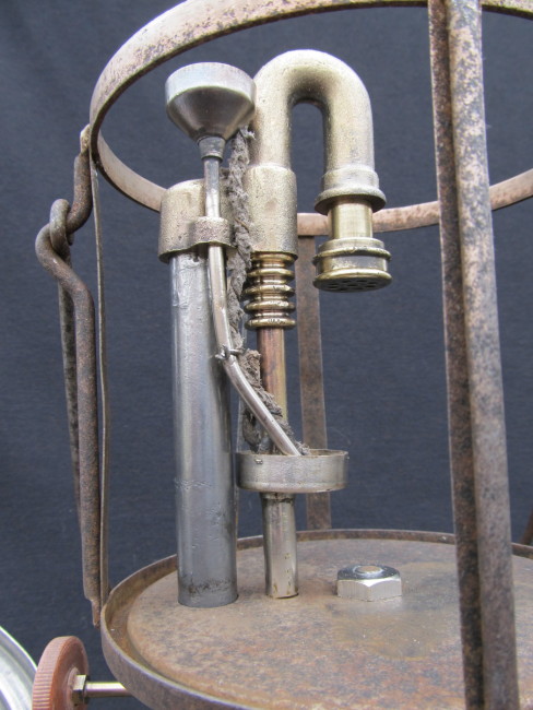

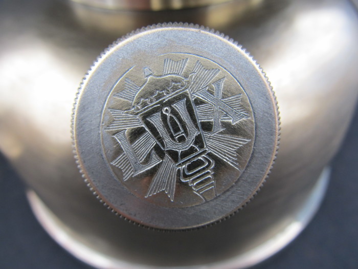

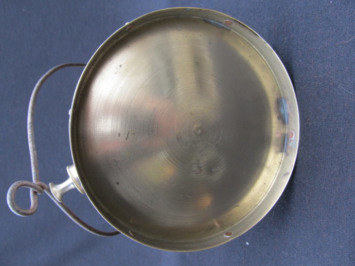

    I just got lucky buying a box of lamps. In between there was a battered LUX Sirius. It made the grey day shiny and I tried to fix it as gentle as possible.
    All parts is there - but the needle was gone. The bottom was cut of :shock: and riveted back on + soldered. Despite all the lamp works and I wont allow my self to be picky here.

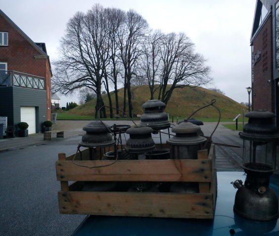

    Here you can see the city og Jelling where I found the lot. In the background you can see where Gorm den Gamle, a old King is burried and on the other side is yet a hill made for his wife, Thyra Danebod, a old queen.
    The city existed up till now since 500 years BC as a steady city with houses and this was the King and Queen that introduced christianity to Danmark. Haral Blåtand was their son.
    A fit place to find a LUX Sirius :D

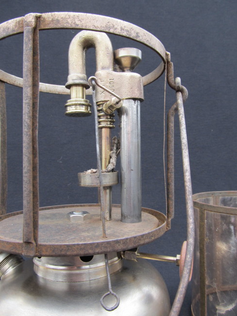

    Just noticed that this lamp has a coil on the carrierhandle and Christers lamp dont:
    http://0flo.com/index.php?threads/17
    This brochure from 1916 shows "Christers handle"
    http://0flo.com/index.php?threads/6922
    Wonder if its something homemade coil or later production :?: .

    That is a very fine lamp, Claus. I love the over-engineering of the preheat cup filler and the fins on the vapouriser. What is the purpose of the part that protrudes from the fount near the rim?
    The replacement of the fount bottom seems to have been very well done.
