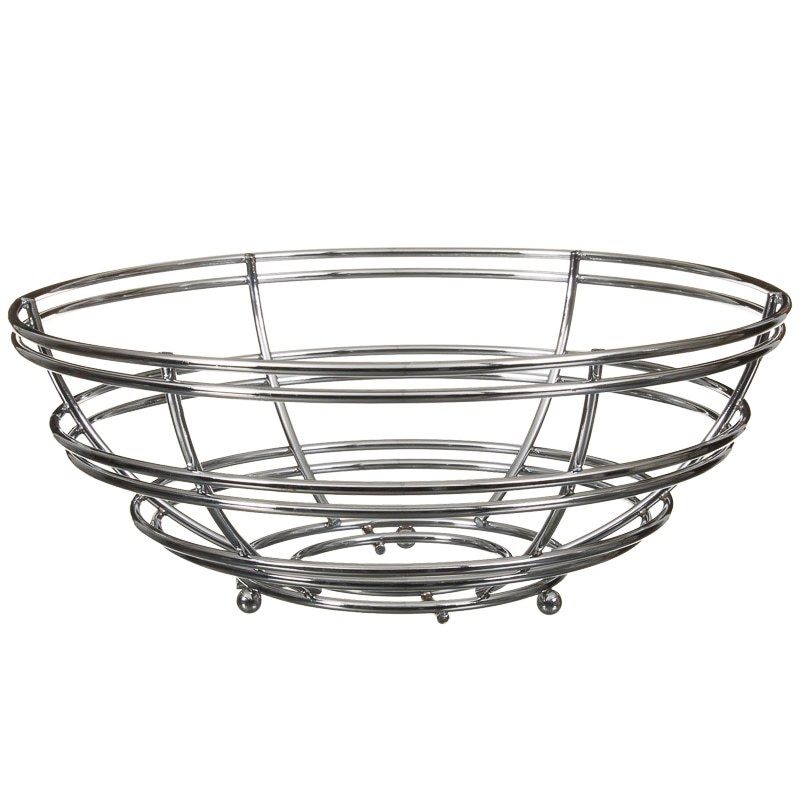

  30. Mike Painter United Kingdom
    Apr 19, 2019
    2
    Waltham Abbey, UK
    Good afternoon
    For those that may require a 'quick fix' for a missing Bialaddin Bowl Fire Guard, I have found a chrome wire fruit bowl on Ebay, which is the EXACT size of the outer diameter of the reflector bowl.
    Cost is £7.20
    It does have a very 'Deco' look about it and is made of quite substantial wire (Around 6mm)
    With a little bit of judicious trimming off of the little ball feet and a few odd sprigs, I think it would look very presentable.
    I am working on mine over the next couple of days.
    Ebay link atached for any interested parties.
    Premium Chrome Wire Fruit Bowl/Basket/Holder Display Kitchen Storage - 324226 1000032422602 | eBay fruit bowl.jpg
