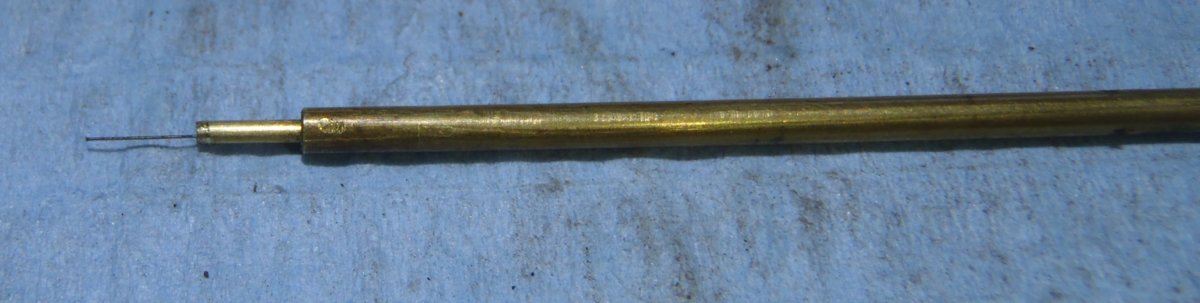

    What lantern are you making a cleaning needle for?
    I gave up trying to drill a 0.3mm hole and now use brass tube that I got from a local hobby shop.
    The brass tube is 1mm dia with 0.4mm internal diameter. There is also a 2mm tube that the 1mm tube will slide into.
    I have also found that a #27 hypodermic needle will fit into the 1mm tube (making crimping easier).
    I use a lathe to drill the 1mm hole in the end of an existing rod. Like this Austramax.
    Austramax ready for crimping.

    the picture above is what I either need to make or drill out need on my handi kero pet I'm working on.
