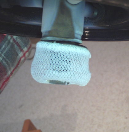

    And then you can have my luck and have a Tilley Happy Mantle do this to you:
    This mantle appeared secure and had about 5 hours on it when it detached somehow. I replaced it with a Base Camp Pro that went on quite nicely :)

    Hello AL, I have now had the same problem with a Tilley Happy mantle and so have two of my neighbours.
    I have never had that problem with any of the older Tilley Happy mantles, but the build quality of the modern mantles varies.
    The metal which is used to make the ring nowadays is not always able to cope with the heat.
    Sometimes the ring breaks and sometimes it expands, but the result is the same, the mantle falls off and shatters.
    In my opinion, another fault is that the weave of the modern mantles is to loose, Jeff.

    Interesting... I've stopped using new "Happy Mantles" for the X246 because of the same problem Mr Al has had.
    BTW I bought a bunch of Tilley mantles from Japan at a goog price. They are rather bigger than the standard X246 mantle, and their string-ties are a bit weak (and sometimes break while tying and require an additional string) - but they burn-in very well, give a good bright light without flaming outside the mantle, and appear to be lasting very well.
