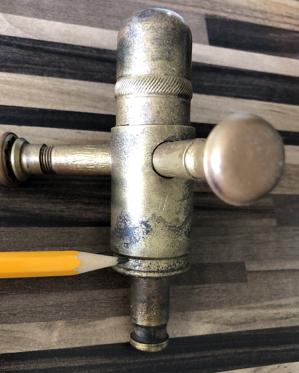

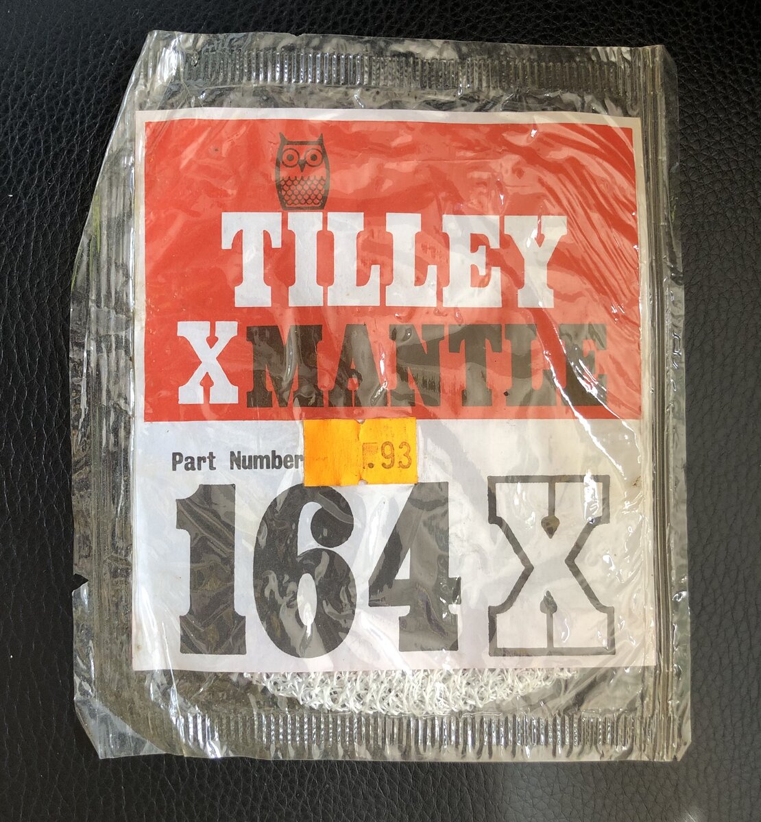

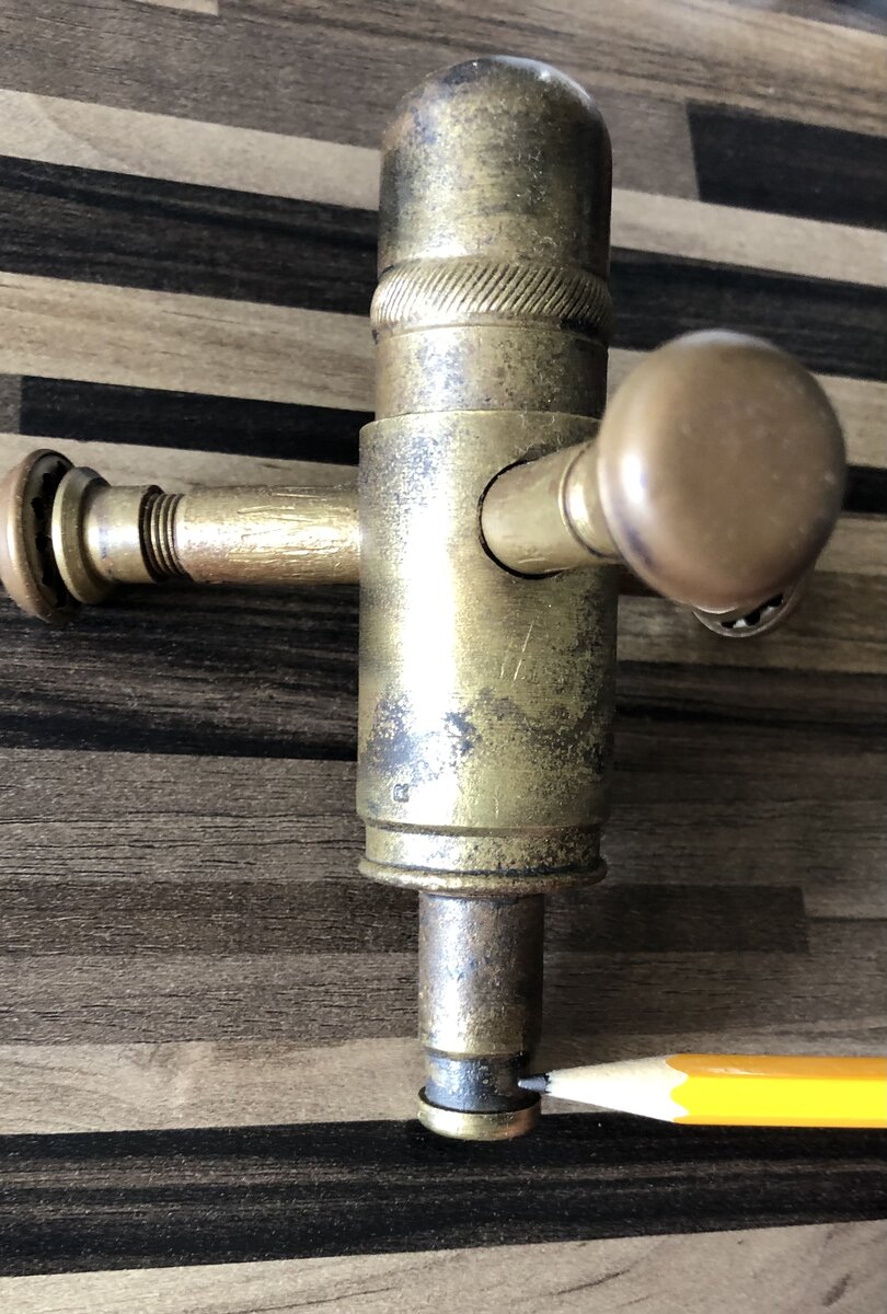

    Because the tilley burner sits over the vapouriser it has 2 holes of different sizes, the standard 164X mantle supplied by Tilley was pre-tied to give a good fit on the burner ..
    .. and the spigot..

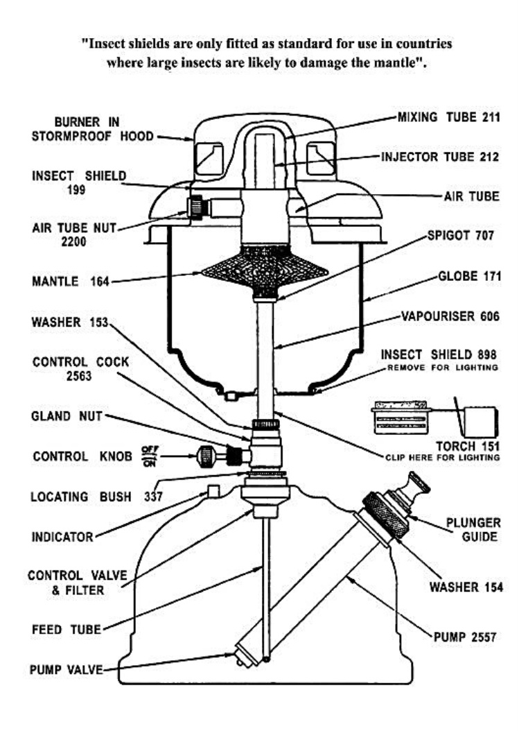

    this is a useful image from the Reference Gallery..

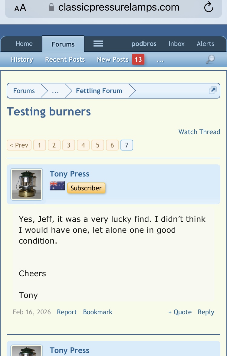

    and forgot to say that you can assemble and test without a mantle using low pressure ? without a glass as well if away from draughts
    there is a great series of threads by tony press, heres a screenshot,
    i cant do the link on my phone but a quick search with the search bar should find it..
    on the first page, (scroll down a bit) he tests a tilley and because the mantle hasn’t been fitted it’s possible to see some issues that need to be fixed?
