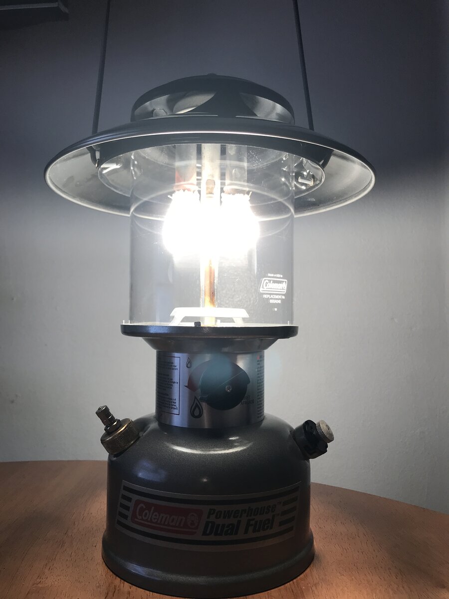

  10. Hanzo
    Feb 2, 2016
    574
    Here's my Powerhouse burning with the Fogas 300-400 mantles, I've mostly used 250 cp mantles in mine though. IMG_1310.JPG

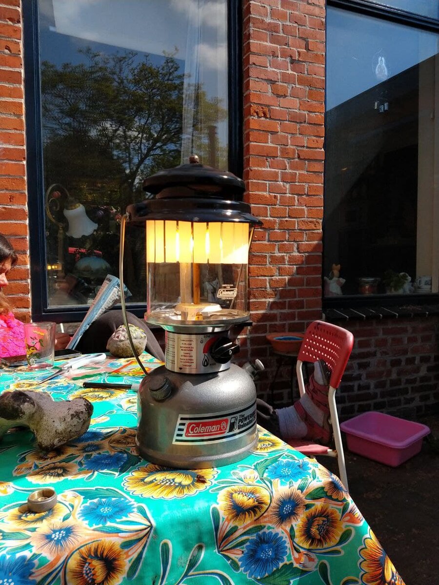

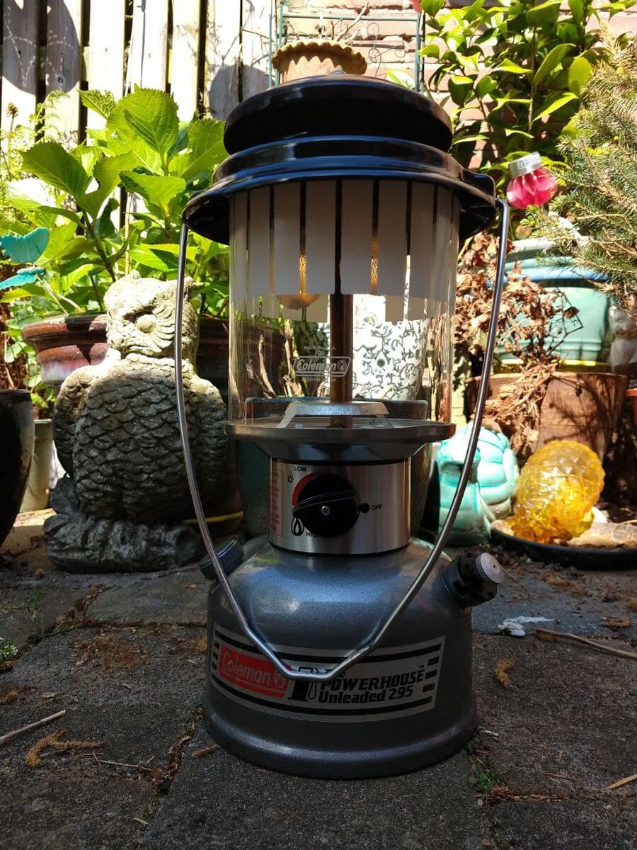

  12. Glühstrumpf Netherlands
    Feb 16, 2022
    9
    Netherlands
    Bought a couple of Luxor 300/400 mantles and ta-da!
    I had to change the fillercap gasket and make a bail. I used an old splashguard holder as bail.
  13. podbros
    4,028
    Well done ! Looks great and the handle is just the job :thumbup:
