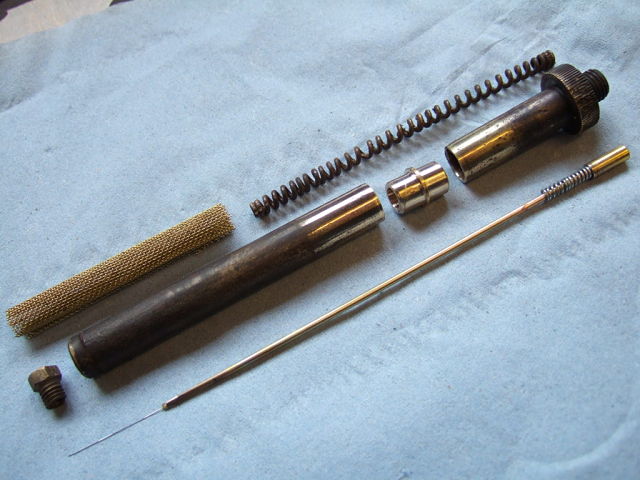

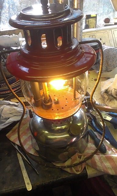

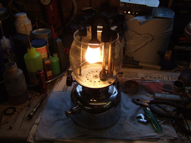

    Martin sent me his Veritas vapouriser as it was playing up like they usually do due to overfueling & dimming out etc :doh:
    I checked out the jet which was a bit oversized so this was re-sized & after heating & quenching the vapouriser i tried it again , but i could hear rattling inside which meant carbon build up & it wouldn't come out due to the design :doh: so it was surgery time :twisted:

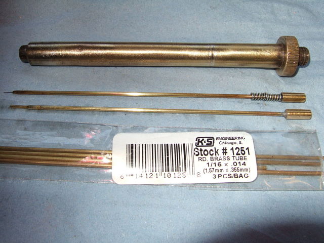

    Unfortunately the pricker wire broke during the second test :doh: :rage: so i made a brand new one from scratch & this is working very well :D :thumbup:
    I split the tube across just over two thirds of the way down from the tip making sure i measured the overall length before i started :D :thumbup:
    Plenty of carbon & some bits of old heat resistant wadding came out but to my suprise so did a soft wire coil which centralises the pricker assembly :-k :thumbup:
    The tube was cleaned out & a brass jointing plug was turned up on the lathe to fit it all together again & a small slip ring was put in the bottom of the tube to make sure the coil was always centered all the way through :D :thumbup:
    I pondered over putting fibre glass wicking in the tube , but an idea hit me to put a coil of fine brass mesh in to transfer heat into the fuel like a Primus lipstick stove vapouriser 8) :thumbup:
    After silver soldering it all together again i put the vap to test but it was still overfueling slightly :doh: ](*,) so i engaged the pricker to see if the vapouised fuel was leaking past the jet & lifted the burner off the lamp which was just loose fitted for the test. Much to my consternation :roll: the gas vapour was leeching out past the crimp that holds the jet seat to the upper part of the tube not the jet , so i stripped it all down again , silbrazed the tip up & re-did the test [-o< :D :thumbup:
    Back togther for the first time :D :thumbup:

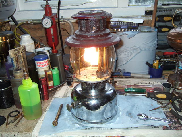

    Success the lamp worked "Superbly" ( Pun definately intended :D ) & settled down very nicely , the lamp was tested for three hours without a blip 8) :thumbup:

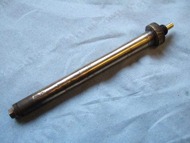

    The finished vap with the new pricker rod & the old for comparison 8) :thumbup:

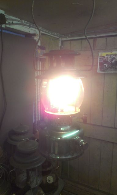

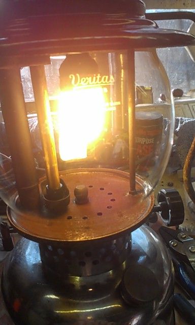

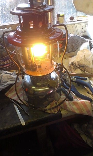

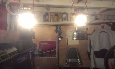

    A few photos to show my veratas both working.
    Thanks again Stu.
