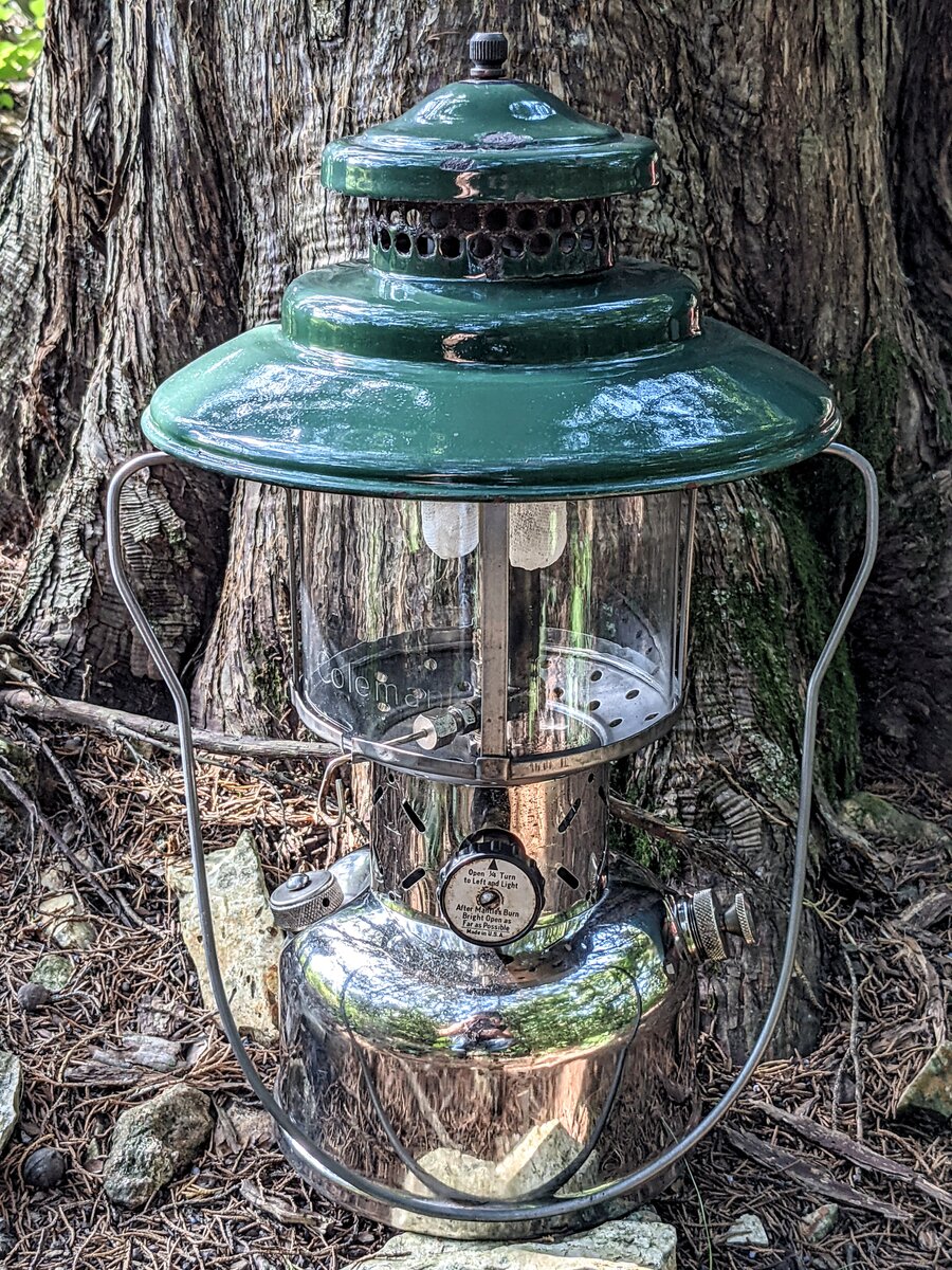

    A fine example!:thumbup::thumbup:
  3. ROBBO55
    4,432
    It cleaned up nicely, Toby. :thumbup:

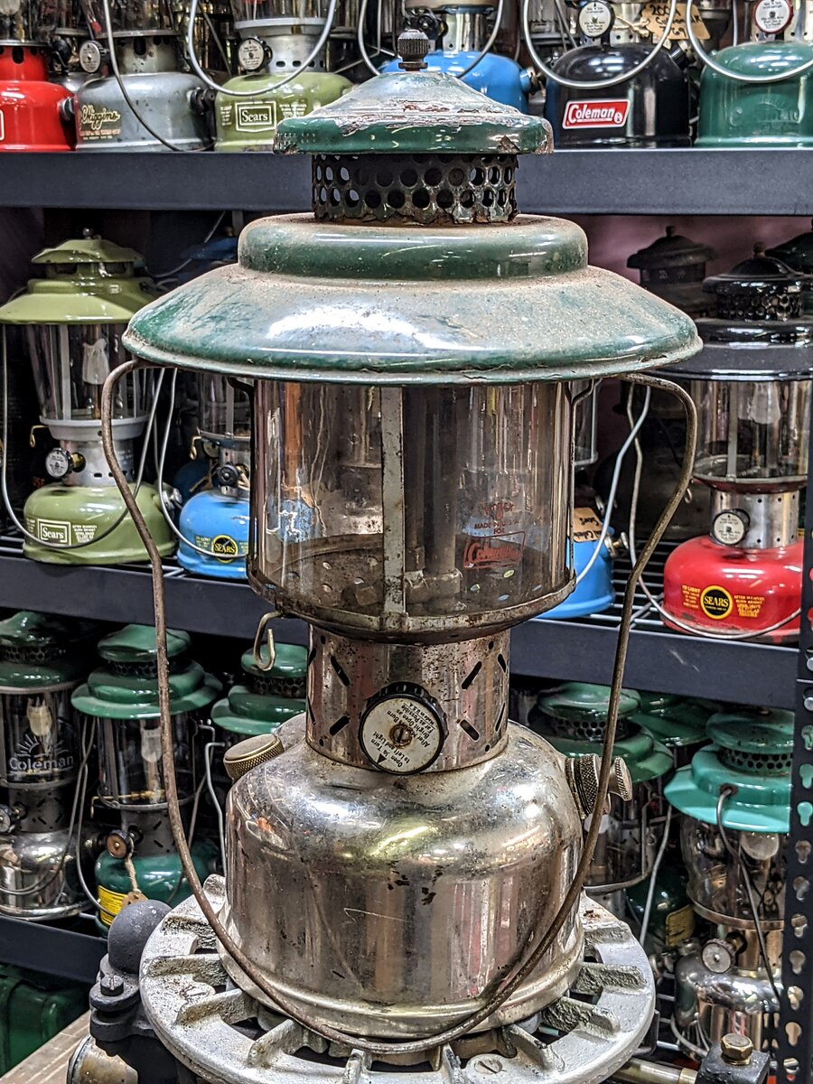

    Looks like it was a bit of a struggle to get it apart.
  4. MYN
    A great restoration back to working conditions. It is looking fine.

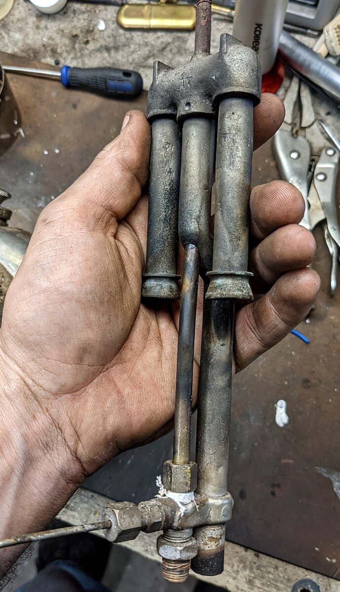

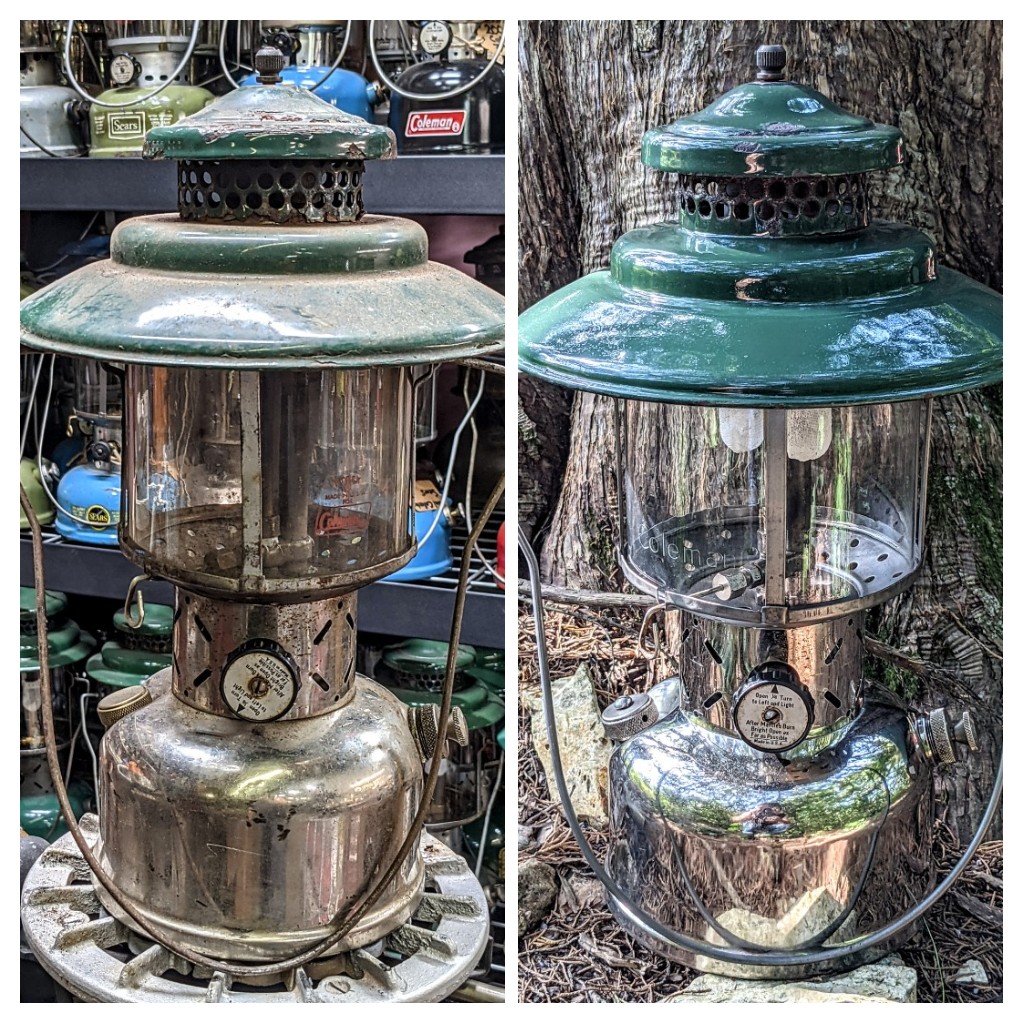

    @ROBBO55 it was a typical 220/228B breakdown. I try to show how I tear down these early brass fount lanterns to keep from damaging the fount. I just noticed I did not show how I remove the valve assembly tho :D maybe next time! ;)

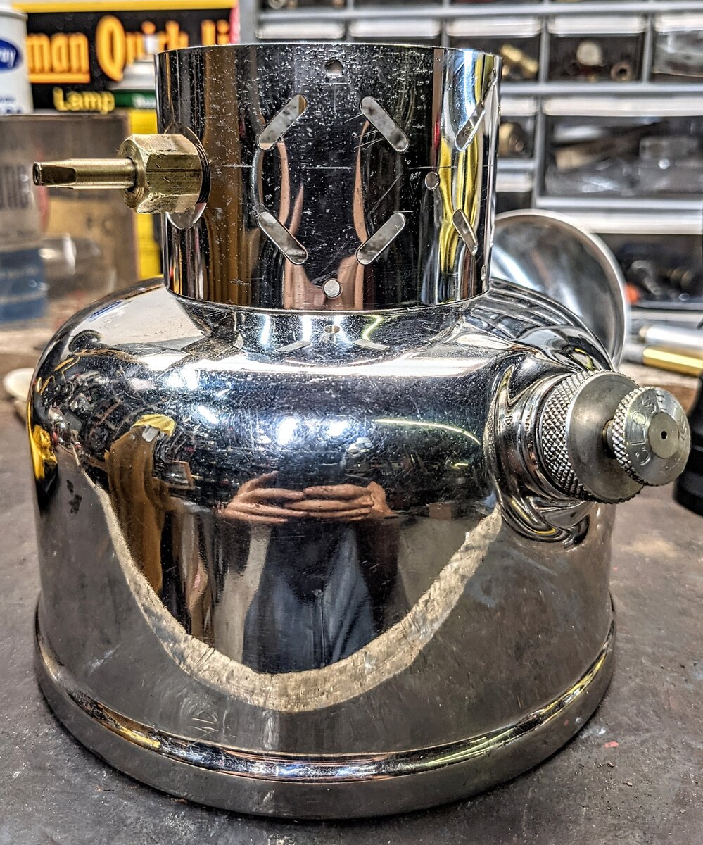

    What/how did you get the fount nice and shiny?
    John
  7. Toby Garner
    Jun 13, 2021
    477
    SW Missouri
    John I use oven cleaner containing lye and scrub with 0000 steel wool very lightly until the nickel feels smooth, then rinse and dry. Next I use mother's mag polish with a drill buffer on low speed as I'm running low on elbow grease :) Finally I give the nickel a final rub down with a clean micro fiber cloth to clean the remaining compound. Easy as that :thumbup:
