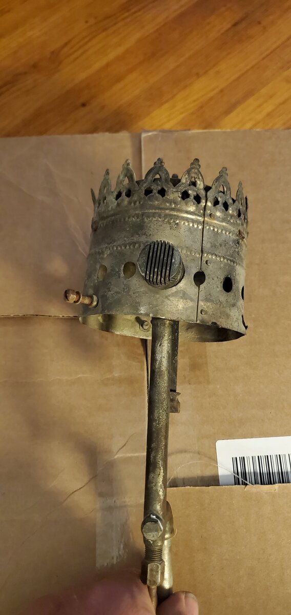

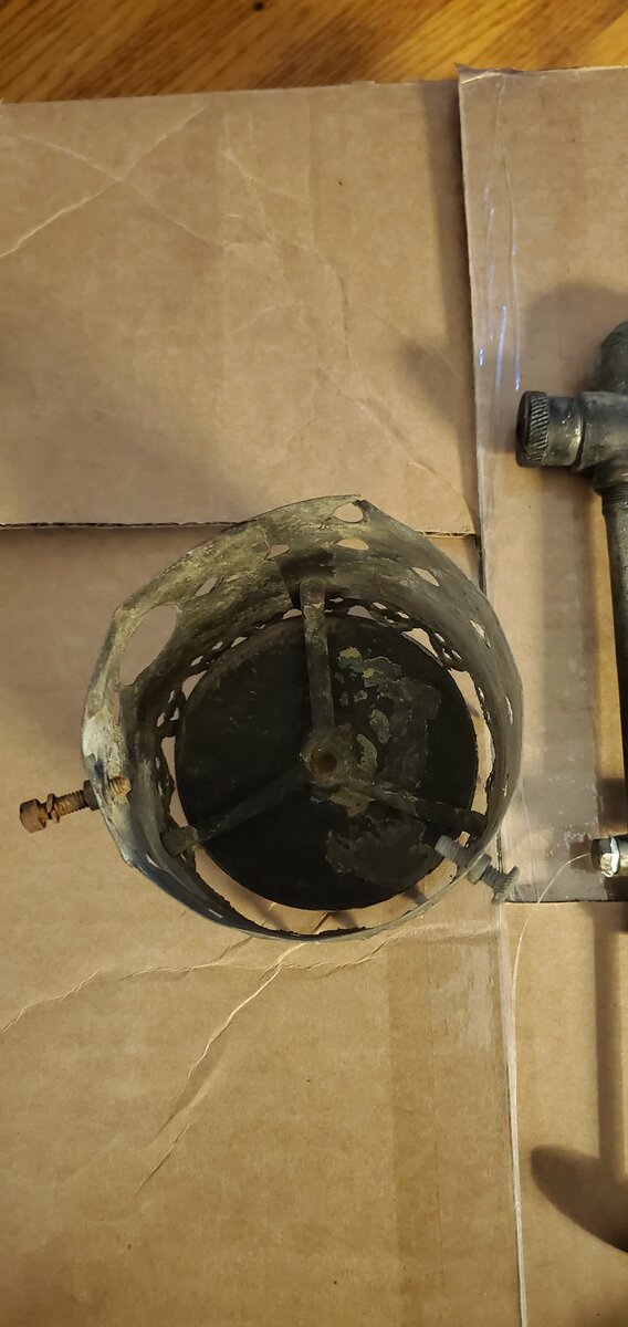

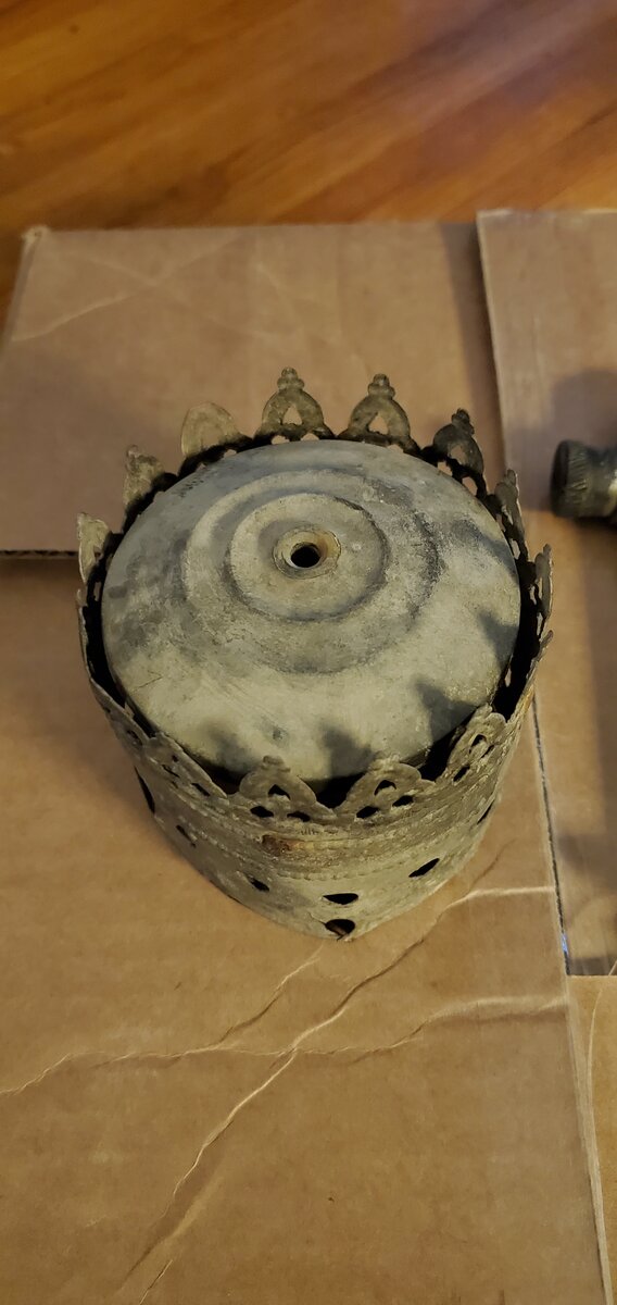

    Saw this and just had to get it for a closer look. Looks like the Diamond (not Akron) in the PLC. 20201223_172234.jpg 20201223_172252.jpg 20201223_172350.jpg 20201223_172357.jpg 20201223_172409.jpg
  2. Mackburner
    The burner head certainly looks like a Diamond Light Co. This is the only example of this lamp I know of.
    It doesn't have that vertical control though so the complete lamp would not be the same as Jon's lamp I have listed in the PLC.
    The company only existed for about three years from 1910 to 1913 so any examples are going to be rare. An interesting find though and one I wouldn't have passed by either. ::Neil::

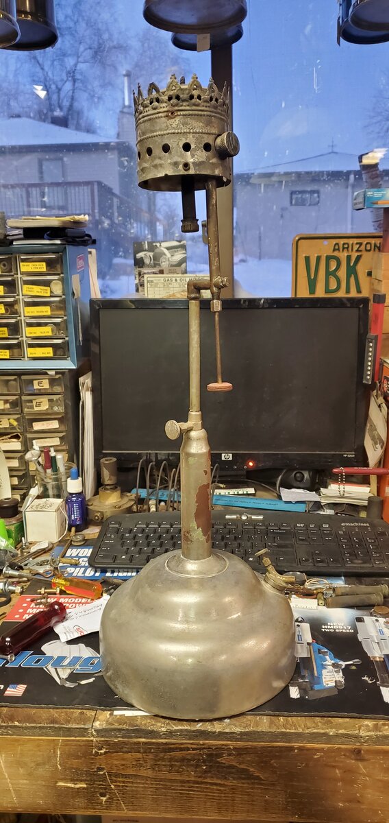

  8. Dean D
    Dean D Subscriber
    May 21, 2017
    272
    Minnesota USA

  11. Mackburner
    I assume the ad cut is for a Diamond lamp? That tank is the type used by AGM, Brite-Light and several other brands for the P66 type lamps. ::Neil::
  12. Henry Plews
    3,050
    That's what I thought.
  13. Dean D
    Dean D Subscriber
    May 21, 2017
    272
    Minnesota USA
    Neil, the last picture I posted is how the lamp was posted for sale, it was taken apart for shipping as in the first pictures without the fount show.

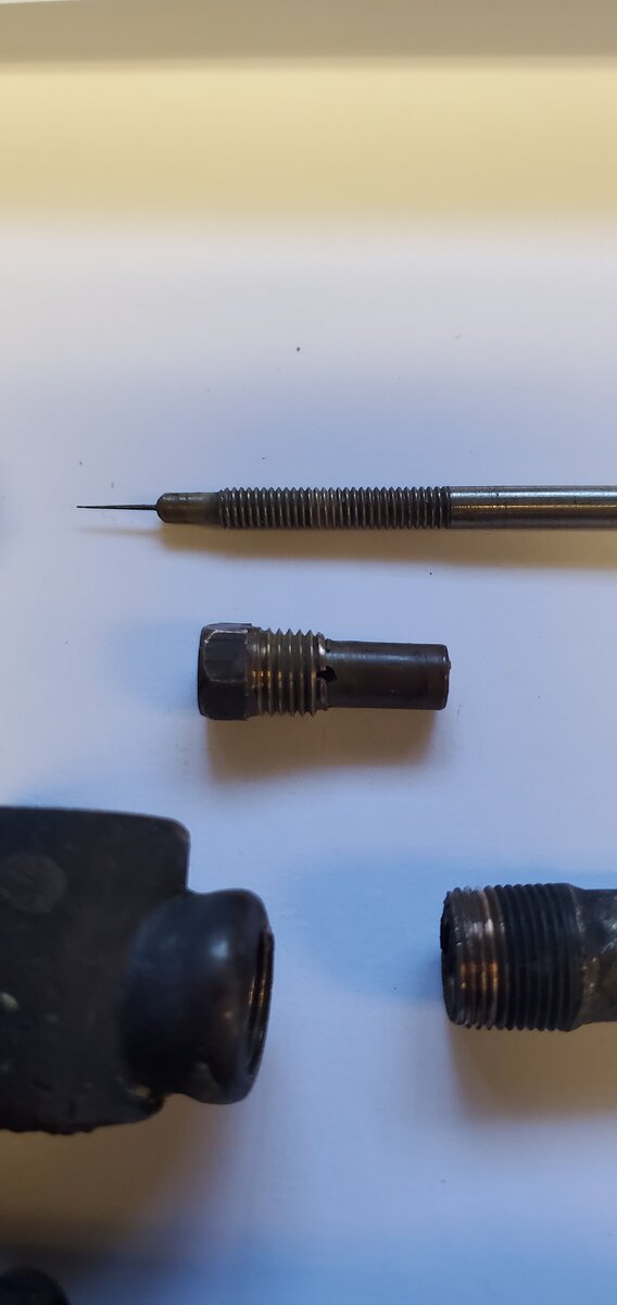

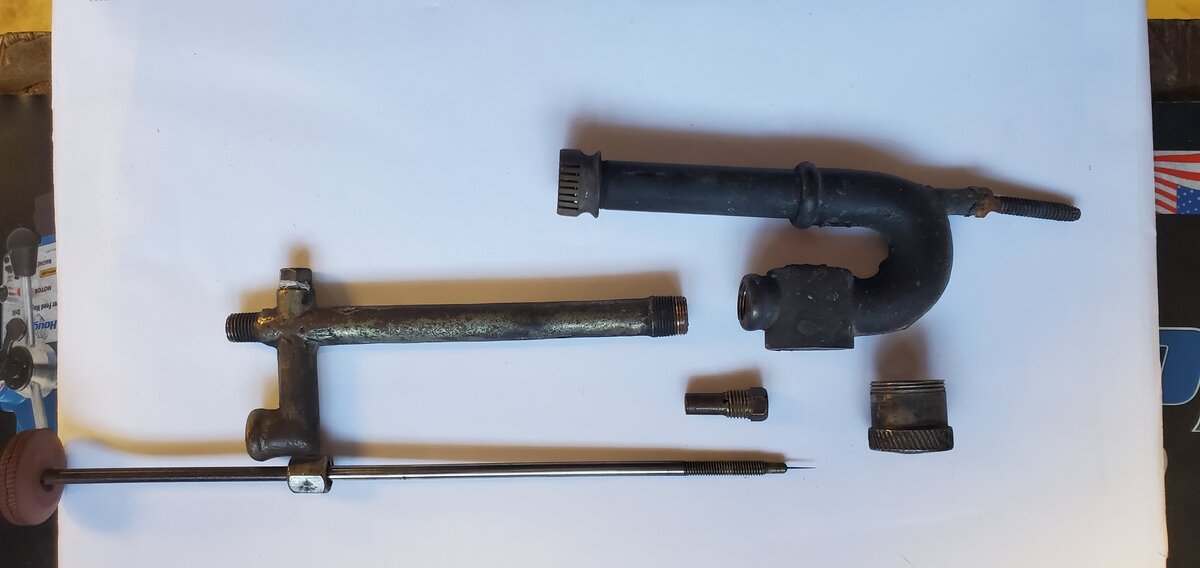

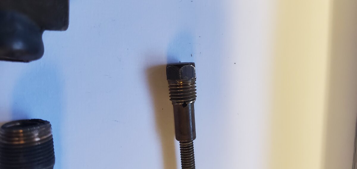

    It's very interesting how the pricker rod threads into the jet where it enters the mixing chamber and nothing is broken and it came apart easily.
  14. Mackburner
    Dean. So it has a pricker as well? Be interesting to see the detail sometime. Is the fuel flow OK? I have had a couple of those tanks with a blocked feed and they can require major surgery to clear. ::Neil::
  15. Dean D
    Dean D Subscriber
    May 21, 2017
    272
    Minnesota USA
    Neil, yes pricker is intact and everything it clear.
    I will get some pictures of the pricker and jet and will post.

    Pictures of the pricker and jet.
  18. Steve p
    Jan 14, 2018
    7
    The burner / pricker assembly is very interesting. Nice that it's all intact. Look forward to seeing it burning sometimes. Good luck with it Dean.
