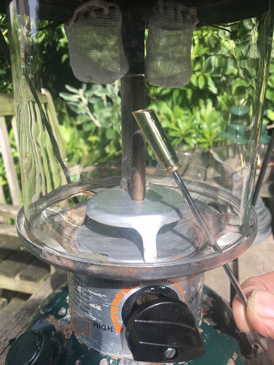

    I find it easy enough to light the spirit in a spirit cup on a kerosene lantern, but naptha-fuelled lanterns present more of a problem. Long-pattern matches or tapers often extinguish before the fuel vapour ignites, in my hands at least, and the head of an extended stem lighter (I have a Soto) won’t fit through the base plate access holes.

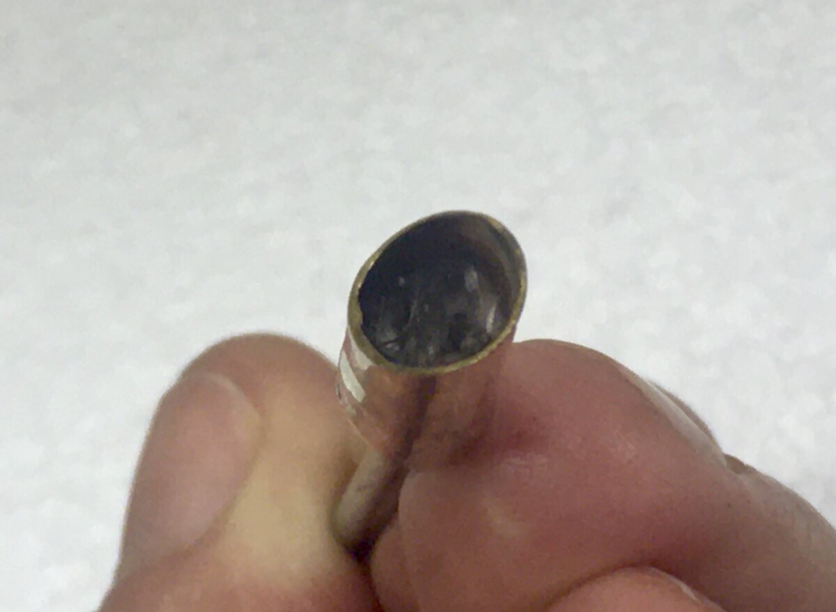

    I’ve made a lighting torch by silver-soldering a length of brass tubing to a stainless steel rod, a loop formed in one end (for neatness).
    I’ve stuffed a piece of fibreglass rope in the tube to prolong and moderate the burn.
    Charged with a dribble of meths from a dispensing bottle, the flame lasts for about a minute, plenty of time to light my lantern.

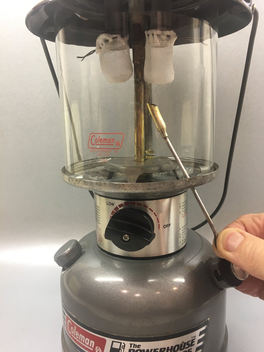

    Come to think of it Robbo, not an original idea. Scaled down in size maybe, but I must have had the lamplighter in mind - pole with some meths-soaked rag in a receptacle on the end if it.

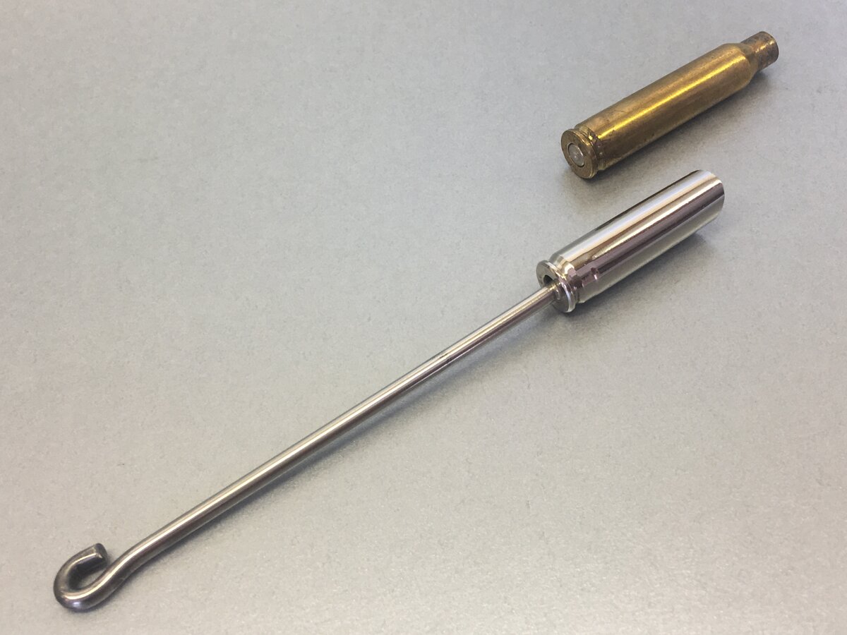

  7. presscall
    1,790
    Lancashire, UK

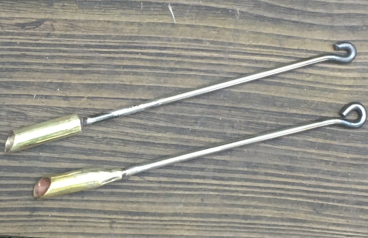

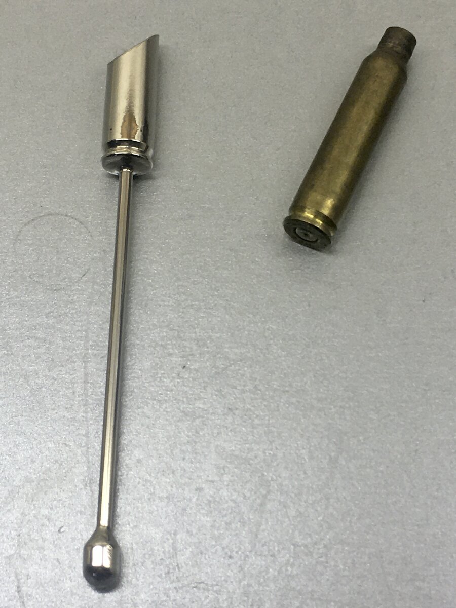

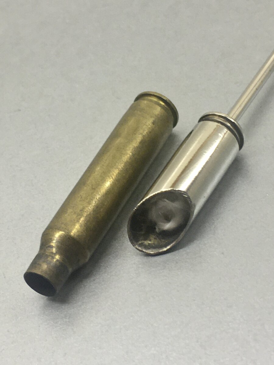

    A bullet cartridge case would be a handy basis for making one.

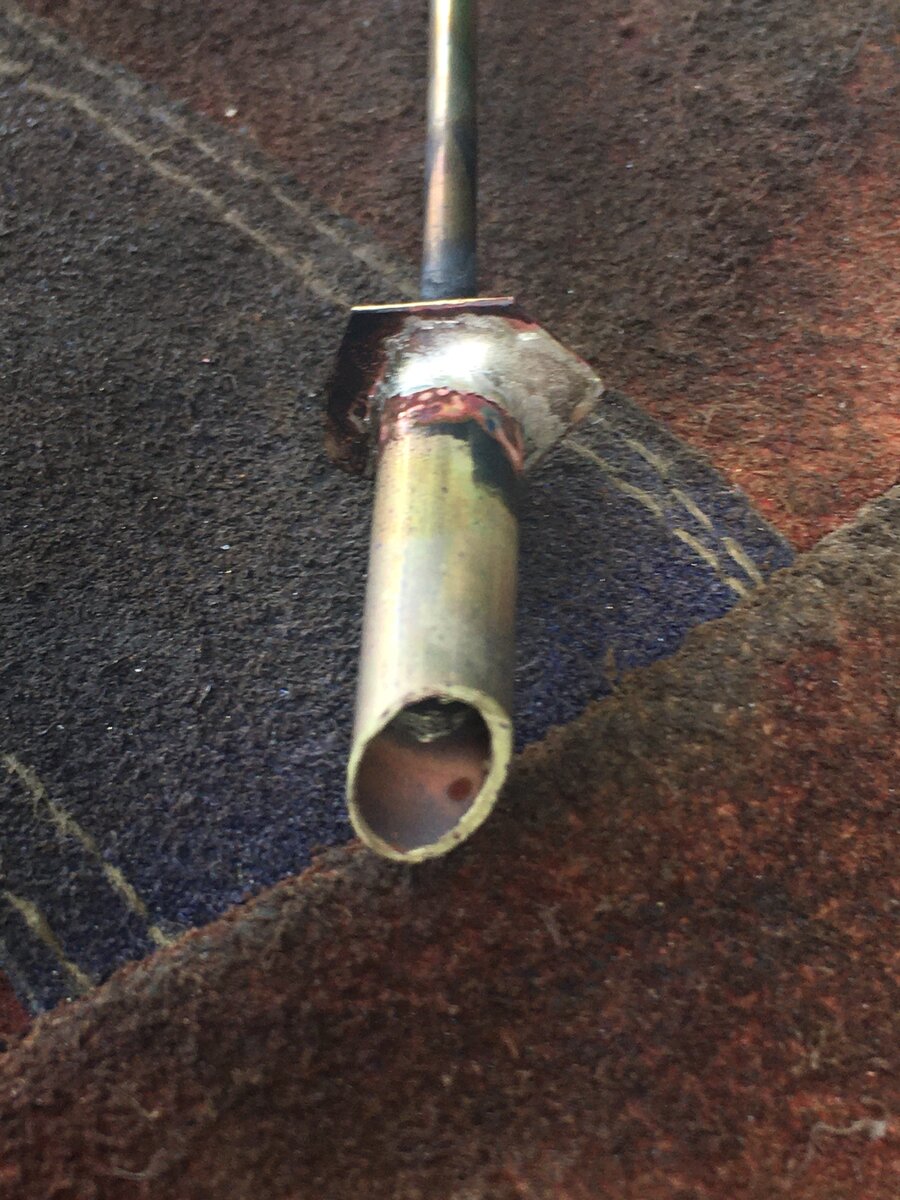

    In the absence of any such spent ammunition, I made a second one, using brass tubing and a length of steel rod.
    After the silver soldering, before trimming and tidying-up.
    Completed.

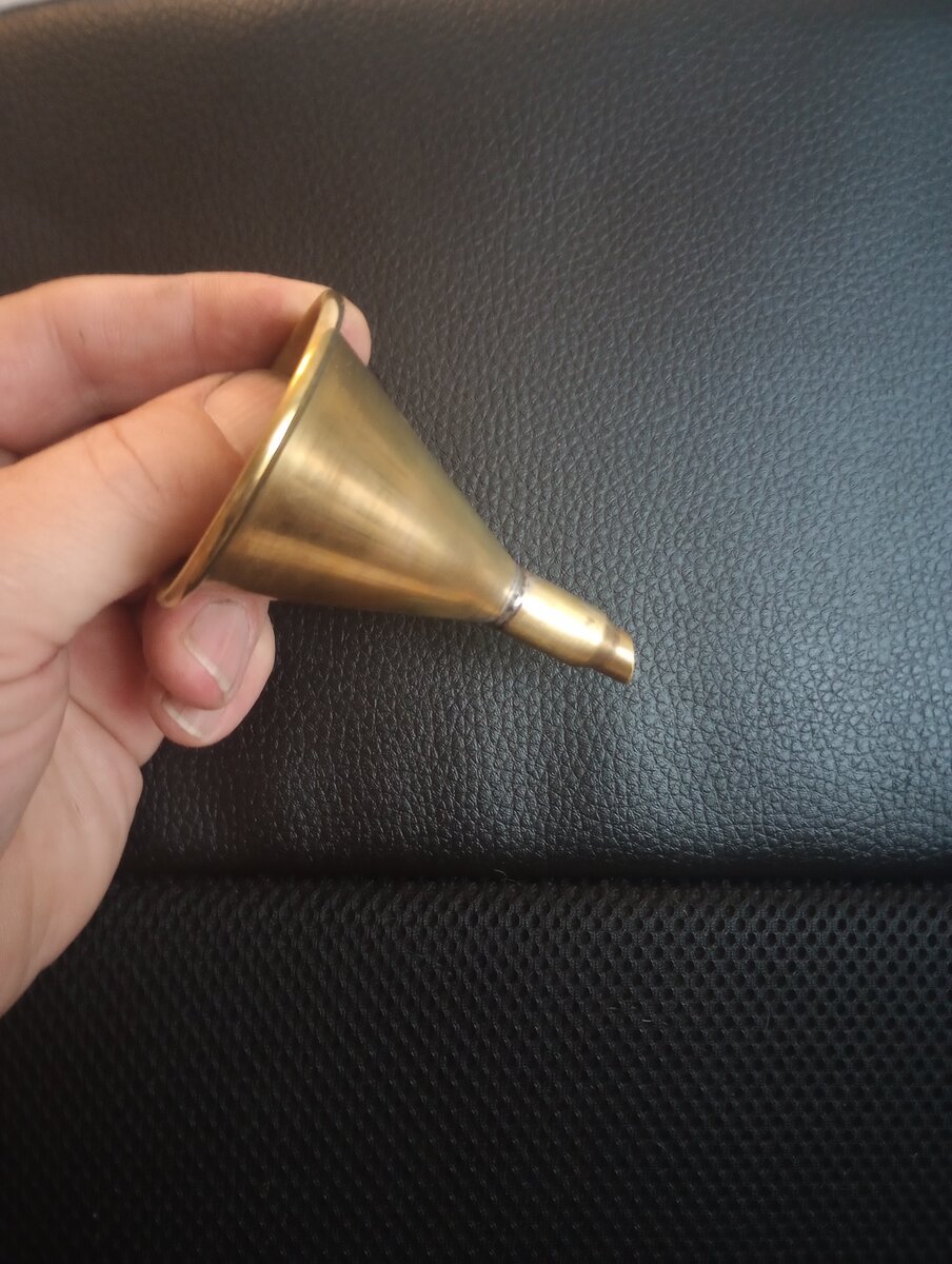

    Great idea John. I love such simple solutions. As for the husk. I once used one (9mm), due to the lack of a tube, for a funnel.
  15. presscall
    1,790
    Lancashire, UK
    @Knee
    The funnel hits the target with me Stanislaw.
  16. ColinG United Kingdom
    4,816
    Wow, that's a beautiful little funnel you've made! Did you make the cone section or use something you found?
  17. Knee Poland
    Sep 1, 2023
    98
    Poland
    John, sorry I got so caught up in your thread.
    :oops:
    Thanks @ColinG .
    The cone was made for me by a guy who spins brass. Great craftsman.
    I just soldered the shell.

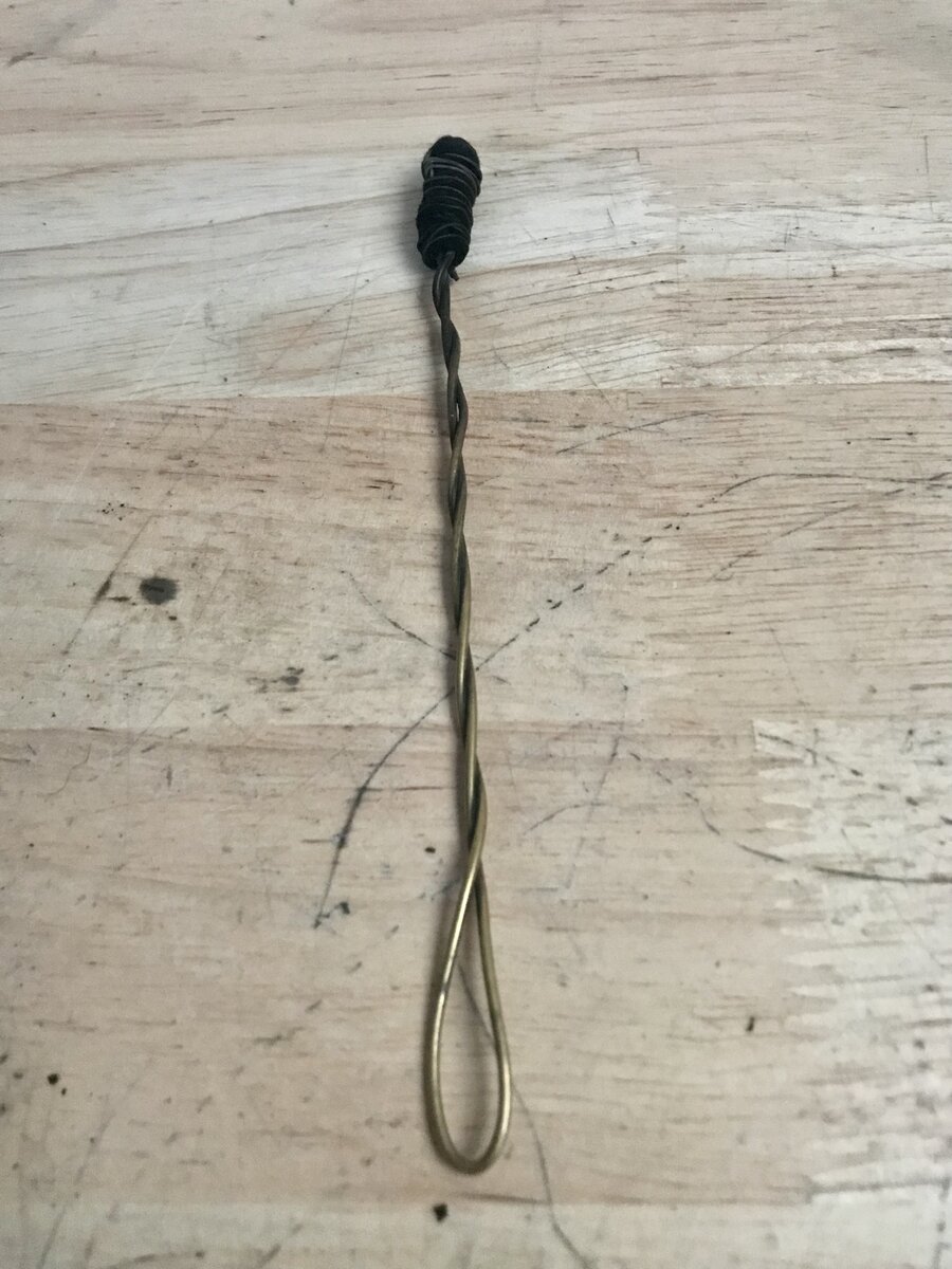

  18. Tony Press

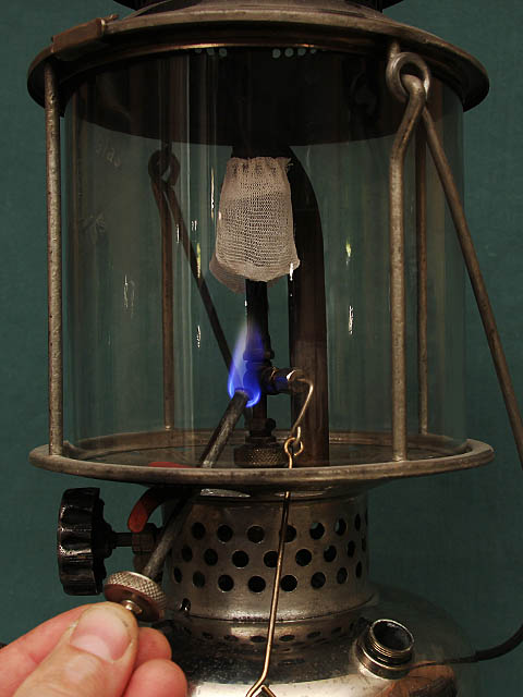

    Not quite as sophisticated as the @presscall torch, but I have a few of these of various sizes on hand for lighting lamps, lanterns and stoves.
    They are made from brass wire, with a carbon felt wick.
    They are very good, as is John’s torch, for lighting Coleman gasoline lamps and lanterns, because they hold enough metho to preheat the generator a bit, thus avoiding the “Coleman flare up”.

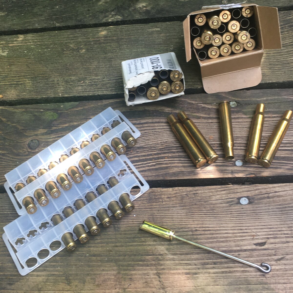

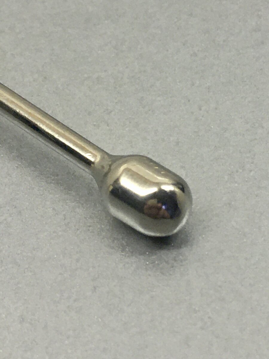

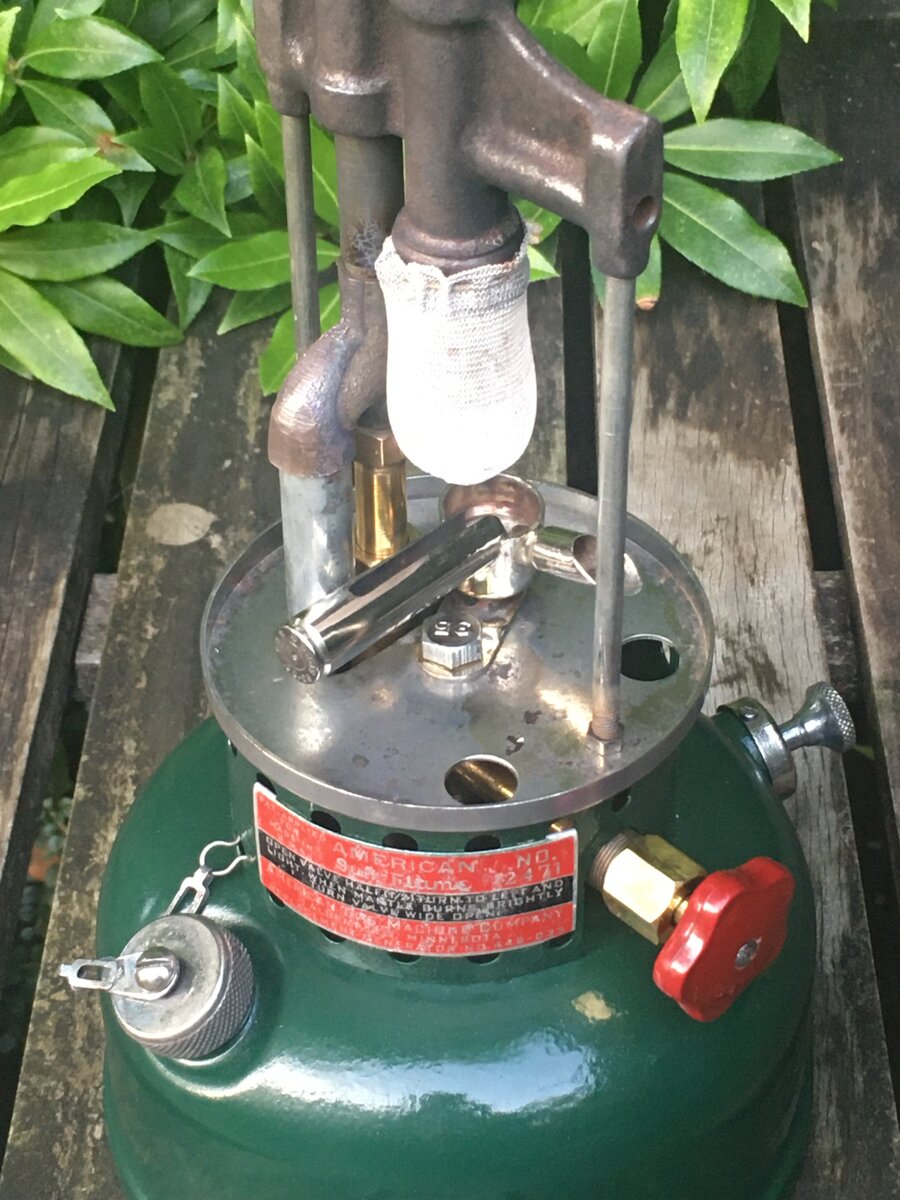

  20. presscall
    1,790
    Lancashire, UK

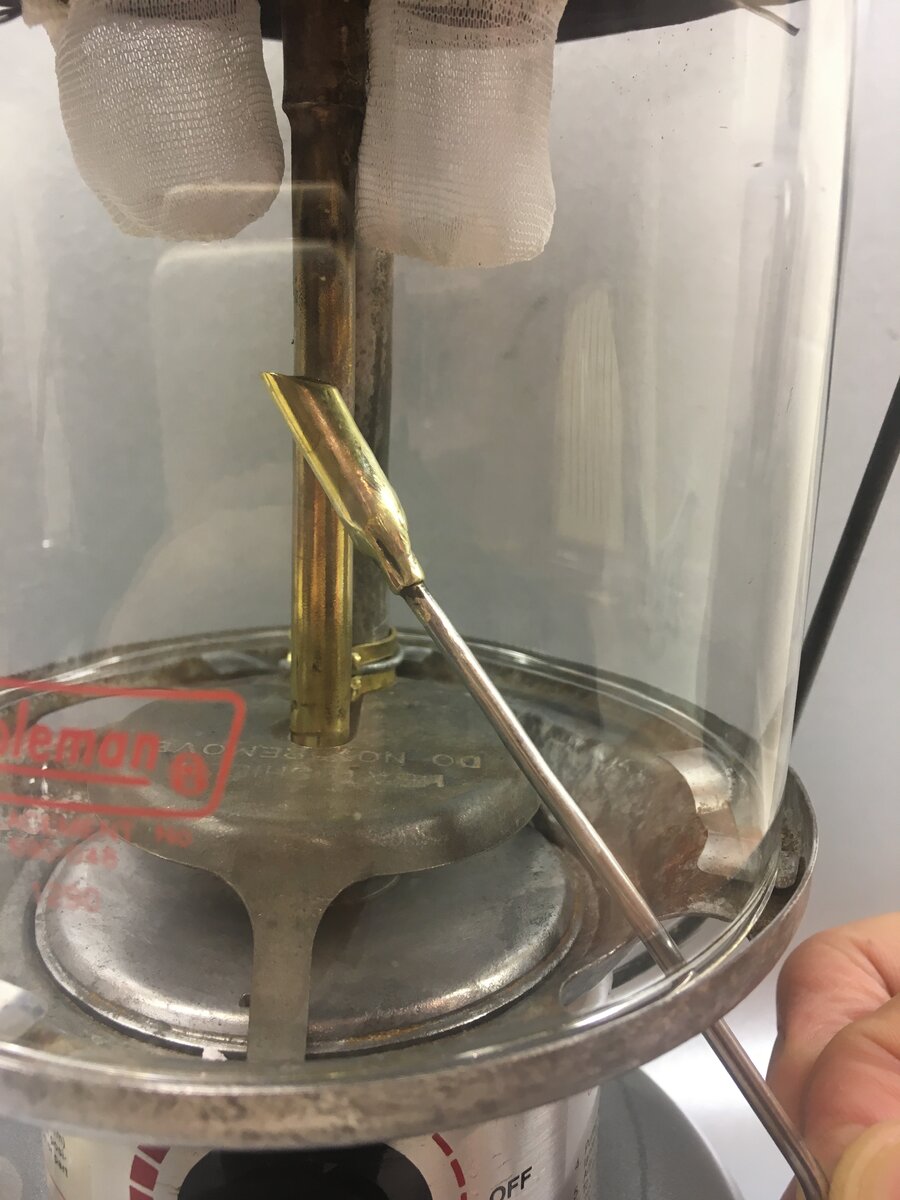

    When I said that I hadn’t taken into consideration the helpfulness and generosity of CPL members.
    A PM to me to ask if I could make use of some spent casings (yes!) and the next day a whole batch of various sizes arrived. Thanks @Fireexit1!
    First one off the production line’s gone to Firexit1 as a ‘thank you’, nickel plated as a refinement.
    Here’s the second one, also nickel plated.
    Instead of a loop end to the handle I’ve added a knob.
    Though the cartridge casing’s of larger diameter than the tubing I first used, there’s still plenty of clearance for it to pass through the base plate hole of this Coleman 290A.

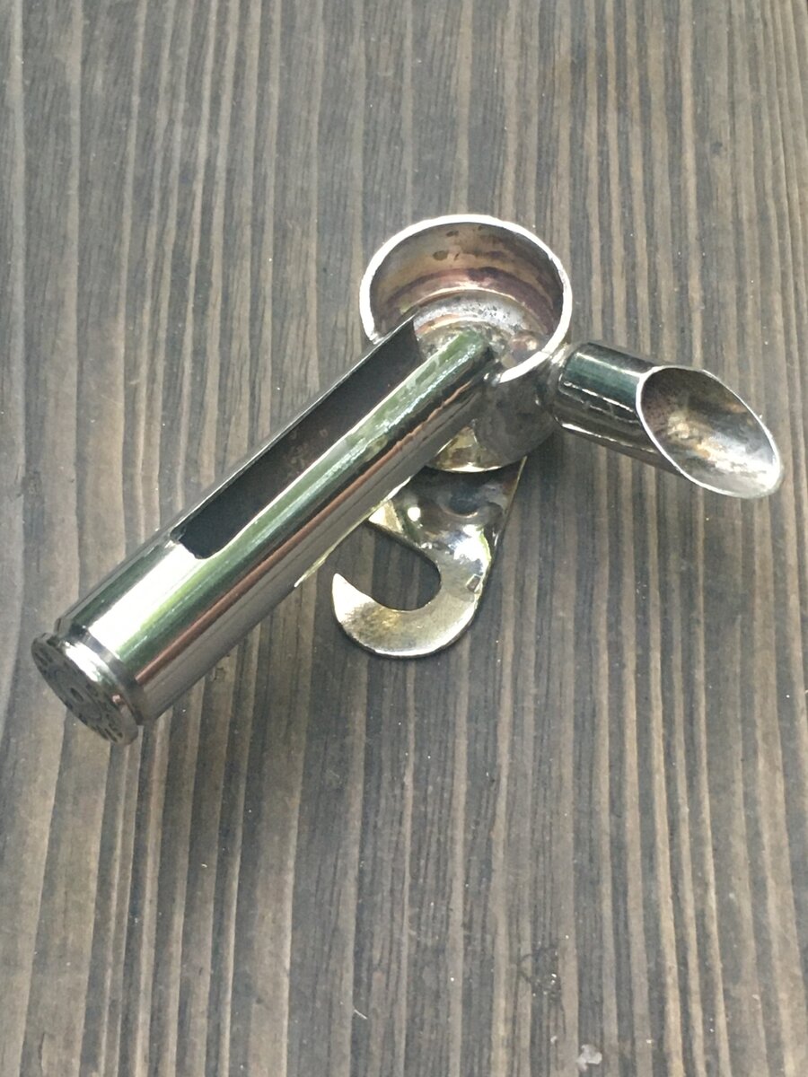

  27. presscall
    1,790
    Lancashire, UK

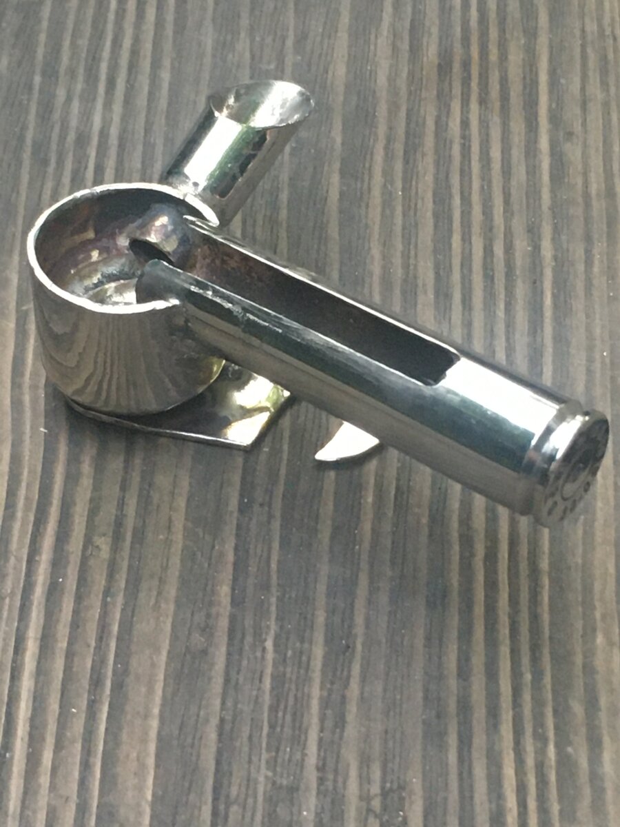

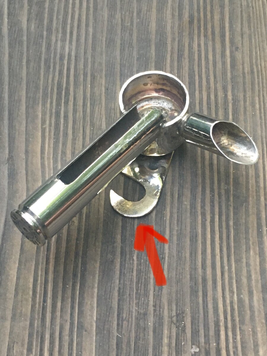

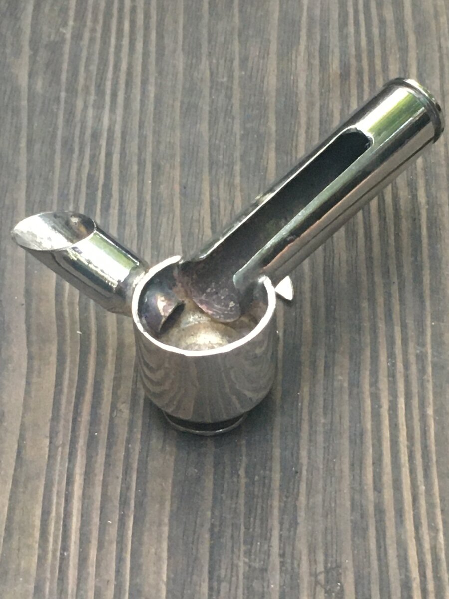

    Another ‘ammo’ project, a spirit pre-heater cup for THIS AGM Sun Flame lantern, which has a crude fuel ‘choke’ for start-up, resulting in flaring and sputtering until the substantial amount of metal in the burner and generator components reaches vapourisation temperature.
    Designed for ample capacity and ‘spread’ of priming flame. Nickel plated after polishing.
  28. Paul Burnell
    Paul Burnell Ireland Subscriber
    May 12, 2023
    176
    Ireland
    Is that a bit of an old bike on the bottom of the bowl....
    This is fettling in God mode :content:

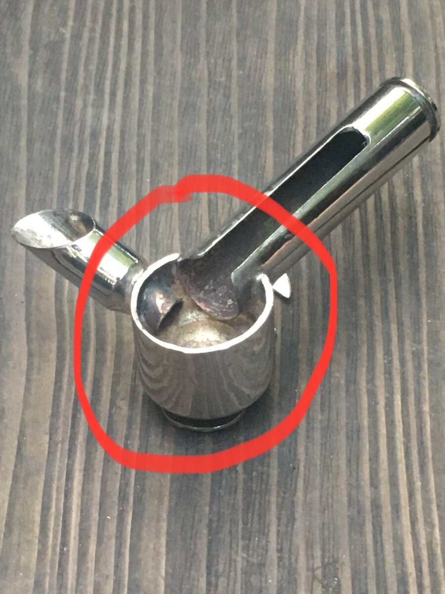

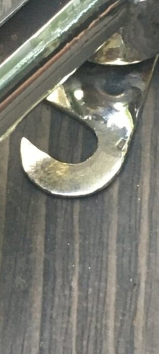

  29. presscall
    1,790
    Lancashire, UK
    You mean the part I’ve circled presumably. It’s the (rounded) non-return valve end of a stove pump of unknown provenance, found in a batch of damaged, discarded parts I acquired.

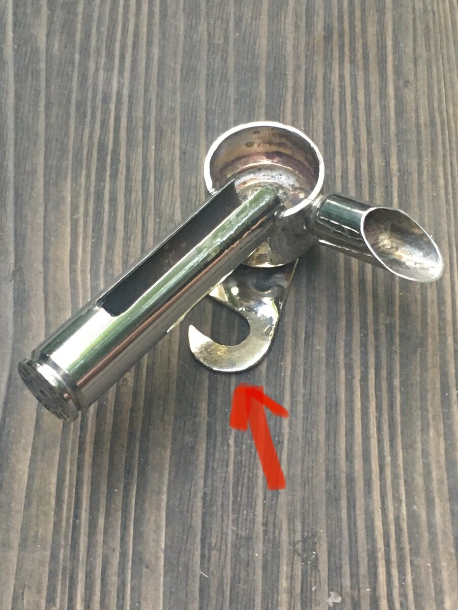

    On re-reading your question, I think you mean this …
    I cut it out of strip brass to mount the spirit cup on the lantern base plate simply by slipping the ‘hook’ bit under the base plate fixing screw. It makes it possible to easily remove the spirit cup for authenticity’s sake, should whoever ends up with the AGM after me want that.
  30. Paul Burnell
    May 12, 2023
    176
    Ireland
    Nope...this bit looks like the rear axle holder on a bike... Screenshot_20230911_191942_Gallery.jpg
    A very impressive bit of engineering all the same.
