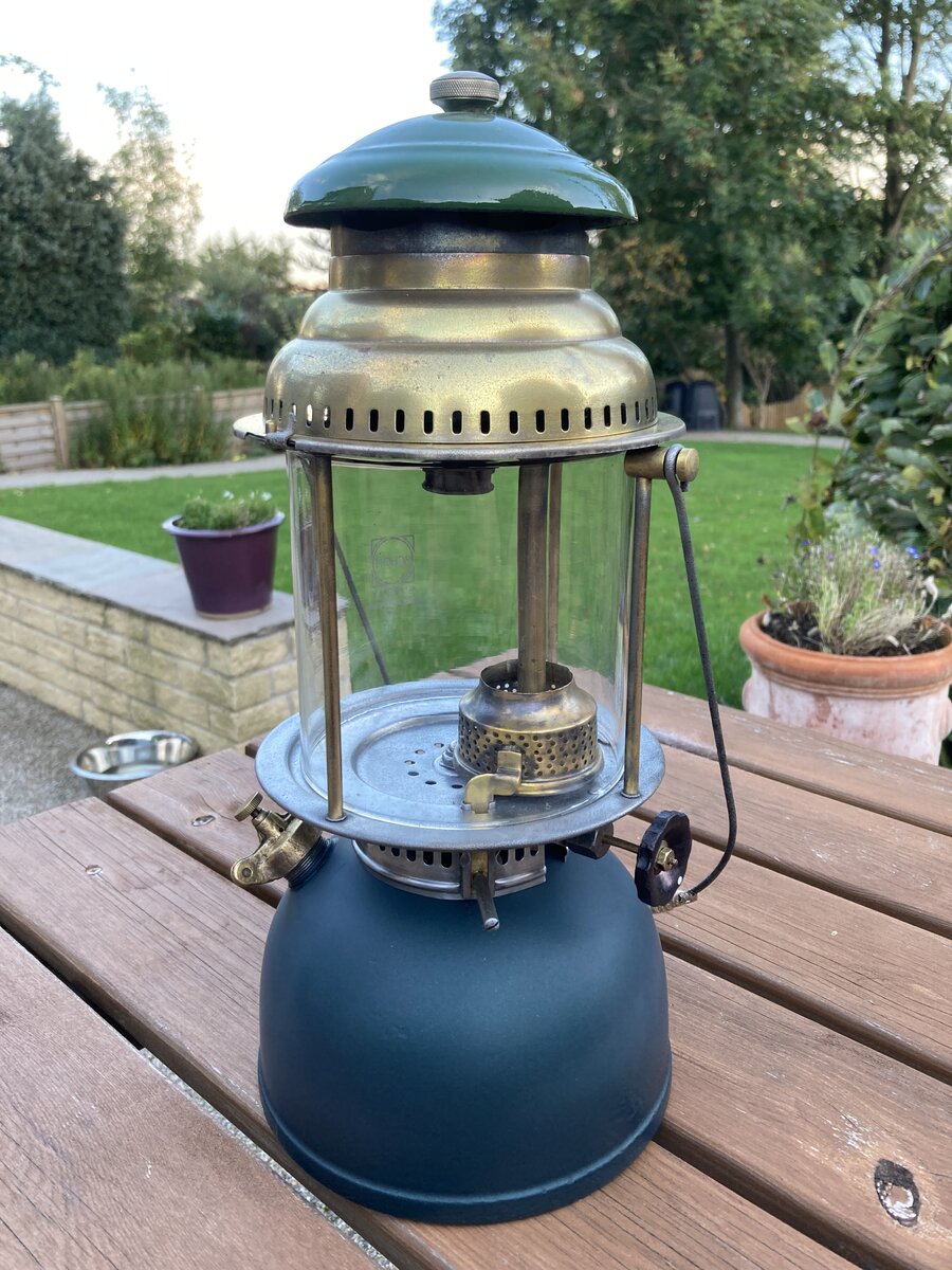

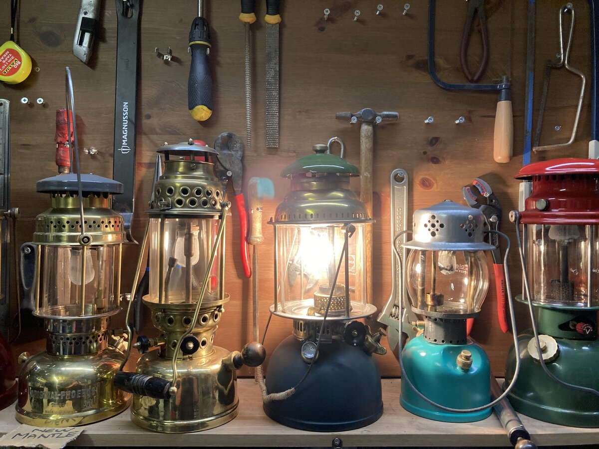

    It’s finally finished, what a saga.

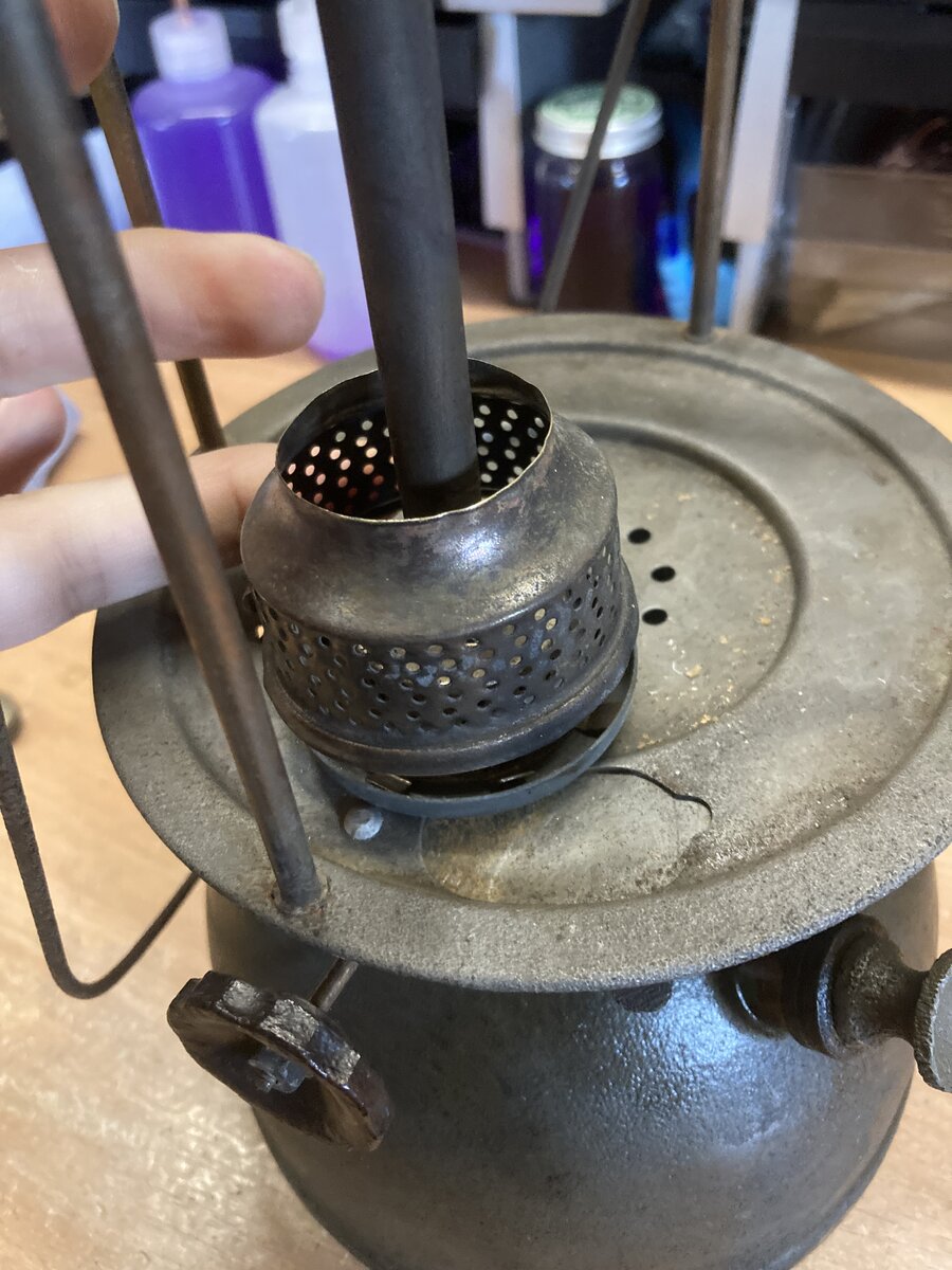

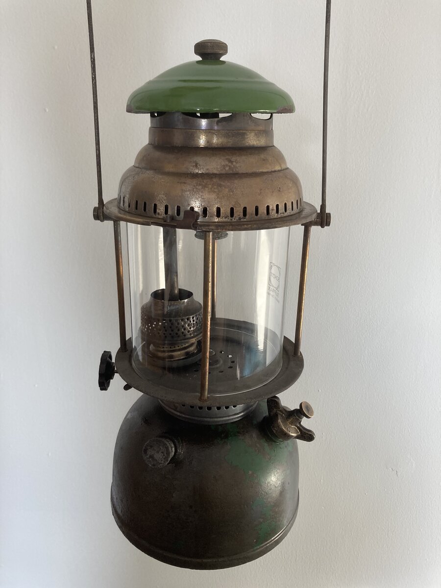

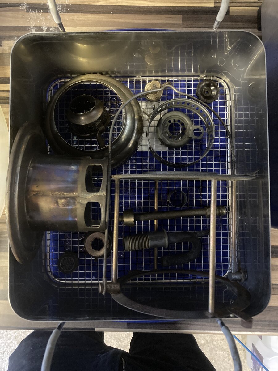

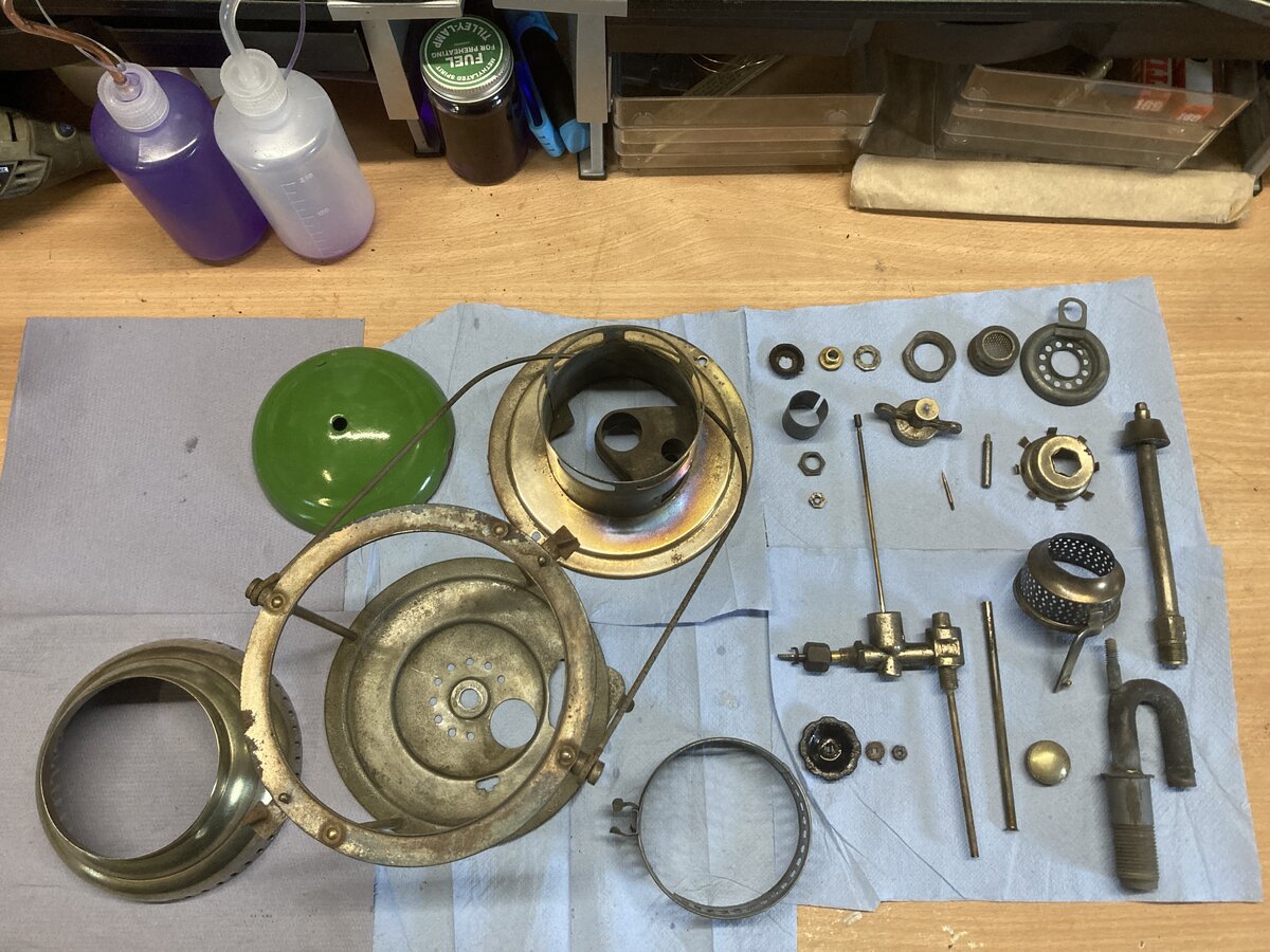

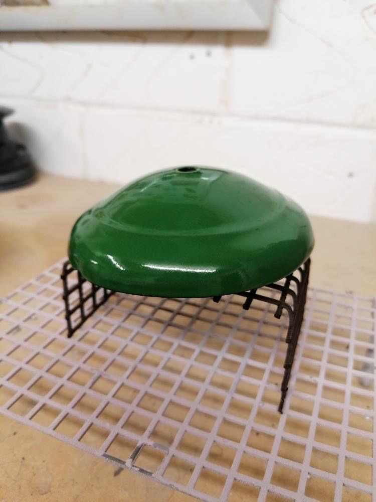

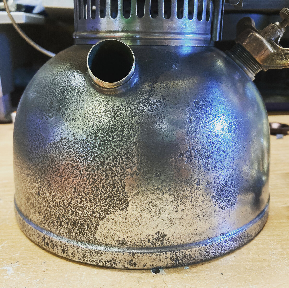

    Bought at the back end of last year it’s been a long process to get it here. I had to repair a snapped cleaning needle with a copper electrical crimping ferrule which worked well. Then I had the hood re-enamelled, cleaned it, painted the steel fount and reassembled but then had fuel supply problems. Got it lit on an 80/20 blended fuel but only if I kept pumping it. Then it wouldn’t light again. Eventually narrowed it down to a fuel pickup blockage which after I unsoldered it from the valve (Good advice again from @Henry Plews ) and realising it was also threaded and screwed into the valve also I found what looked like a very clogged roll of copper mesh. If these had a filter in at the time of production, it was well past it’s best or perhaps a diy effort. I had to drill it out of the tube. Resoldered it back in place and reassembled and away she goes on pure paraffin. A long restoration but pleased with the end result.
    Thanks again to @Tilleyz13 for the enamelling.

    The fount came out well but I nearly wrecked it. I hadn’t paid enough attention to the paint I bought and it was a metallic British racing green. It looked ridiculous all glittery with the metallic. So I switched from the planned gloss lacquer to a Matt xht lacquer which dulled it and it came out really well.
