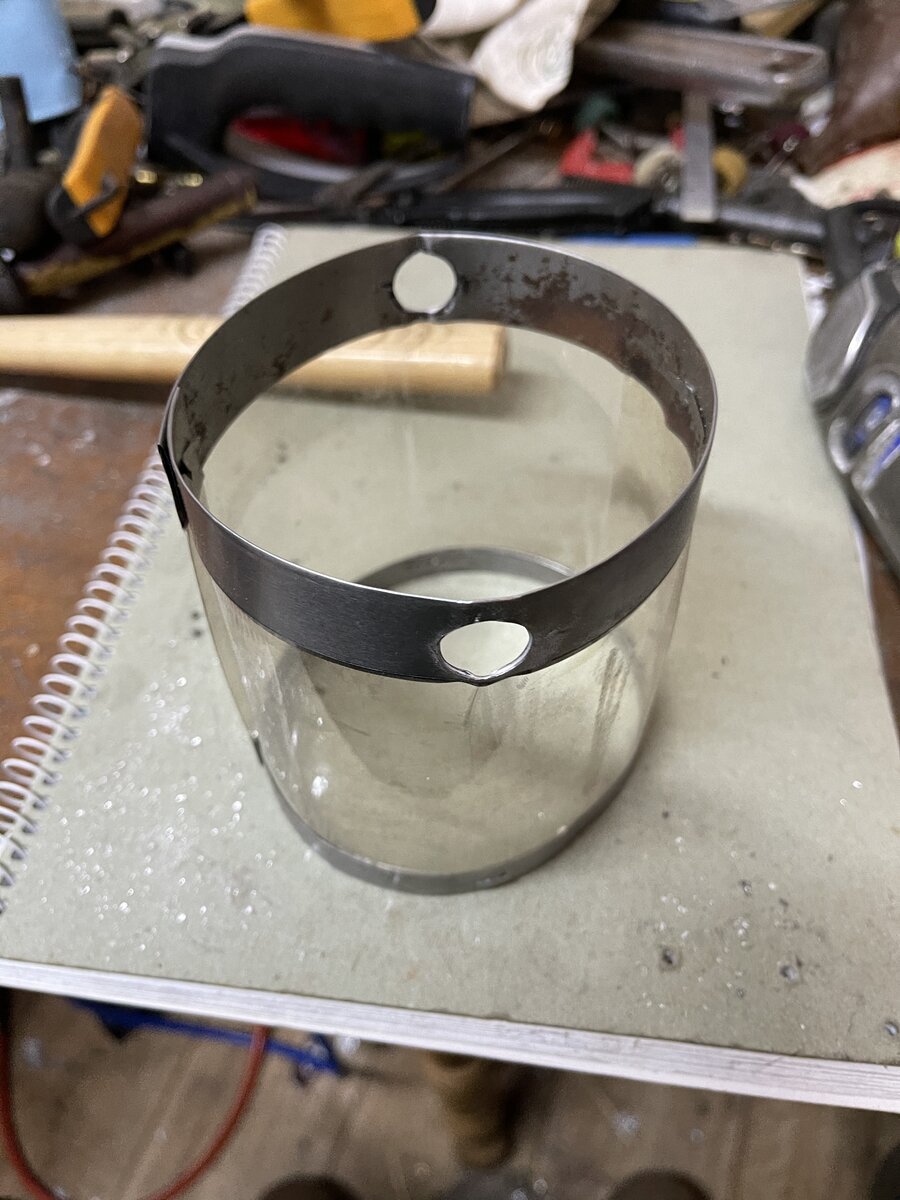

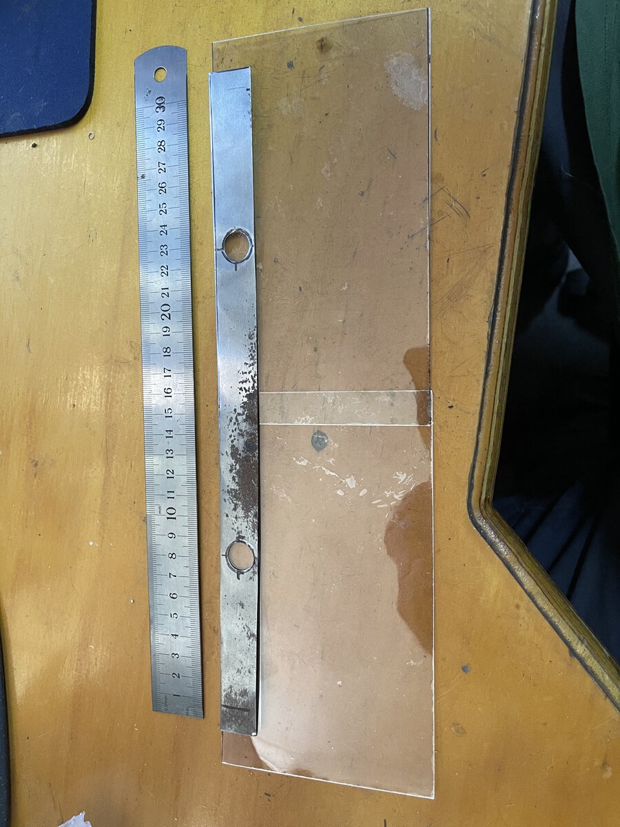

    Hi fellas I’m sharing my mica globe I made for my Tilley AL15.
    Based on the diameter of the 182 Tilley globe.
    I cut strips of metal shim to size of the circumference of the globe 310mm long the mica was cut down to 100mm.
    764E2260-3DEF-4906-9183-E18036050F58.jpeg 422E08C6-FD9D-4B55-8F0A-BAF6DBDFAC9B.jpeg
    I marked out where the air tube are to go and spacing for joining. I have made a basic sheet metal bender I folded my strips in halves.
    I basically put it together to see how it looks. I’m happy with it.

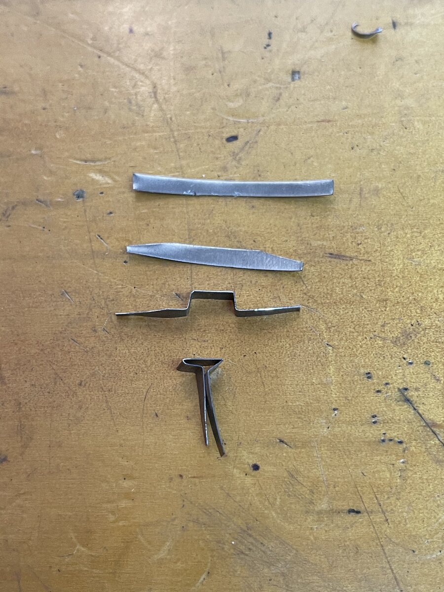

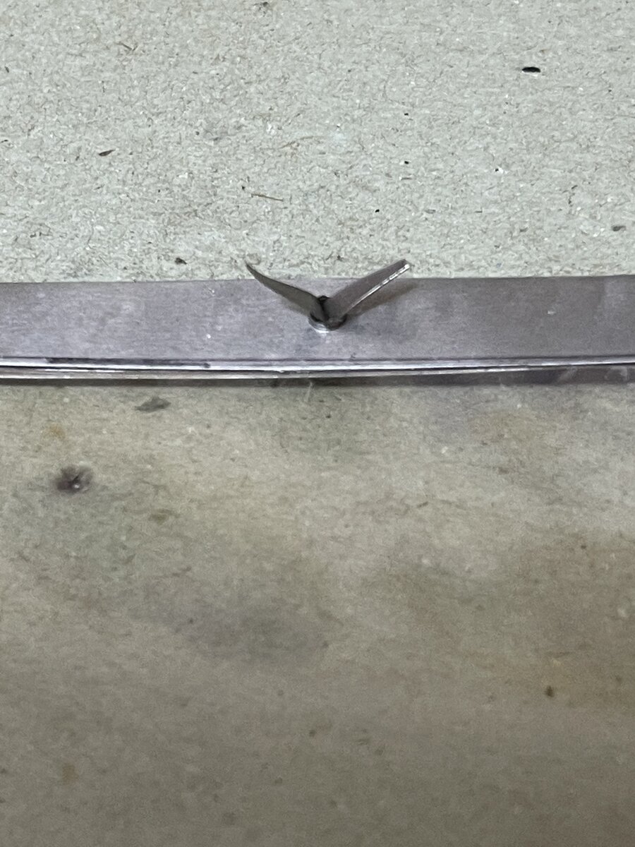

    I make my own split pins that work very well once secured and tapped flat.

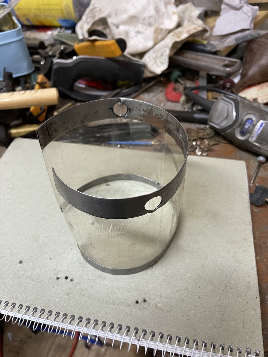

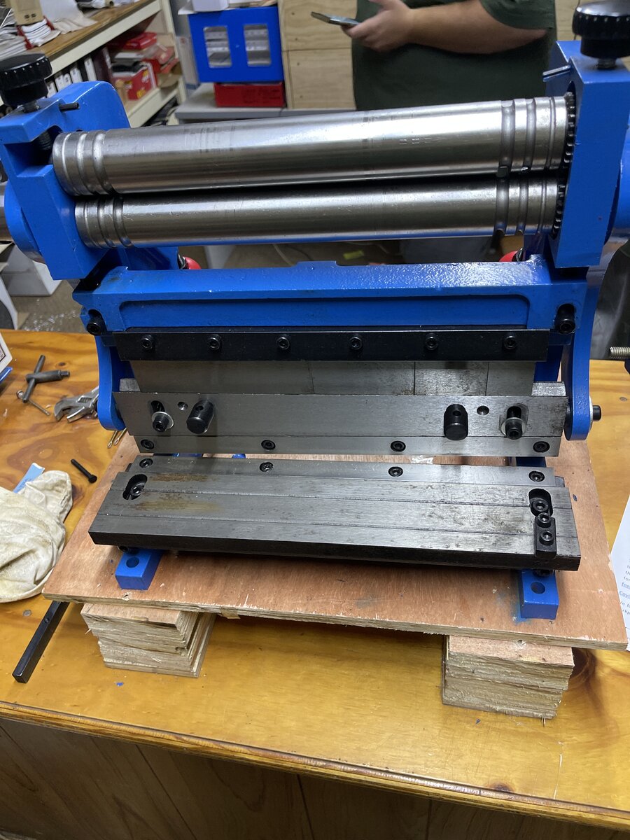

    I rolled the globe shape in a combination roller bender and cutter makes a better round globe.
    I used a hole punch to cut the bigger air tubes holes, pre drill split pin hole with 1.5mm drill.
    a bit of pre fitting

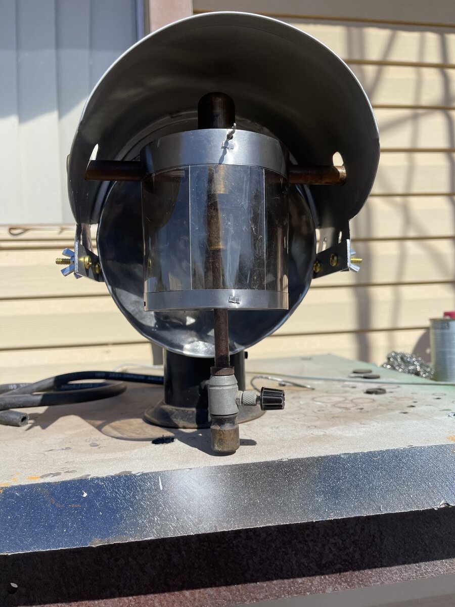

    And here is my finished globe,

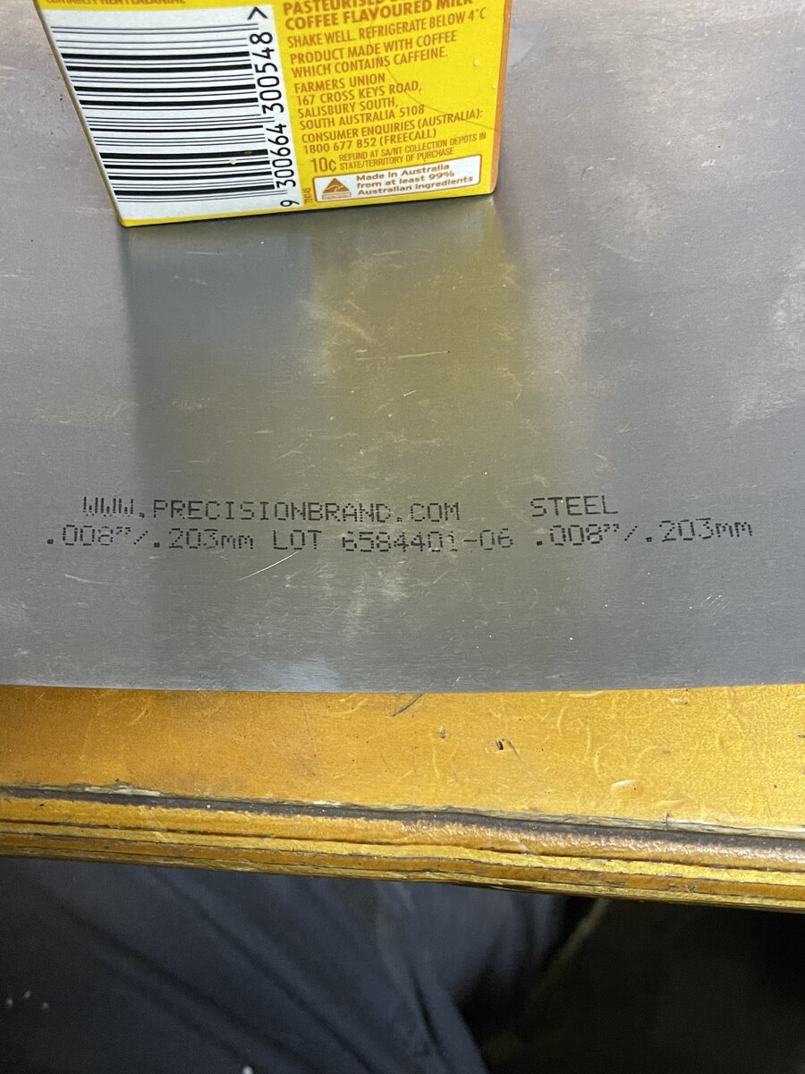

    If I may ask, what was the thickness of the metal shim you used?

    Would you be able to post a pic of the roller/cutter you mentioned at all, please? Sounds like a useful bit of kit?

    @Brenneman , hi there this is the steel shim I bought from eBay. 92765B8F-89F1-4EC2-BCF7-6CADE6376BCA.jpeg

    @podbros , this is the roller bender guillotine
