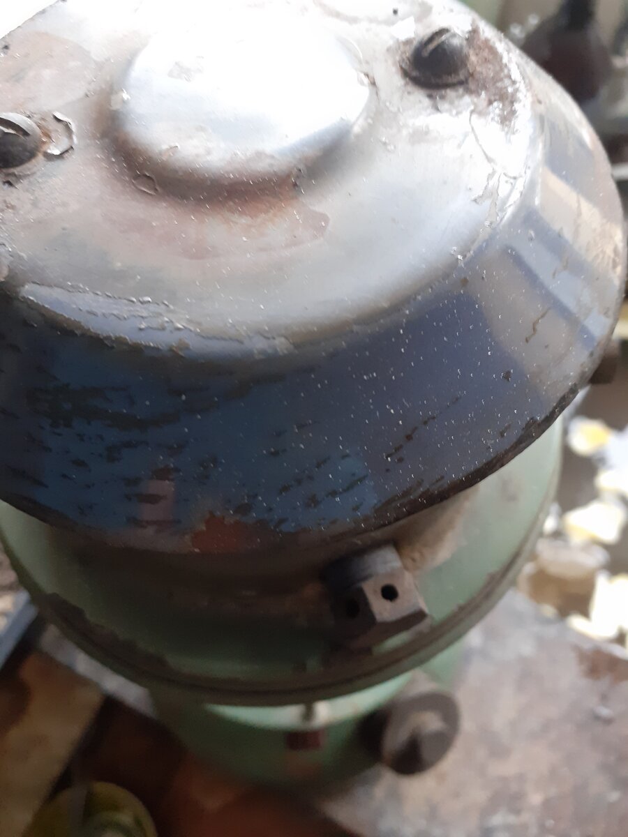

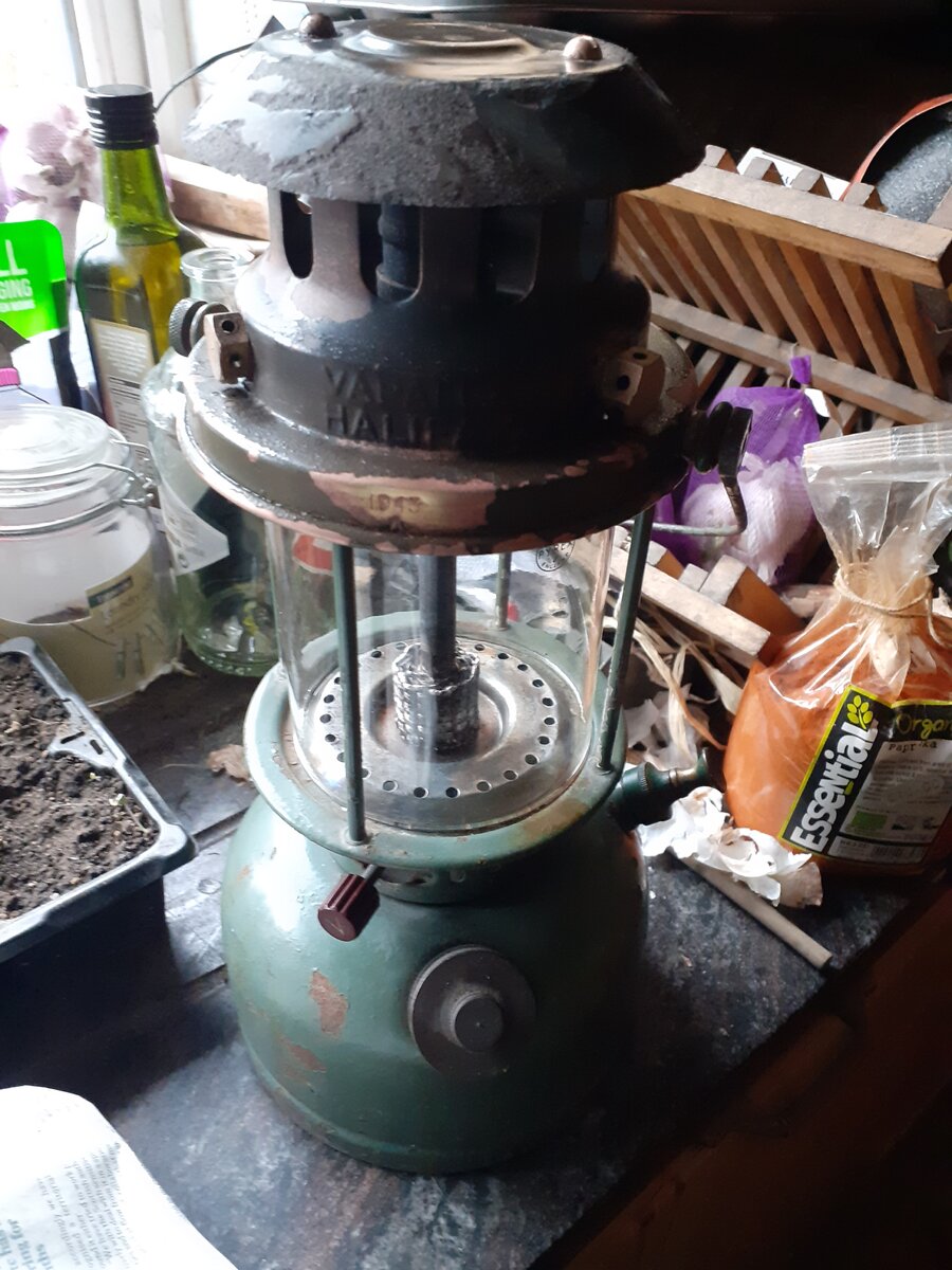

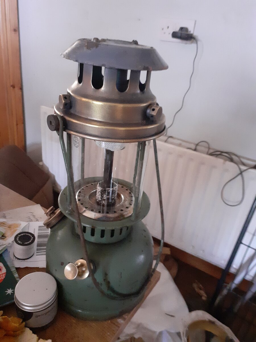

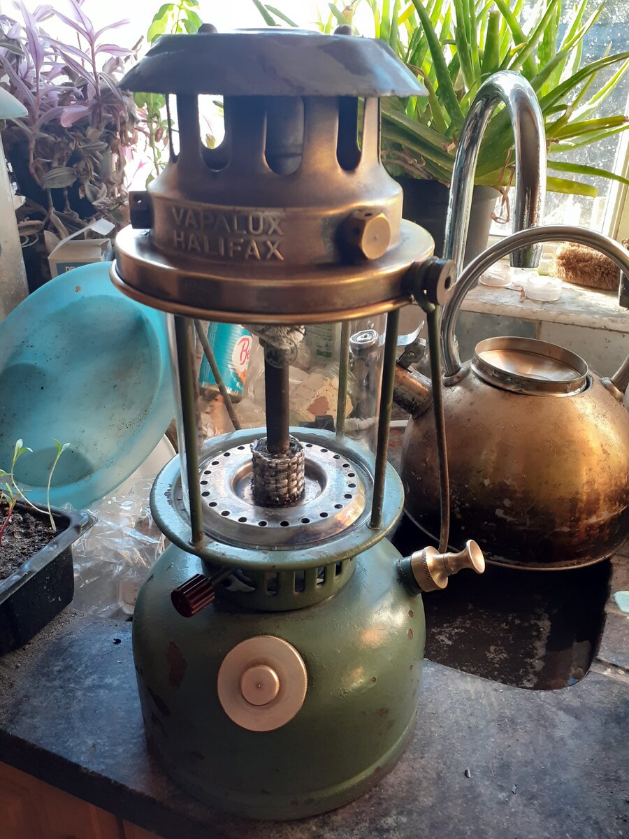

    Hello everyone,
    I bought this lantern on ebay a few weeks ago.
    I removed the green paint from the brass parts that somebody painted on and changed the washers in the fuel cap and air release screw so far.
    I must change the washers now in the control cock and vapouriser/control cock/ tank connections too as I had a leak last night.
    Here are some photos of before and after.
    Thanks to all for your help and support and kindness.
    I am trying to get the original globe with a hole and the original brass spirit cup.
    Have a lovely weekend,
    Thank you all very much for your support,generosity,help and welcome.
    20210213_094325.jpg 20210213_124517.jpg 20210214_102645.jpg 20210213_093558.jpg 20210222_084908.jpg 20210226_154742.jpg

    Hi Fiona, how you cleaned it up? It looks nice...

    Hello Fiona, I do notice an original Pyrex glass on this lamp. I believe many Vapalux 300's were delivered with the multi-slotted waist as on your lamp but with the new glass without a hole.
    In other words, this combination could very well be as you lamp was delivered. The speculum plated dish-like preheater is not standard, but should give excellent service in combination with the 'new' glass.
    With all the major parts so readilly interchanged, is the tank made of steel or is it brass?
    Regards, Mike

    Thank you.I am not sure if the tank is brass or steel.
    It is a beautiful lamp but not bright enough for my kitchen.
    I am using my Petromax and a Bialaddin lamp at the moment.

    For the tank, a simple magnet (like those thingsies on a fridge' door) should tell you whether the tank is made from steel or brass.
    The difference in brightness between the Vapa and Bia seems not a pressing concern, but they should perform equally with same fuel and mantle. There is a possible difference in performance between the two vapourisers, but again, perhaps only an academic point. For an inside lamp I find pressure lamps usually too bright (and too noisy) considering ventilation requirements are met.

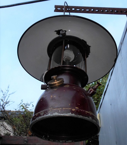

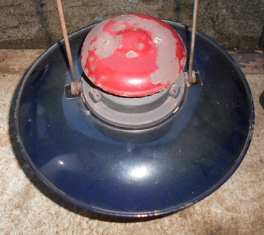

  18. Henry Plews
    3,033
    Reflectors just slide down over the handle and rest on the hood and as well as reflecting the light downwards, they greatly reduce the shadow underneath the lantern but because different manufacturers used different diameter hoods, they are usually lantern specific, a Vapalux / Bialaddin shade will fit all models of Vapalux / Bialaddin lanterns irrespective of the style of hood.
    The hole in a Tilley reflector is too big for a Vapalux lantern and although it will go on a Petromax, it doesn't sit right.
