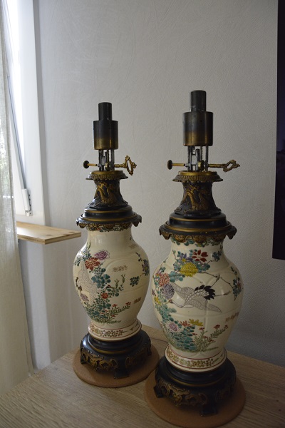

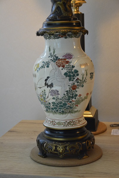

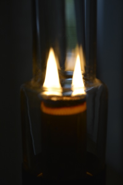

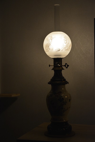

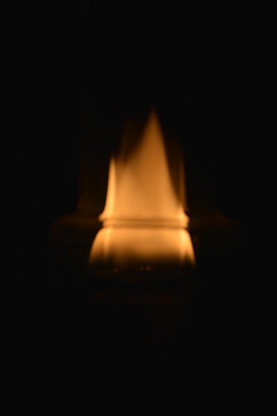

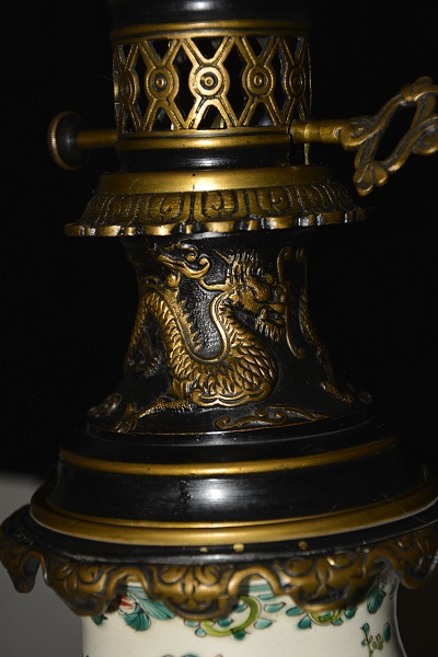

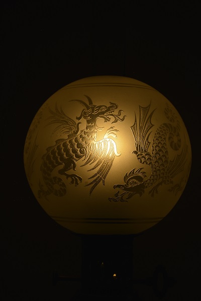

    Two years ago, I began restoring several pairs of oil lamps with moderators.

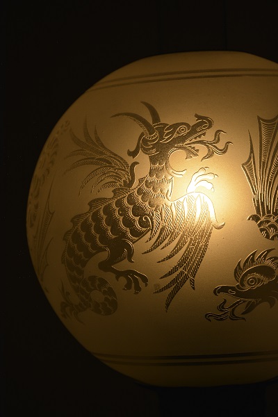

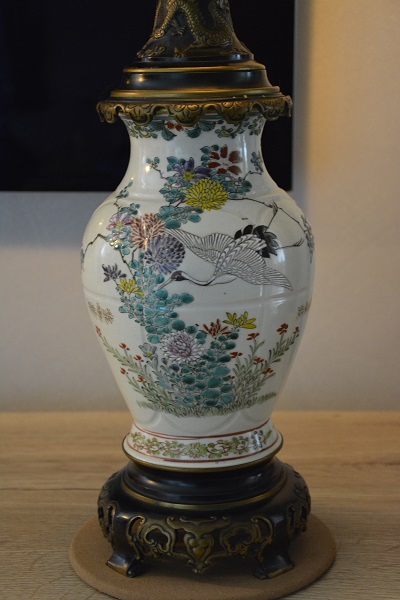

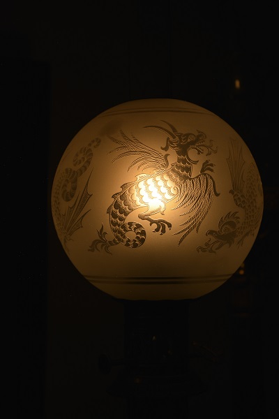

    This pair, with an Asian and dragon theme, was given to me by a friend.

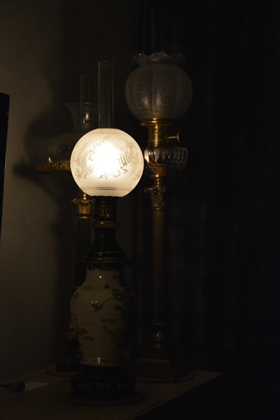

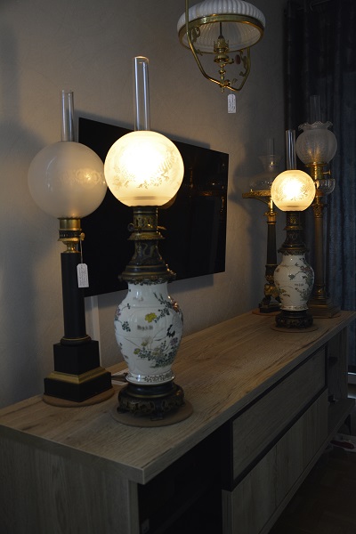

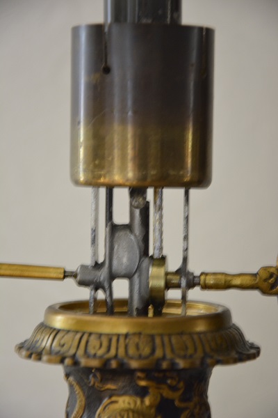

    They work by producing a light that I find quite bright; they require the piston to be raised approximately every sixty minutes for reservoirs of around 500 ml, and they work perfectly.

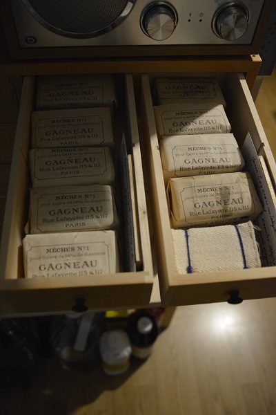

    They feature a 24 mm Argant burner compatible with Baccarat crystal chimneys measuring 48 mm at the base and 298 mm in length, fitted with period tubular cotton wicks for a 24 mm burner.
    I use them regularly and really appreciate the atmosphere they create.
    I use paraffin oil as fuel.

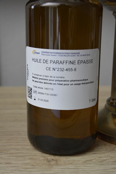

    To avoid any confusion regarding the names of fuels on the translator’s part, I’m attaching a photo of the oil I use for the Bernard Carcel lamp.
    It is a white paraffin derived from the distillation of petroleum.
    The one used for moderator lamps is identical, but has a lower density.
    I keep it in my garage and can’t be bothered to go out and take a photo of it there :roll:

    Stunning lamps Patrick, and a nice restoring job:clap::clap:

    I have two globes which are for moderator lamps, but a lamp has not turned up yet.
