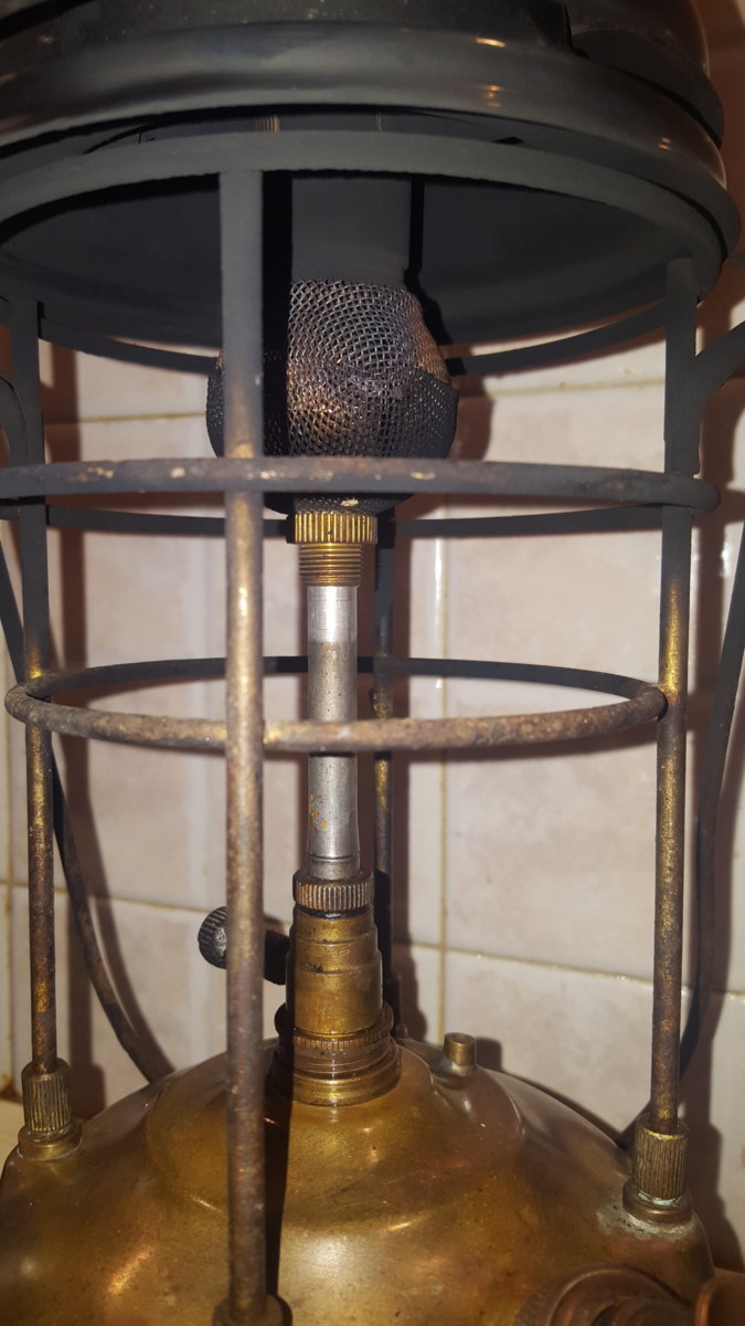

  4. thalassobiote
    Nov 2, 2017
    15
    @Henry Plews
    I like your solution. Looking at the additional spares used and overall pictures of the modified lamp I cannot see how these parts interact with the existing vapouriser. Can you explain?
    Is the kit suggested by @ROBBO55 going to be all I need for the modification?
    Thanks

  5. Henry Plews
    3,073
    @thalassobiote
    The kit suggested by Martin (@ROBBO55 ) is all you need. If you decide to buy one, you will find that you do not need grid part 1230.
    The wire mantle for a heater is bigger than a mantle for light and so it needs a longer tube to support it. It will slide over the vapouriser in the same way as on other Tilley lamps.
    All you need to do is take out the existing short mantle tube and screw in the longer tube which comes with the kit but don't forget to remove the burner grid first. Slide on the insulating tube and wire mantle, and then screw on the nut to hold them in place. It's as easy as that.
    Henry.
