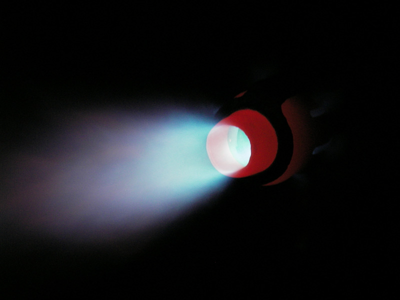

    @DarkDave Gasoline blowtorch in this example, but working as it should.

    Holy moly! That’s the kind of flame I’m after!

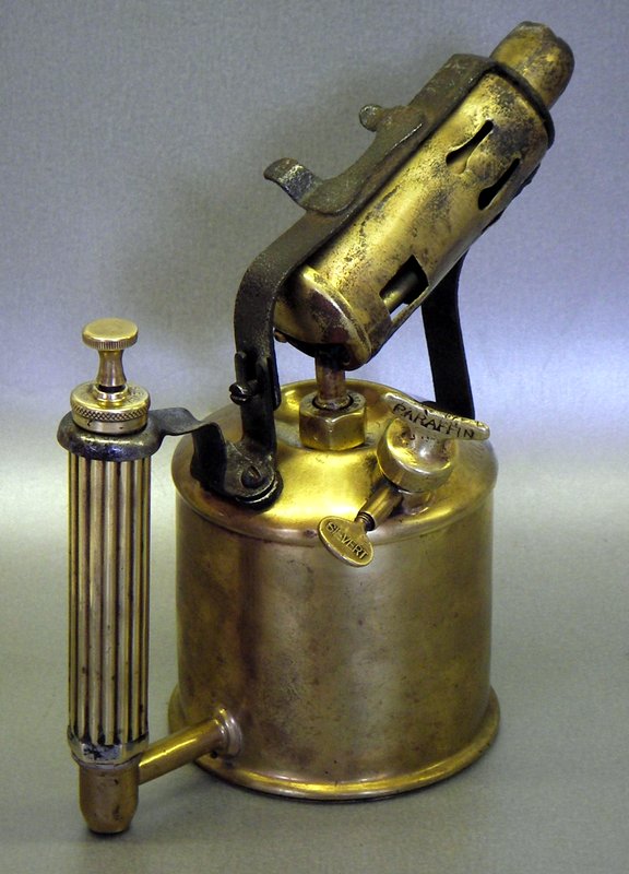

    Here’s a Sievert paraffin blowlamp with the same type of burner-to-tank joint as yours.

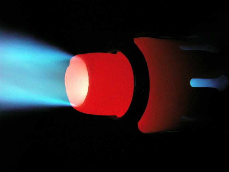

    Hi. Just wanted to thank you all for your helpful advice. I managed to get the tank pipe nut off, cleaned, and tightened. I’ve cleaned the jet several times, and although it kept gumming up again it’s working well at the moment.
    The torch now looks like this - a glowing red shroud (which you can’t see in the video) and a good flame. I’d just like it to be longer and more blue, but it’s progress!!
