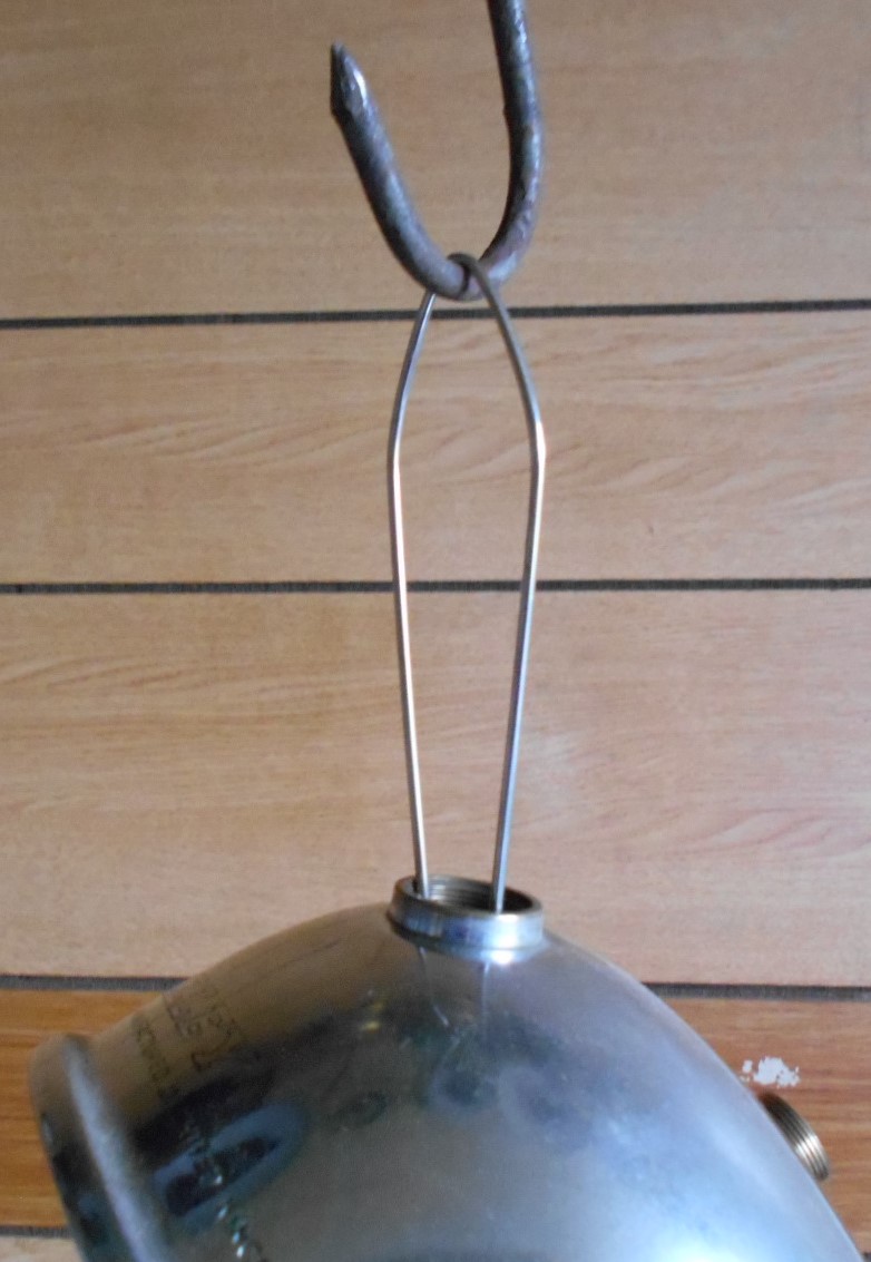

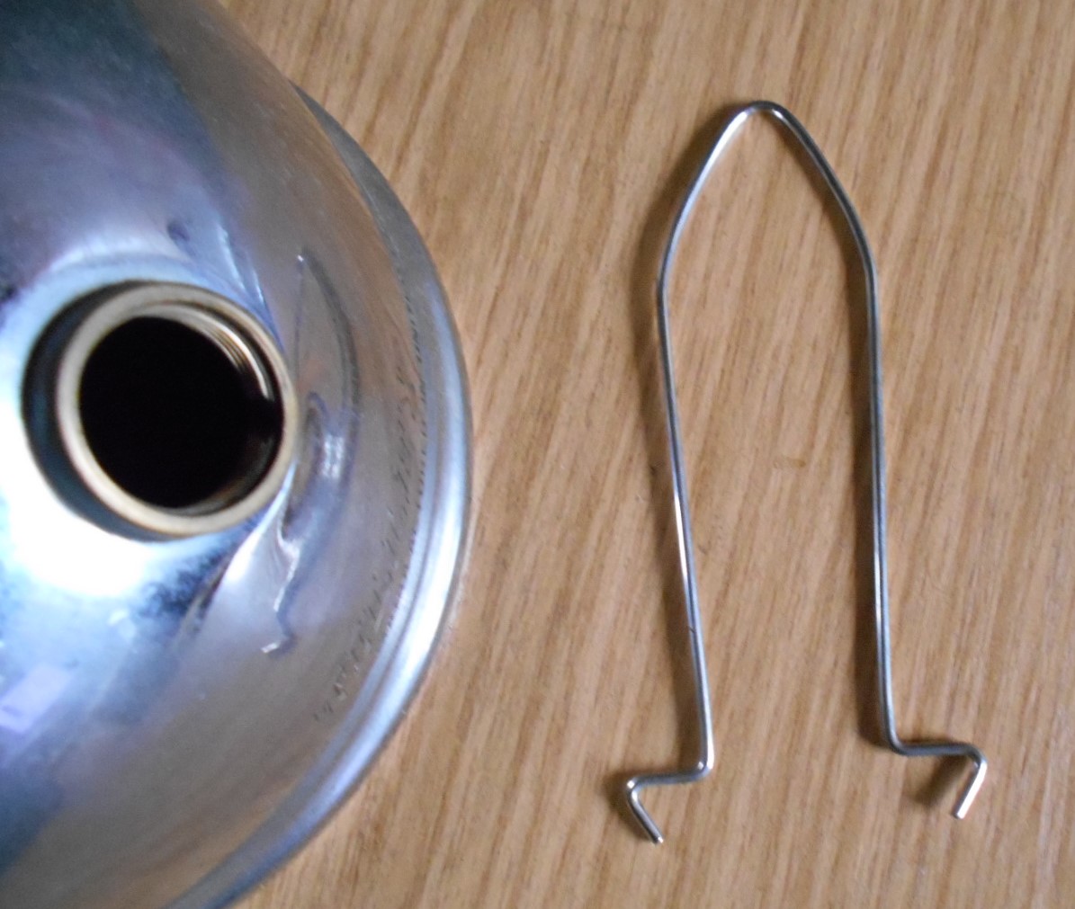

    The pump collar is flanged and is put in from the inside before the base plate is fixed in. Often, after cleaning and perhaps the addition of a little liquid flux, simply heating to the point at which the existing solder flows will re-seal the joint but adding a little more solder as suggested by Tony is recommended. Suspend the tank by the collar to keep the joint as tight as possible.

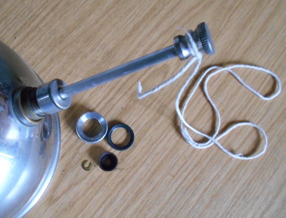

    No wire ? After removing the rubber seal and pump leather, tie a piece of string / shoelace around the pump knob.
