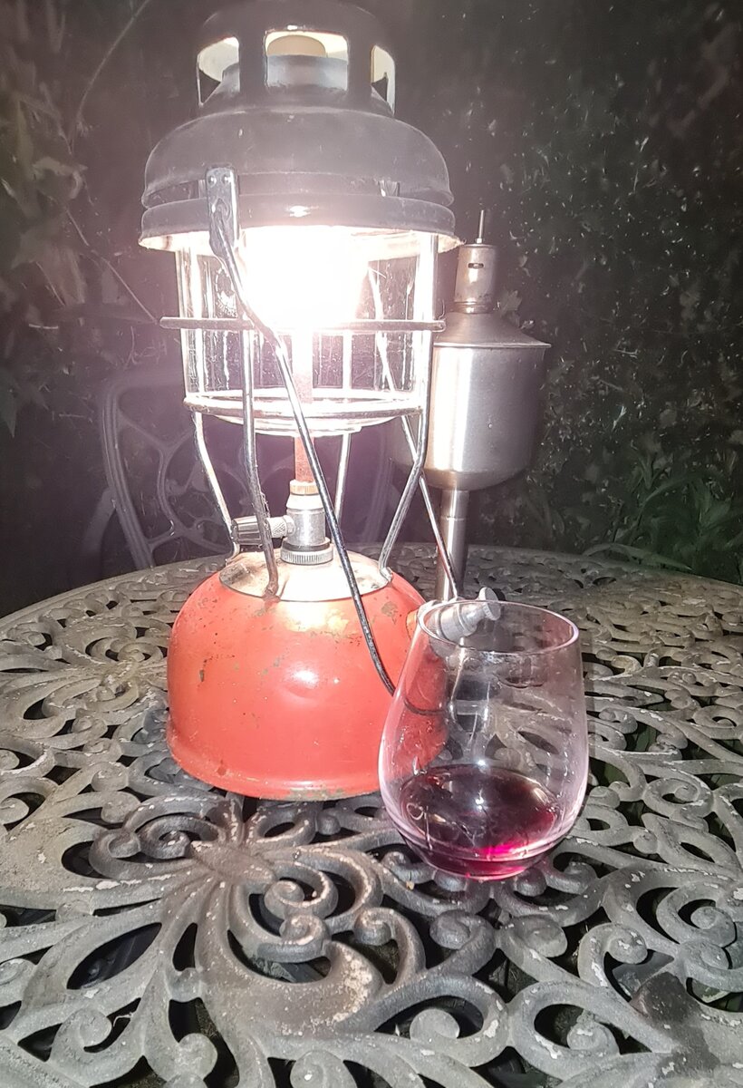

  18. JonD
    JonD Subscriber
    Apr 15, 2014
    1,012
    Hertfordshire, England
