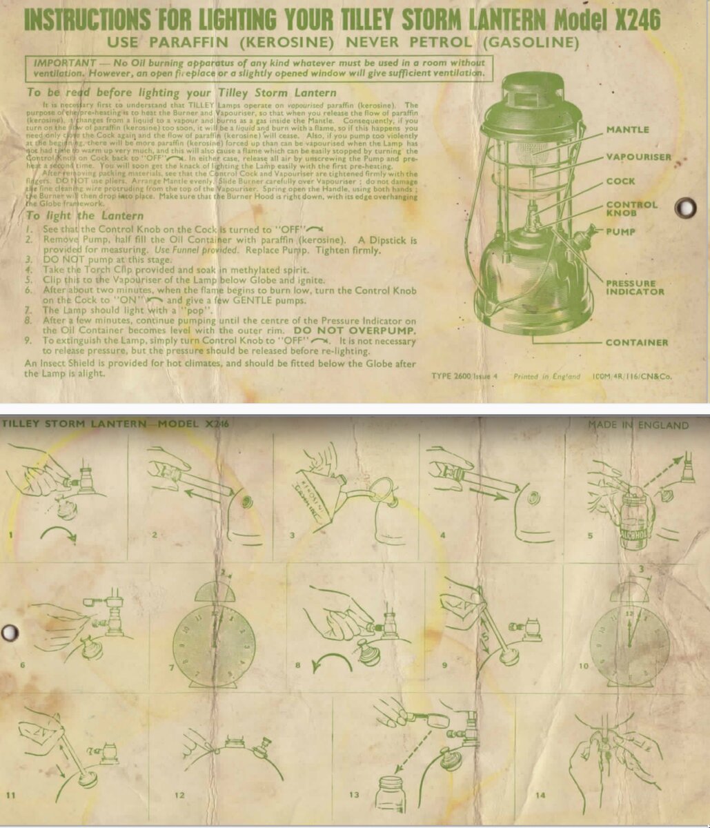

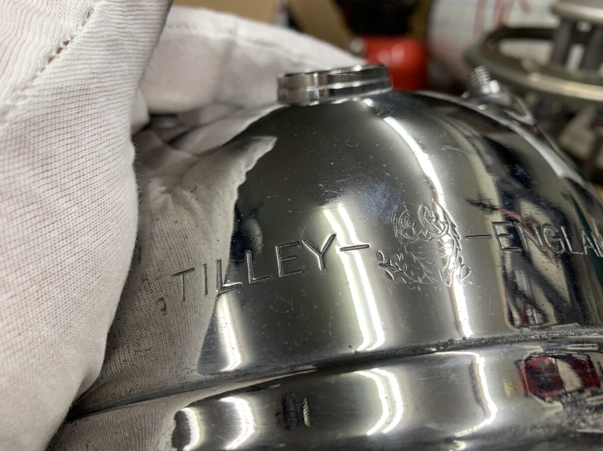

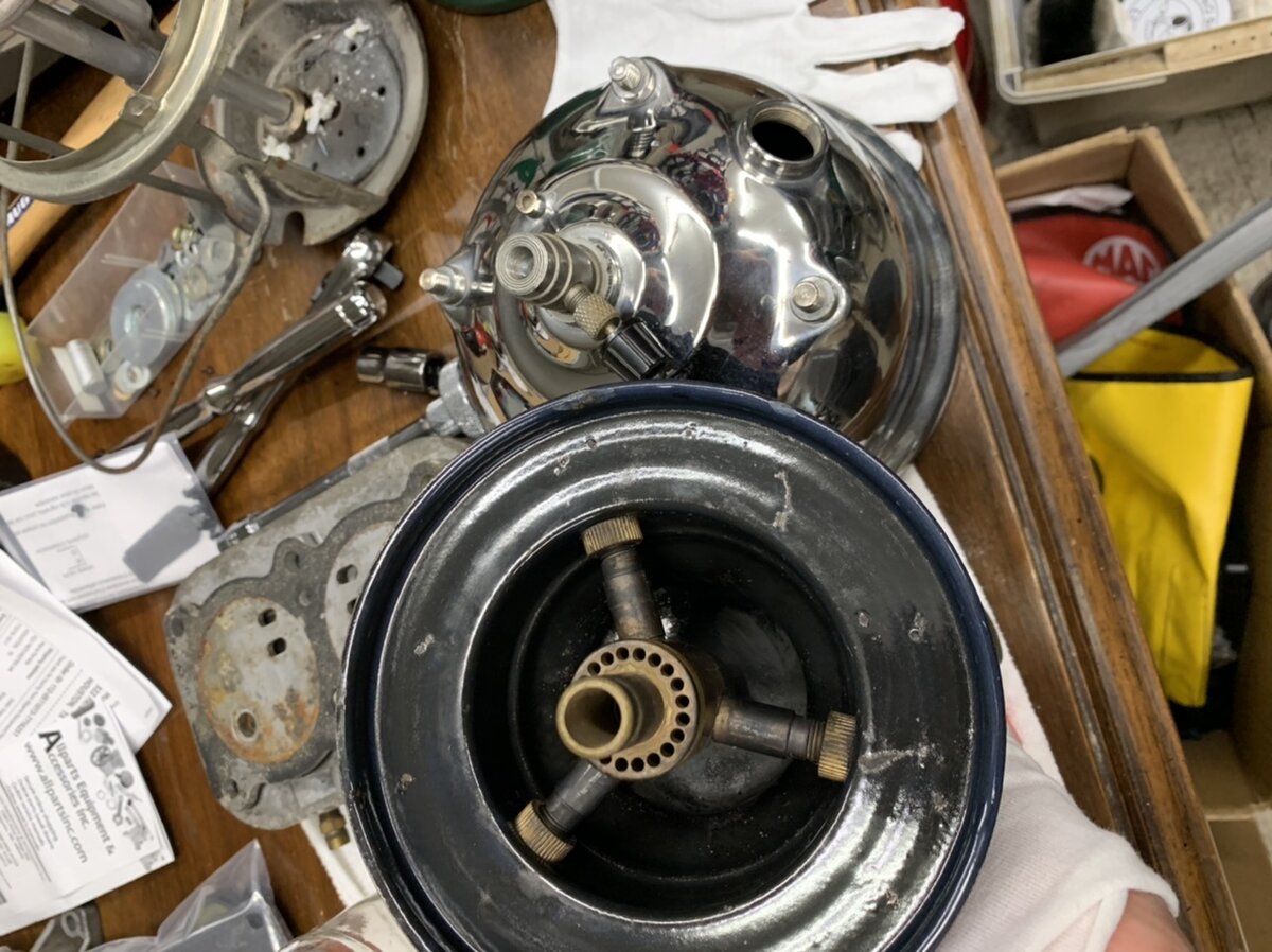

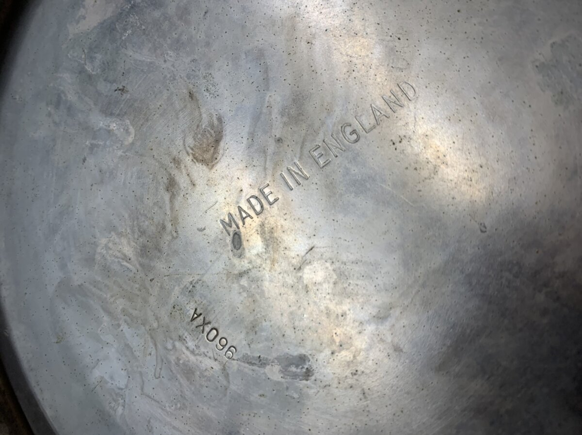

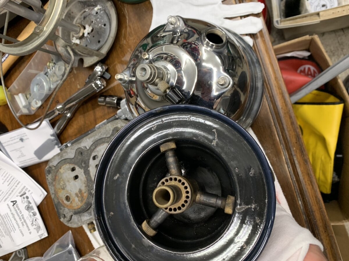

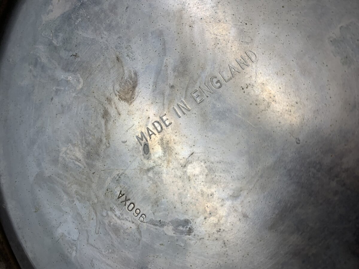

    I just got my first Tilley today. I believe it is an X246 from the 50’s but not really sure.
    Can anyone help me to date it?
    At this point I’m just cleaning it up. But want to move toward firing. What do I need to know and check?

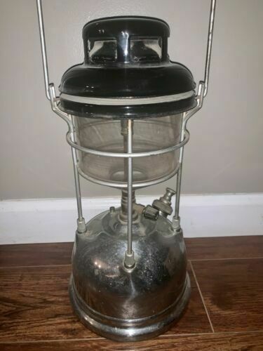

    Sept 1960....

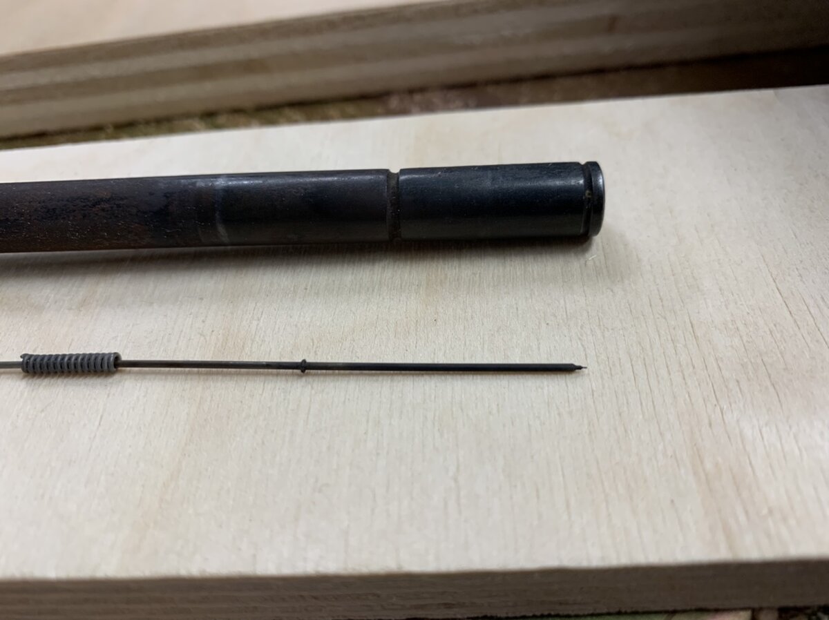

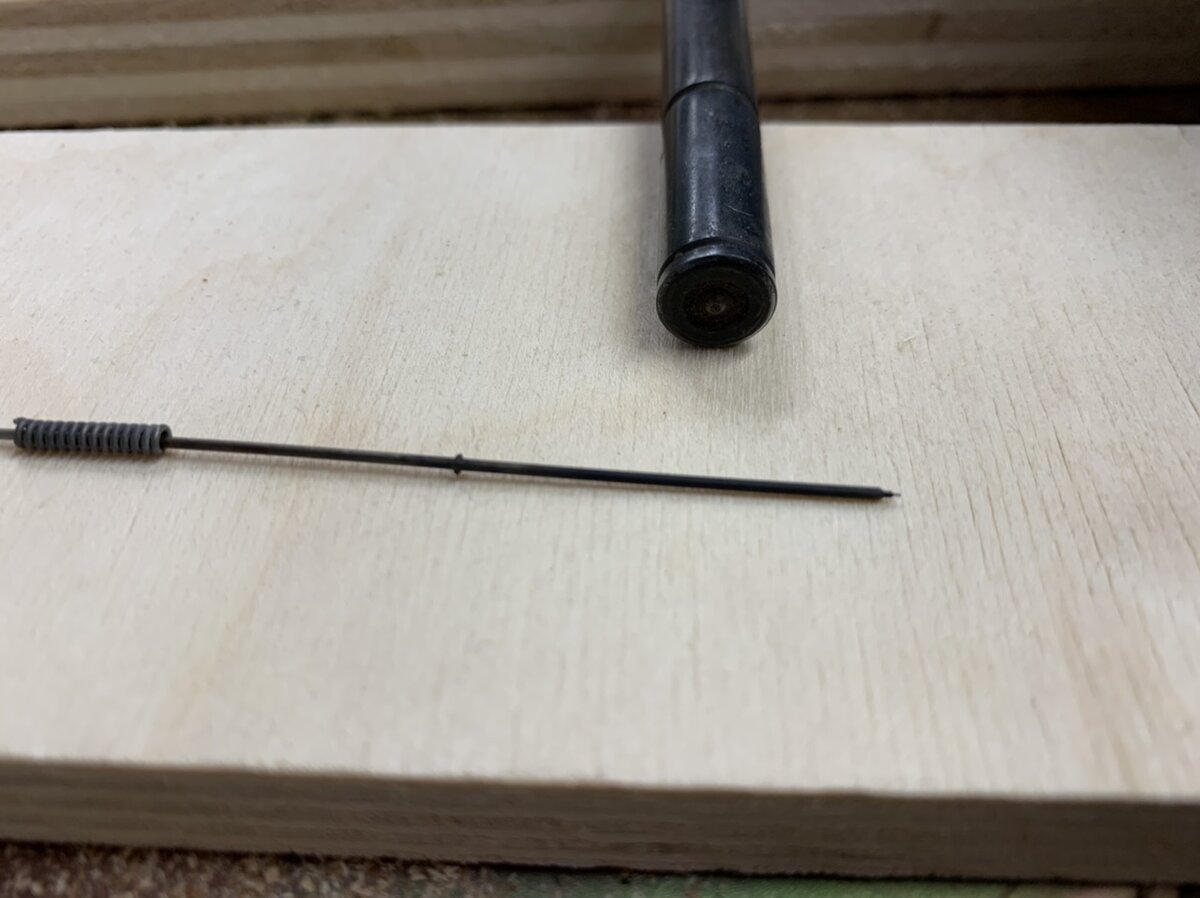

    What do you think about the generator?

    The pricker wire isn't broken.
    Tyler, The lantern looks in good condition and should clean up nicely. Have a watch of Broadlander (a member here)

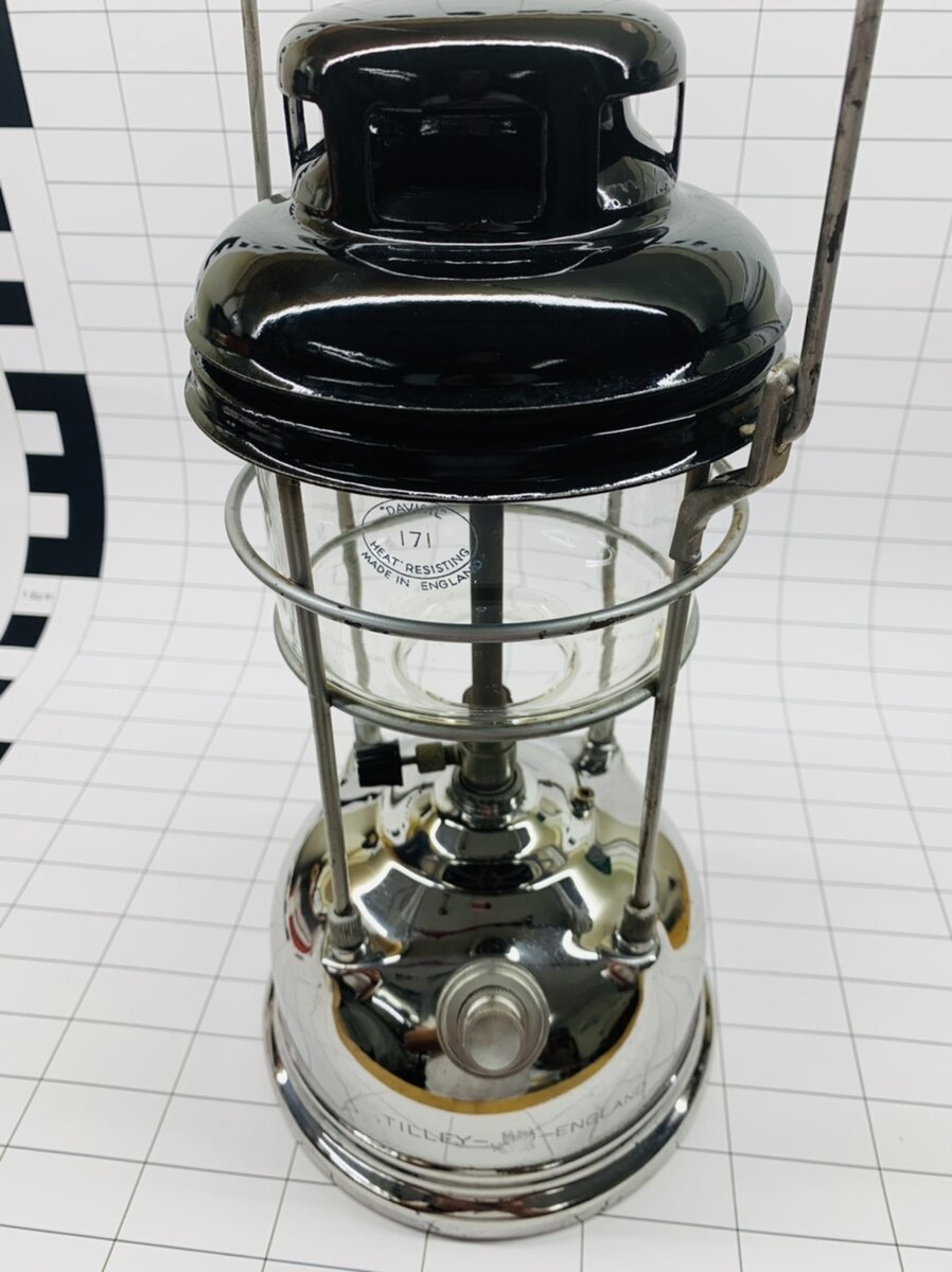

    C3CAC8DC-F06F-4C71-8809-AFA74D573841.jpeg Did a first pass on the cleanup. Quite pleased to say the least. I could have done worse on my first Tilley.
    What a nice lantern it is.
    Thanks for the point to Broadlander as well as instructions, had fun watching that and of course learned a few things.
  8. Tony Press
    Look after that nice, not so common, blue stamped Tilley 171 globe…
  9. Buggerlugs
    Very nice lamp in excellent condition, well done an easy lamp to fettle.

    That's cleaned up nicely, doesn't look like its had a large amount of use.
