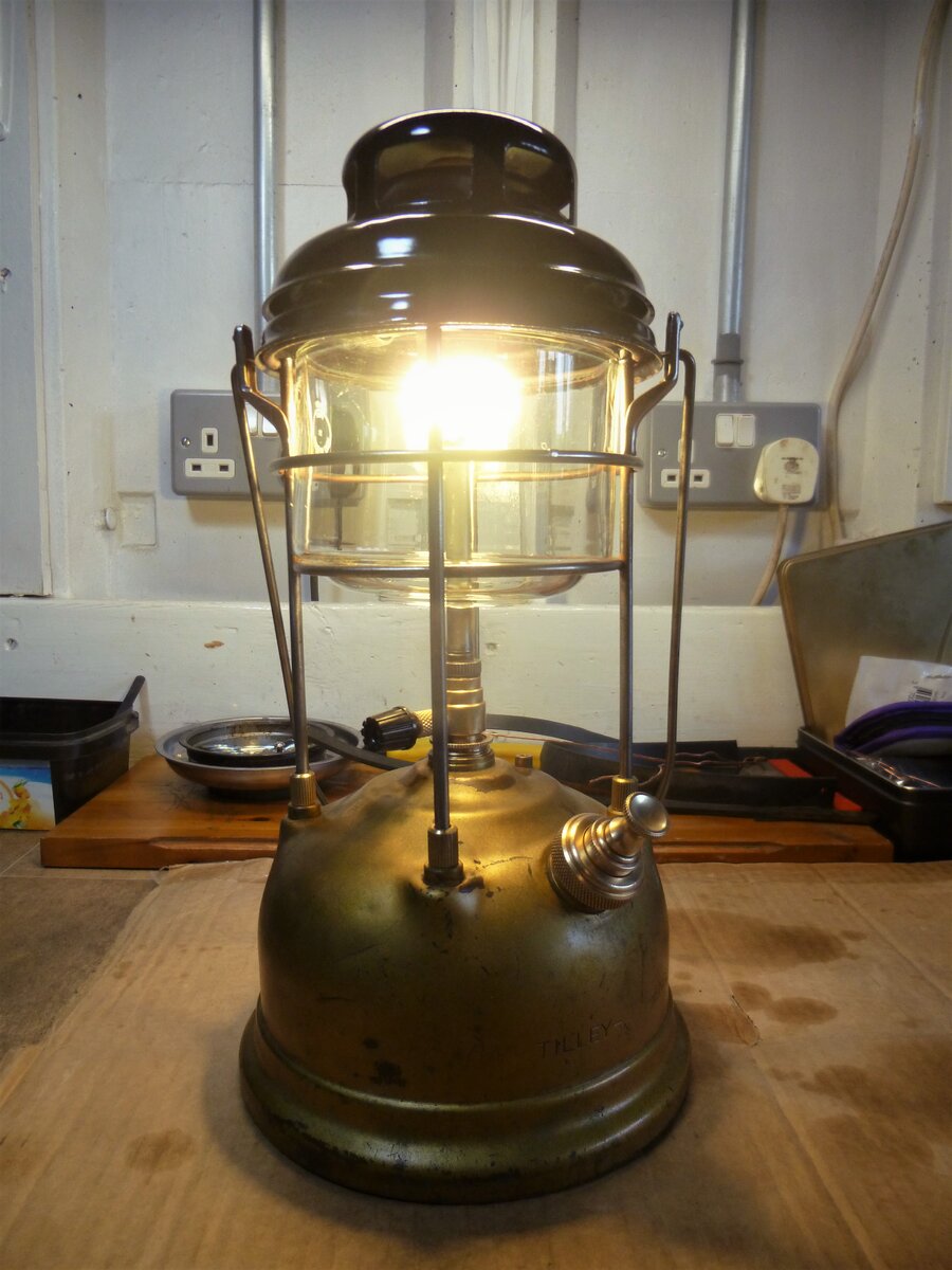

    My first Tilley x246 Guardsman Feb 1960, fettled up to a working condition. I intent to use this as a working lamp, but will improve it over time. The original hood is a bit tatty so have used my x246b hood for test purposes.
    Any advice on what paint to use on the frame to protect from rust and withstand the heat?

    If you don't light it very often, I'd be tempted to leave it as really doesn't look that bad. Lot's of Guardsman lanterns have led hard lives and the frames have become rusted to hell and back, particularly up here on the West Coast of Scotland. When that's happened you don't have a lot of choice and a complete de-rust and paint is needed, but yours looks worth preserving as it is. Maybe a coat of clear lacquer to protect the speculum plating, but I doubt I'd bother.

    Colin’s right about its good condition and I’d not bother about using heat-resisting paint for the frame if you did decide to paint it. It doesn’t get hot enough to require it, though that on a Tilley CS56 stove does, and its gloss black stock colour justified using an auto brake caliper paint to restore it on my example - caliper paint stands up to the heat well.

    Thanks for your advice, I cleaned the frame with a wire wheel, it had gold paint on it and was rusty at the top so i'd like to protect it from further rust.
    The tank has some names scratched into it, so could do with a repaint or back to brass.
    All that in due course i'll just enjoy using it for now especially as the nights are fair drawing in.

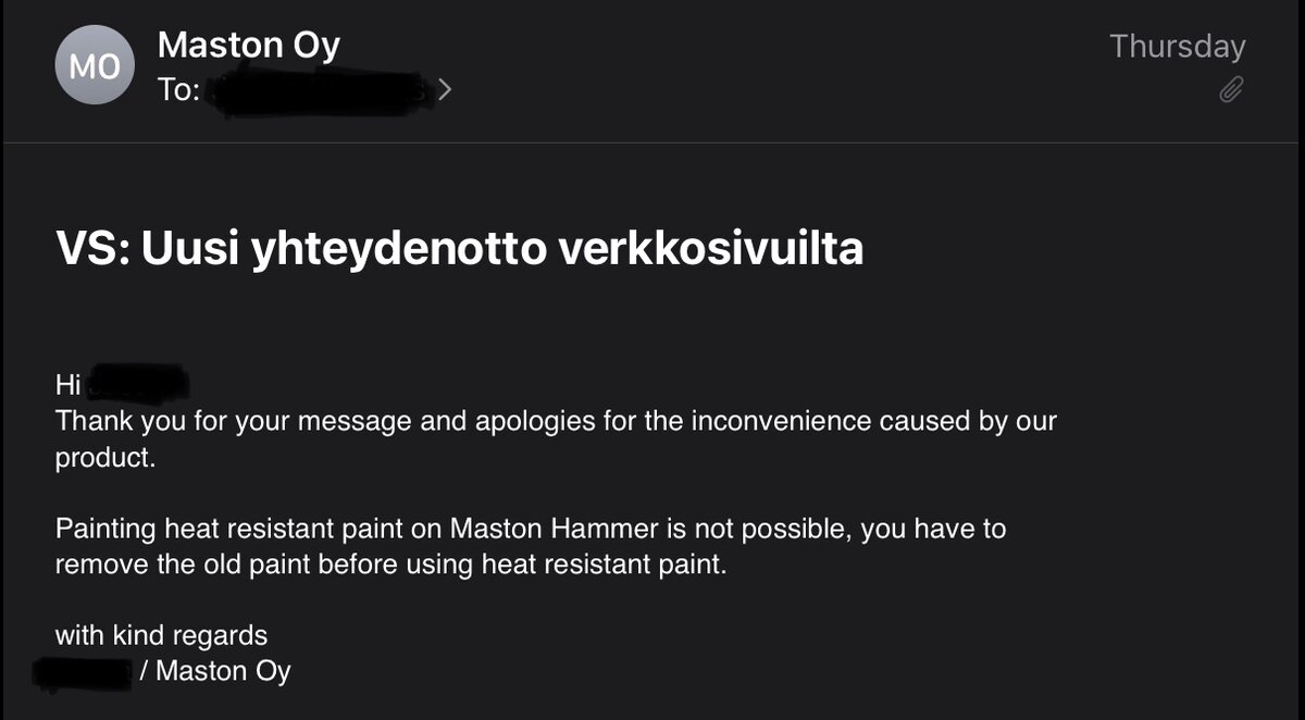

    All I can say is be very cautious. I took the time to ask Maston for their advice about spraying their heat resistant paint over the metal paint I’d already applied, and here is their response.
    It makes sense to me that you can’t leave a paint that will soften due to extreme heat under a coat(s) of heat resistant paint.
    In my case the metal paint was extremely difficult to remove. It wouldn’t even come off with liberal amounts of paint remover, which represents yet another expense I incurred as a result of painting with non-heat resistant paint.
    If I were you I’d do whatever it takes to “unpaint” your frame and then paint it with appropriate paint.

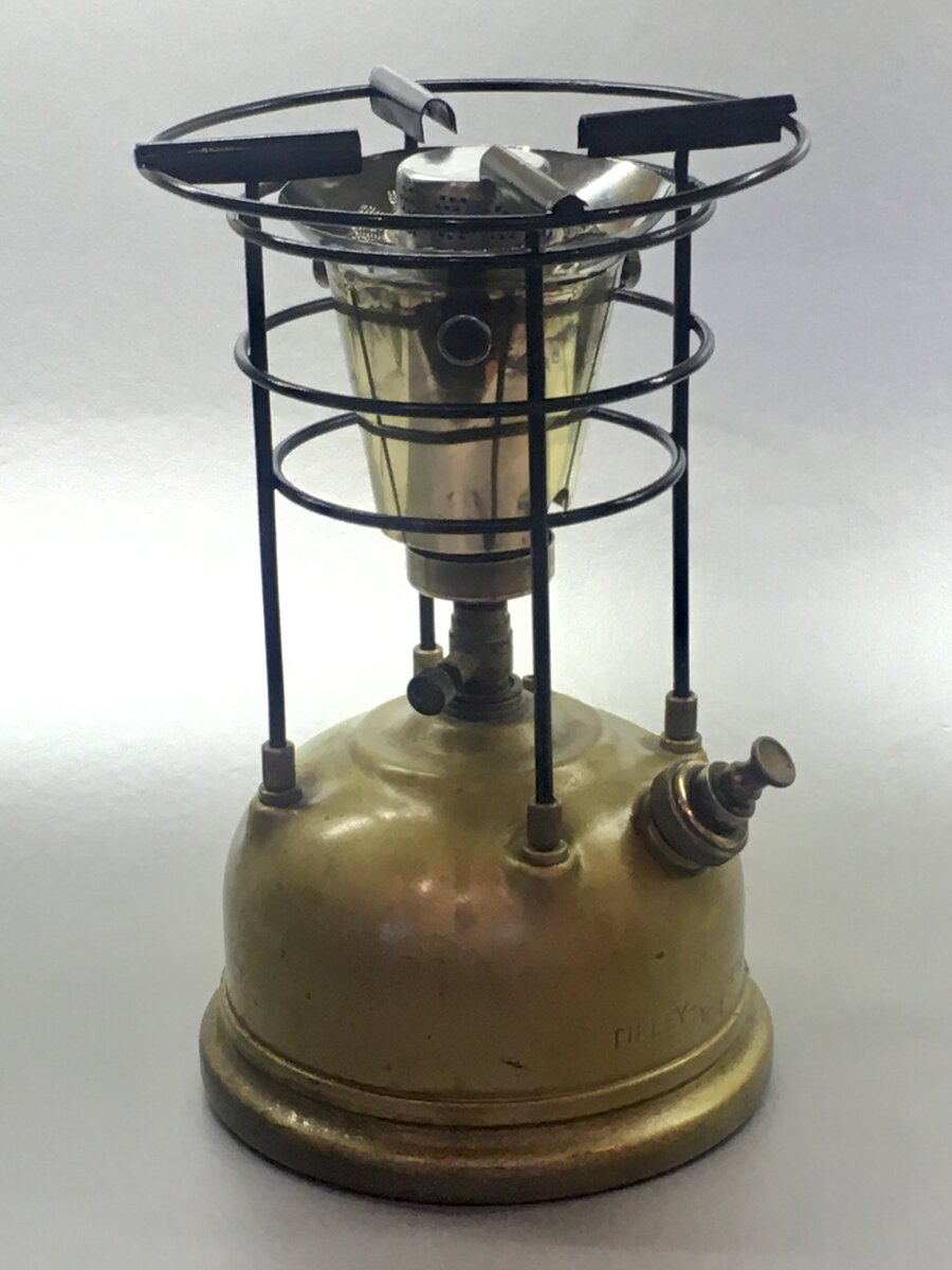

    Having now done many lantern and stove cages, bottom plates, and frames, I offer the following advice based on studied observation;
    1. Heat resistant paint (baked at 200°C) is fine if you can get it in the right colour and finish, and you have the means to bake it properly to 200°C.
    2. Heat resistant paint that requires “staged” heating (going through different temperatures) is also fine but sometimes fails to cure properly.
    3. Automotive paint that is usually baked for an hour at 65°C or 95°C is also fine, as long as you follow the instructions.
    4. Automotive “ceramic” paint and calliper paint is also fine, but I still bake mine at 65°.
    5. If you want a paint that provides a galvanised finish and appearance, I’ve found one in Australia that works extremely well on frames such as Coleman lantern frames. I still bake it at 65°C even though the instructiond don’t say so.
    6. Tilley use to bake their paint in an “infra red” oven (there’s a photo here somewhere). I don’t know what temperature but I’m assuming well below the melting point of solder.
    7. Paint in direct contact with flame will fail, as will paint on hoods and vents.
