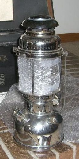

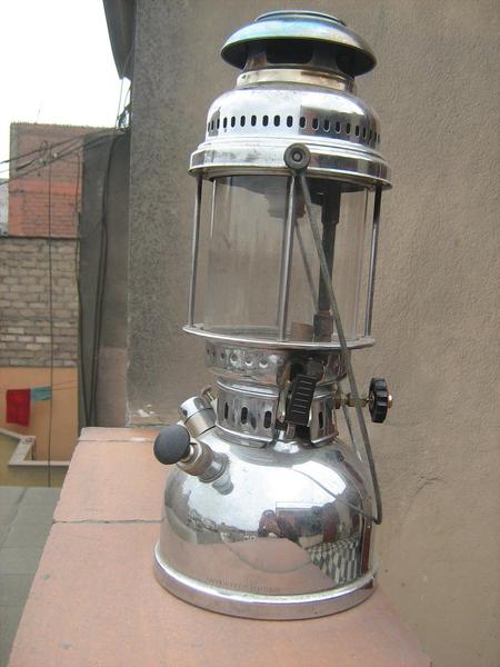

    Now that my 829 super rapid is working as Herr Graetz intended, I am preparing to do an "overhaul" on another lantern, a Hipolito 500, this one has an interesting story, apparently was bought in Canada in the sixties, and used extensively in the Peruvian Andes, then stored with fuel for an unspecified amount of time, the fuel went sour and turned into turpentine,the pump leather is dry as a piece of wood, I know the pump check valve is leaking, but otherwise the lantern is a very good looking specimen.
    The lantern fount has been filled and left soaking with denatured alcohol for more than a month, shaken at least once a week, and I just dropped the leather into light oil for an overnight soak, I will have to decide it the leather is viable by tomorrow.

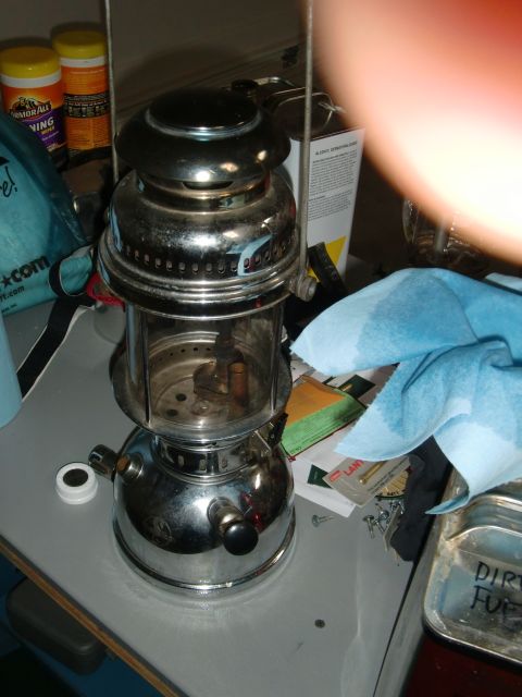

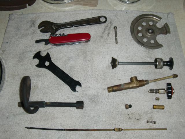

    So, this afternoon the wife, daughter and dog went for an afternoon "date"....
    first I made sure they were gone, waving as they turned the corner, and ran to unpack the goodies:

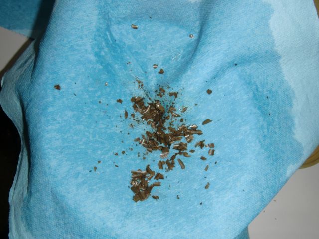

    then shook the fount with a handful of small bearings several times and drained until there was no more "garbage"

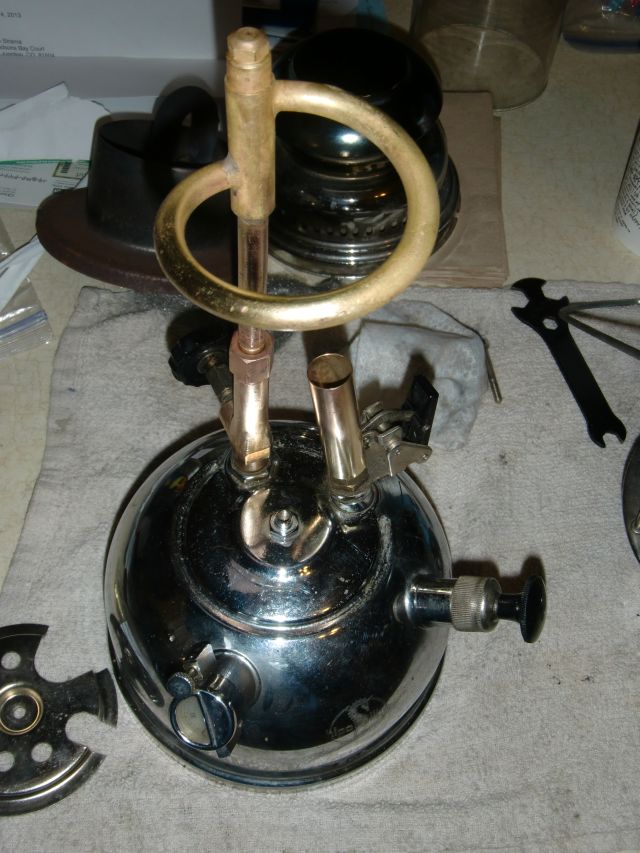

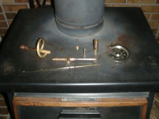

    Dis assembled the whole thing, the parts were caked with tar, and not pretty looking, they were soaked in warm vinegar, washed with soap and water, and the Preston loop got a good wash with carb cleaner, then dried properly.

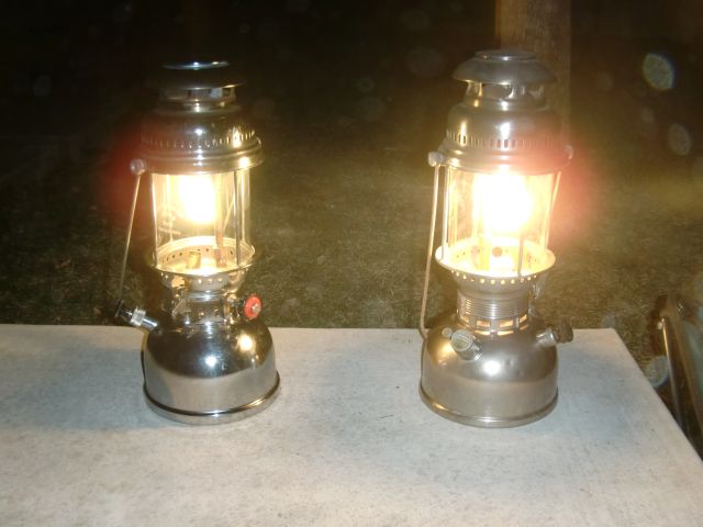

    Then I began reassembly, I made sure to put a new foot valve, and new lead washers
    once assembled, I had to test it, I had a problem with not tightening the generator jamb nut properly and the preheater nozzle being clogged,which made the start "interesting" ( don't worry, I still have my eyebrows intact...sort of...) and now it is having a "test burn" for almost an hour next to her cousin from Germany
    PS: it is a Hipolito model 500, not a 502, at least it is what it says on the fount...

  7. Mackburner
    It is always easier to fettle the second one. NIce job. This is actually model 500R. The markings are the same but the 500 is alcohol pre heat only and this one with Rapid pre heater has an R suffix. Nice early one too. The pre heater torch type makes it 1954 to 1964. These Hipolito types with the two tone control wheel pre date the period when Petromax were made in the factory. Nice one. ::Neil::
