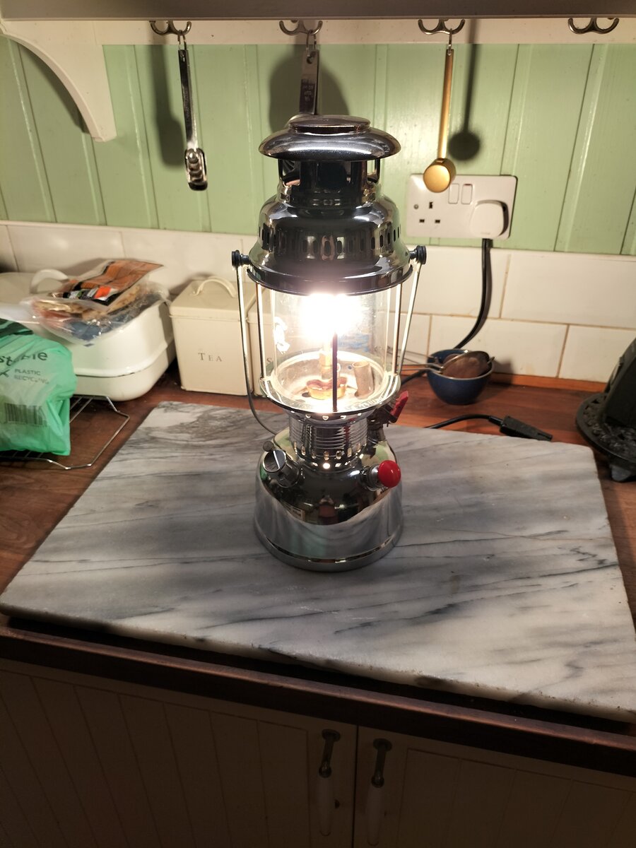

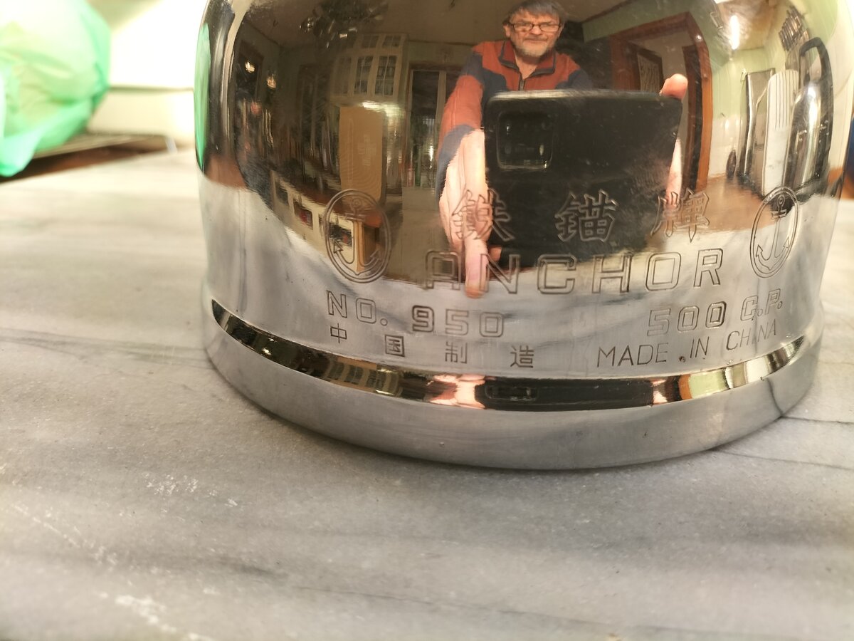

    This was my first clone and arguably the best lamp I own.
    It's certainly the brightest by a very large margin, it starts very easily and lasts ages on one fill.
    My phone doesnt do it justice but its way to bright to look at and easily fills any room with bright, white light!
    As we may be having regular power cuts this winter in the UK, I thought I'd best check out some emergency lighting, so I fetched this particular model and I definitely wasn't disappointed!
    I am so pleased with my Anchor 950, it really is my go-to, reliable workhorse!
