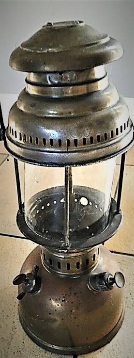

    I purchased this Petromax 826 online which looked great for fettling.

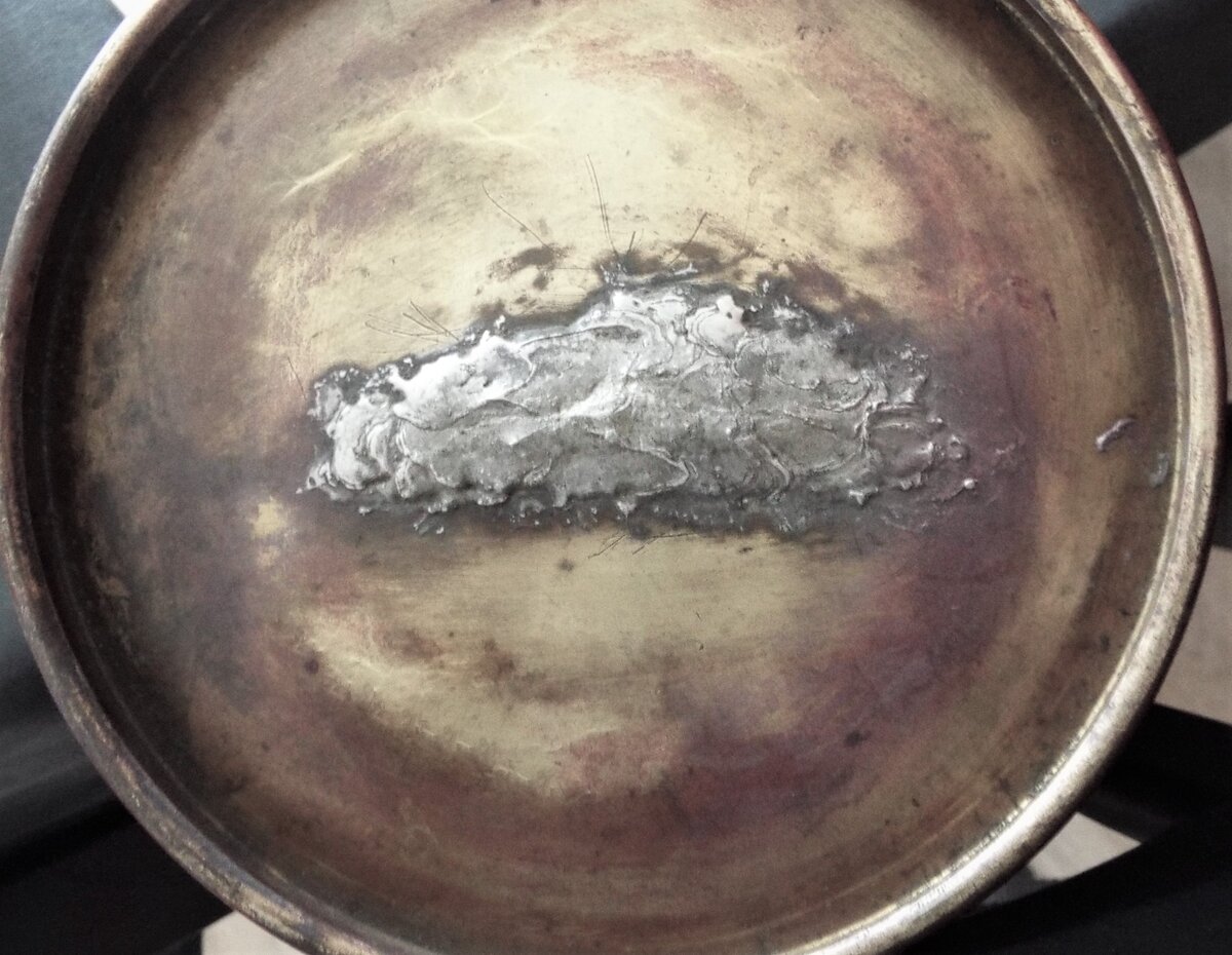

    What was not mentioned in the description was the tank had obviously at some point been over pressurised and had at some point been repaired [​IMG]not sure about this repair ?
    It also had various deep dents [​IMG]
    and seemingly at some point been used for target practice for a pellet [​IMG]
    Hmmm ?

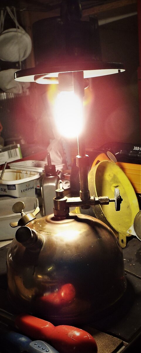

    So what do I do with such a lamp? Firstly I dismantled the lamp to basics checked and replaced the seals did a pressure test which it passed so then I fuelled the lamp up and lit it [​IMG]
    Great, so now I have a working but awful looking petromax 826 I reckon 1960s ??

    The two screws top hood and the angled vaporiser
    show a pre war Px from the 30s.

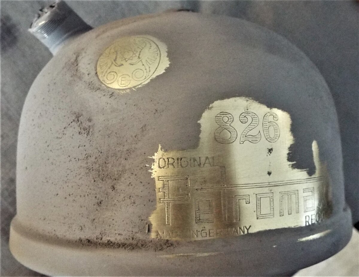

    Is there a 826 stamped on the fount?
    The Px 826 is rated at 350 CP and originally
    was nickel plated.
    What you're going to do is a matter of what you like:)
    Matthias

    Yes ( It has 4 Large openings on the hood ) No sign of Nickel Plating seems just brass

  6. MYN
    It looks 1930s by design. I've not seen a painted Petromax 826 too but there was another almost similar Petromax 2826, which is perhaps painted or enamelled.
    The repairs and dents are part of the lantern's history. So long as it works, that's a seriously worthy piece.
    It should have nickel plating originally. You should be able to find tell-tale specks of remaining nickel(around the folds and edges, hidden sections, etc). Its unlikely for a lantern to completely lose all its plating just by age or heavy use. I know some guys are bare-brass enthusiasts who might deliberately polish off the plating. That might include the seller as well.
  7. Martin K.
    Martin K. Subscriber
    Sep 20, 2013
    1,148
    The style of the hood makes me believe that a spare from an old Hasag 252 found its way on this lantern. The Petromax parts have a different look as can be seen from the posts in the reference gallery.

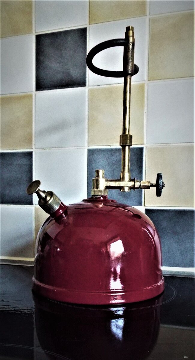

    Yes there are signs and areas of it being nickel plated almost all of which has been removed in its history. I would not have minded a few indentations from use over the ages but the rifle pellet indentation really does ruin it. So I am going ahead with a Font Paint job and polish up the rest of the lamp. I`m thinking Deep Maroon/burgundy as was the Vapalux 300x
    post pics of progress. Thanks for the info
  13. MYN
    Vapalux 300X Burgundy is attractive. What about the pellet indentation? Are you filling it up with auto polyester putty, epoxy or solder?
  14. Apache
    Feb 4, 2011
    11
    Kings Lynn
    Hi
    Am trying a similar product to P38 2 Pack Body Filler. My only concern would be when the lamp is Pressurised would it push the Filled area to the surface creating a raised area ? I suppose it`s all an experiment. In the back of my mind If the worse happens I can always strip it down again which would be easier to do if I use the p38 as opposed to soldering. Interesting can`t wait to see what happens as have never tried filling a dent in this way before !

    Well Looks Good So Far Very Pleased but the Petromax Logo on the font is No Longer Visible

  16. MYN
    It certainly looks so spruced up. A lot of us here are highly attracted by red shades, burgundy, etc..
