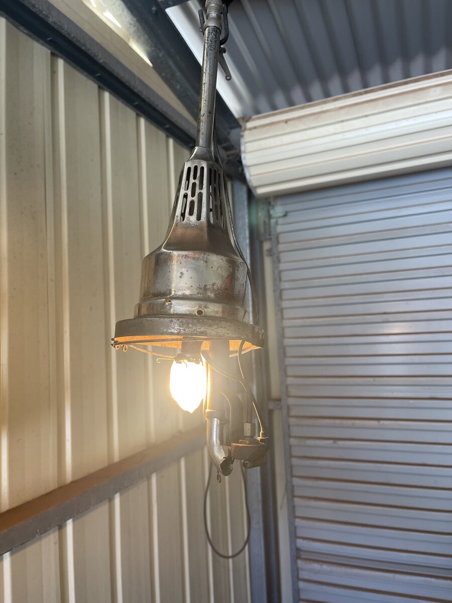

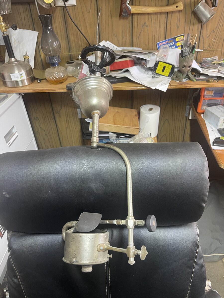

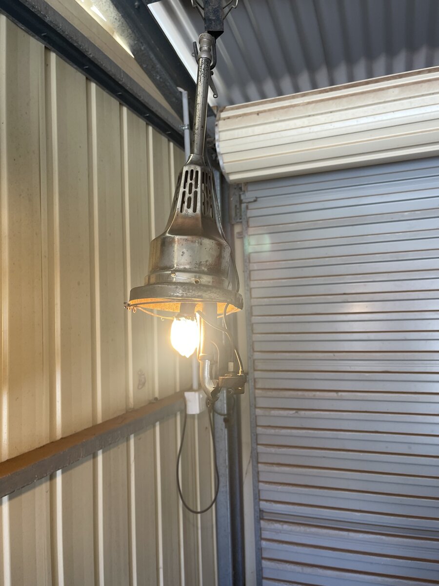

    Hi fellas, this is my Nagel Chase hollow wire lamp in action, it’s bright and cool, I made a replacement pricker. The rest of the lamp was in good condition as found, I don’t have a globe but I’m looking for or a replacement, any leads would be appreciated IMG_1729.jpeg IMG_1728.jpeg IMG_1727.jpeg

    Very nice work and a less common Nagel Chase to boot. :thumbup::thumbup::thumbup:

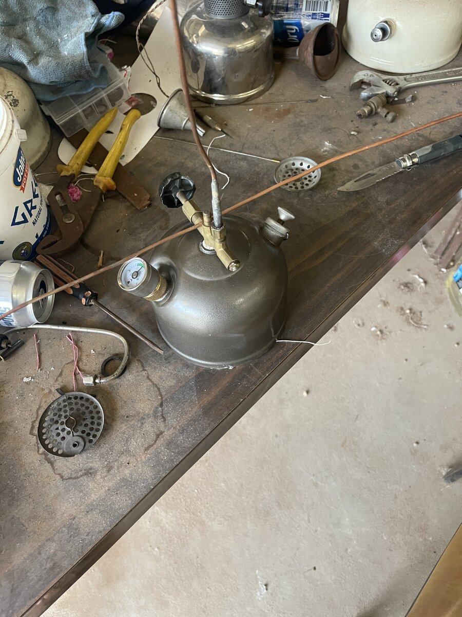

    What type of tank are you using?

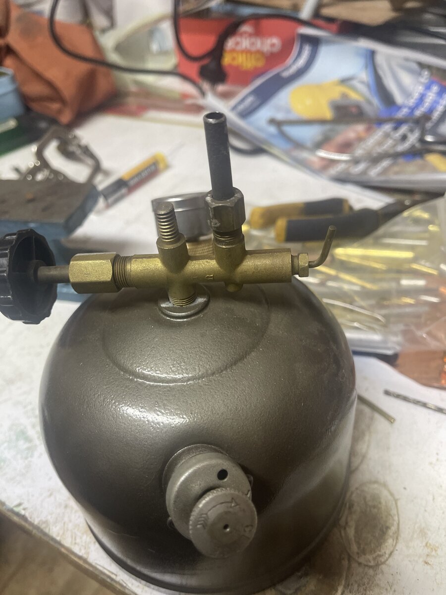

    I made a small tank from a Coleman lantern, I cut down the generator cut down som brass tubing to slide inside the guttered our Coleman generator on the lamp, the adapted the hollow wire to that silver brasied it together. Bought a fuel cap pressure gauge all in one from eBay,@JEFF JOHNSON
    I put about 2.5 to 3 bar pressure. I used the valve on the tank and the on/off leaver on the lamp. To be as safe as possible, you never know next. IMG_0871.jpeg 70140630527__F3C69CC9-54CB-417C-A26E-3AE85FA5B4B7.jpeg 70140621804__F36E69D0-E451-4D6A-B69D-6B71BDCC1879.jpeg IMG_0284.jpeg IMG_0283.jpeg IMG_0968.jpeg

    Good ingenuity on the Coleman tank to test burner, hope you can get the original to operate as well.
