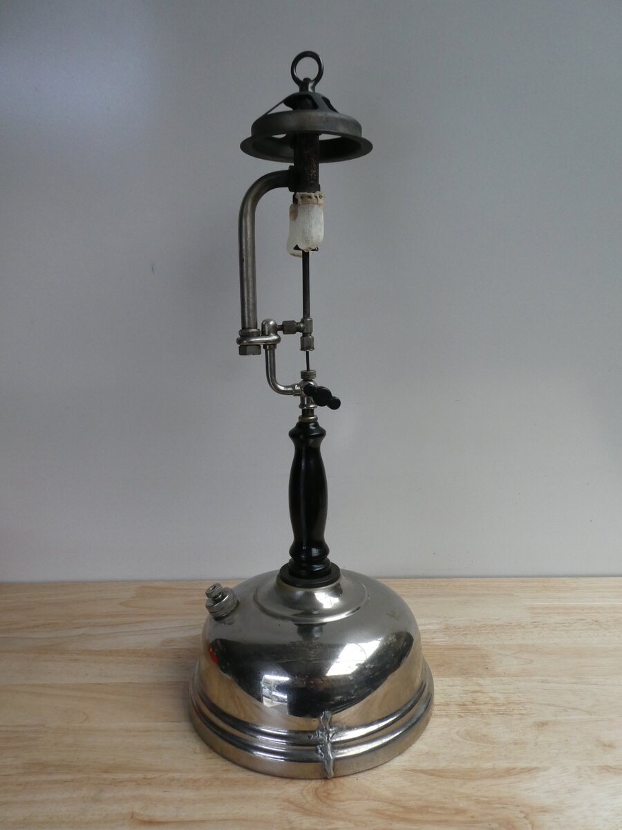

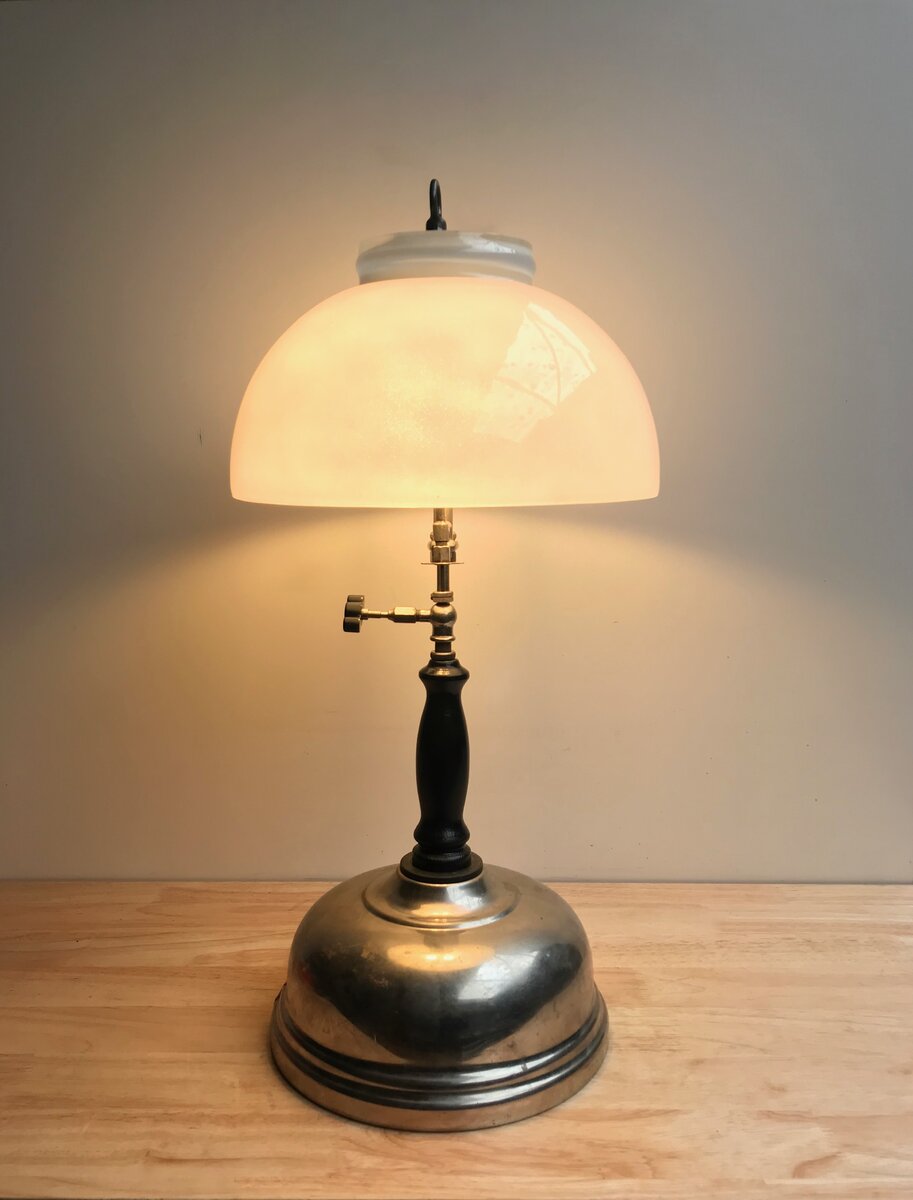

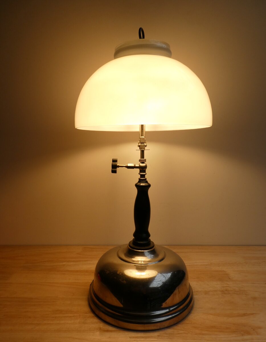

    This is a Nagel Chase Model 10 300cp gasoline table lamp, manufactured from 1920 to 1932.
    The lamp was found in Australia.
    It is displayed here with a reproduction Miller-type shade.

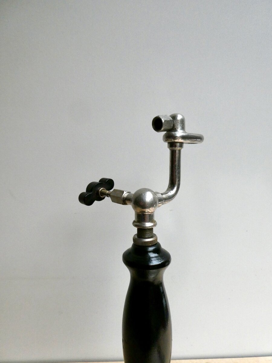

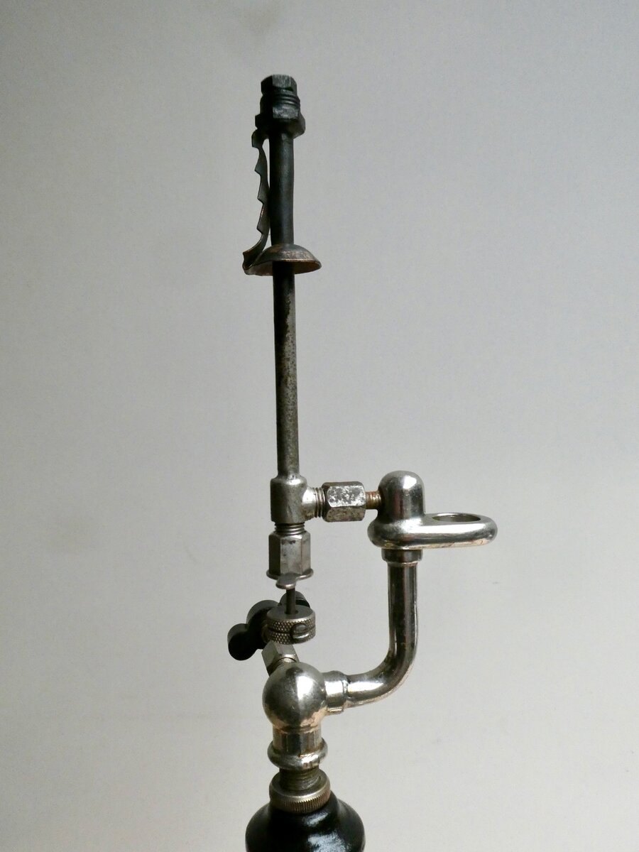

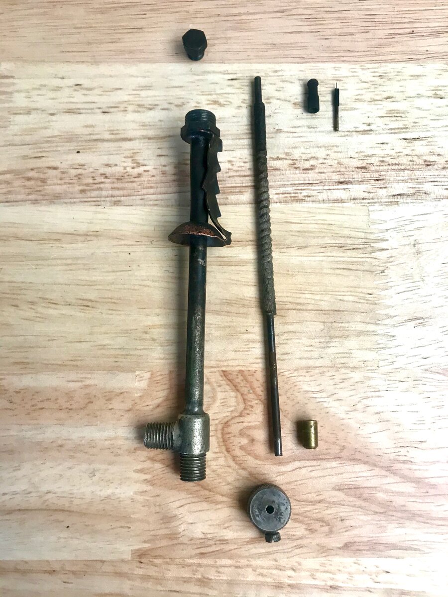

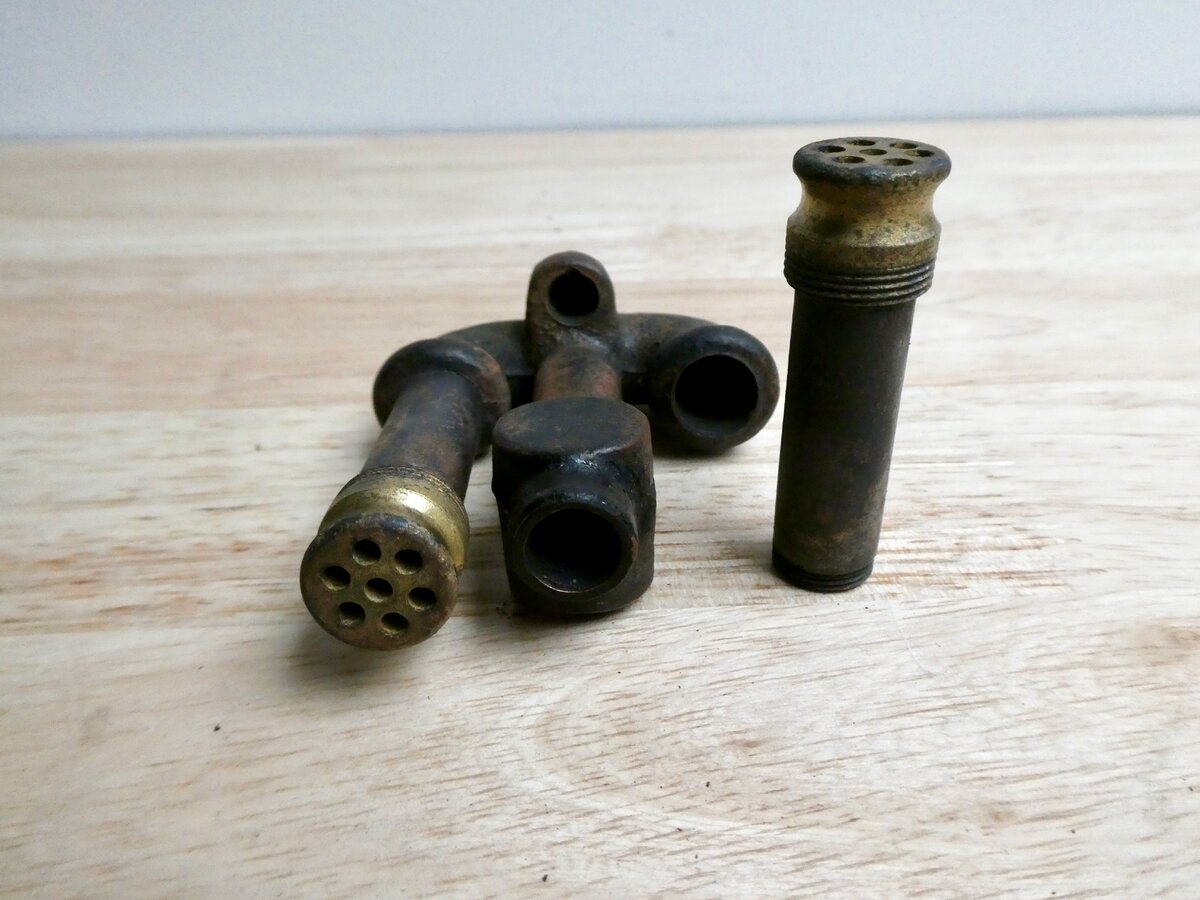

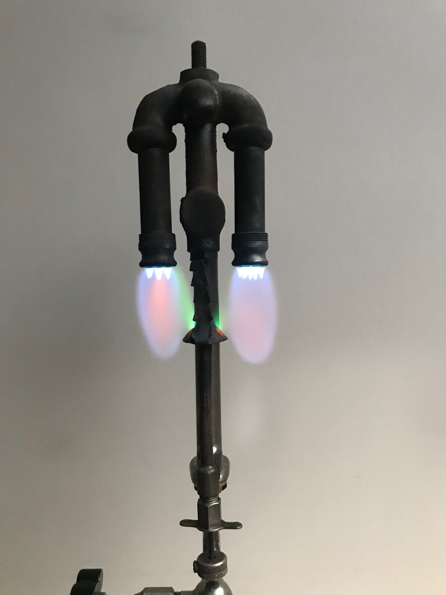

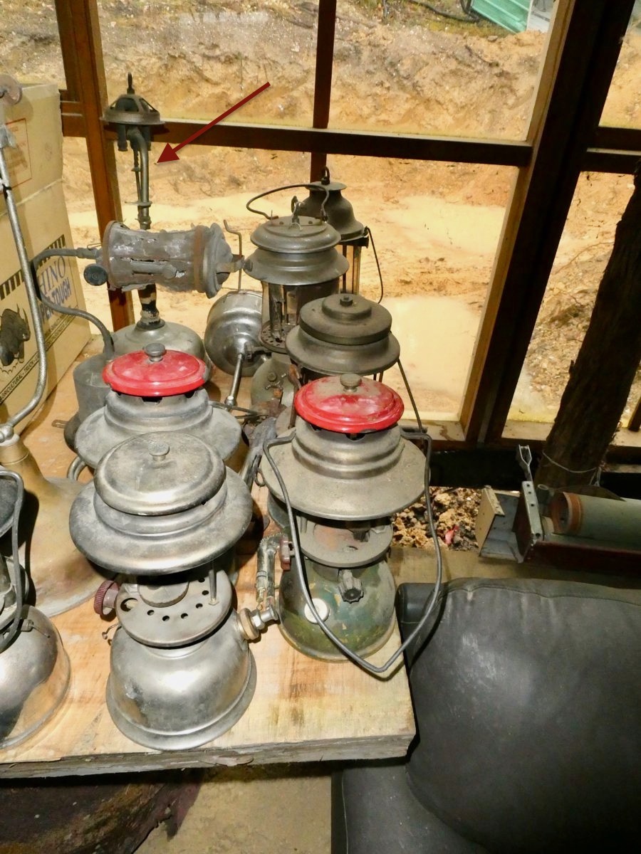

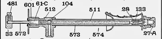

    The generator is an object of many parts. The pricker rod is bound with asbestos; the needle and its holder is threaded and screws into the pricker rod; and the pricker is then covered by a shaped cap that screws onto the pricker rod with the needle protruding from the top.
    Note that this generator is different in some aspects to the ones shown to me by @Mackburner. For example the bottom of the generator tube is affixed by solder and not screwed. This appears to be factory and not after-market. The pricker rod and asbestos packing can be removed through the top of the generator once the nipple has been removed.
    [Illustration courtesy of @Mackburner]

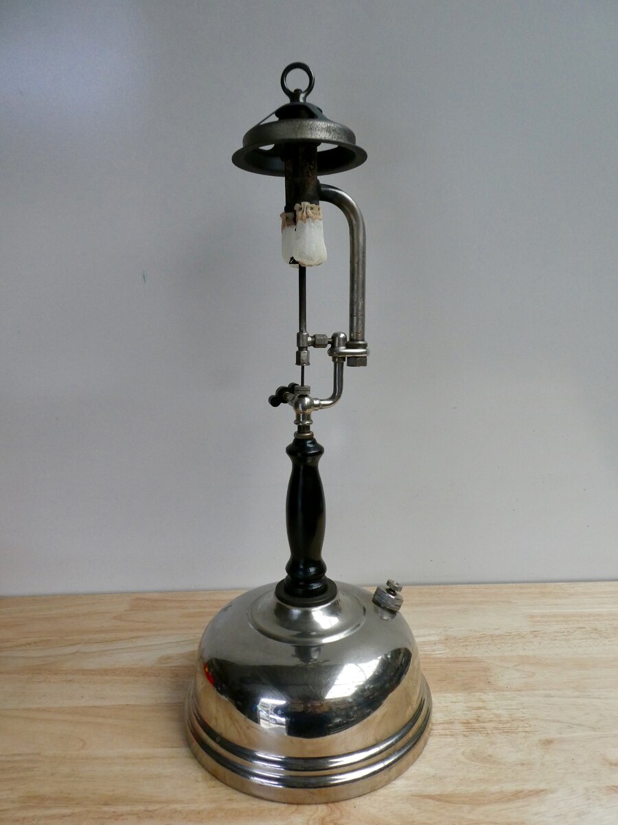

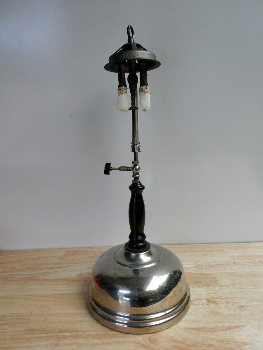

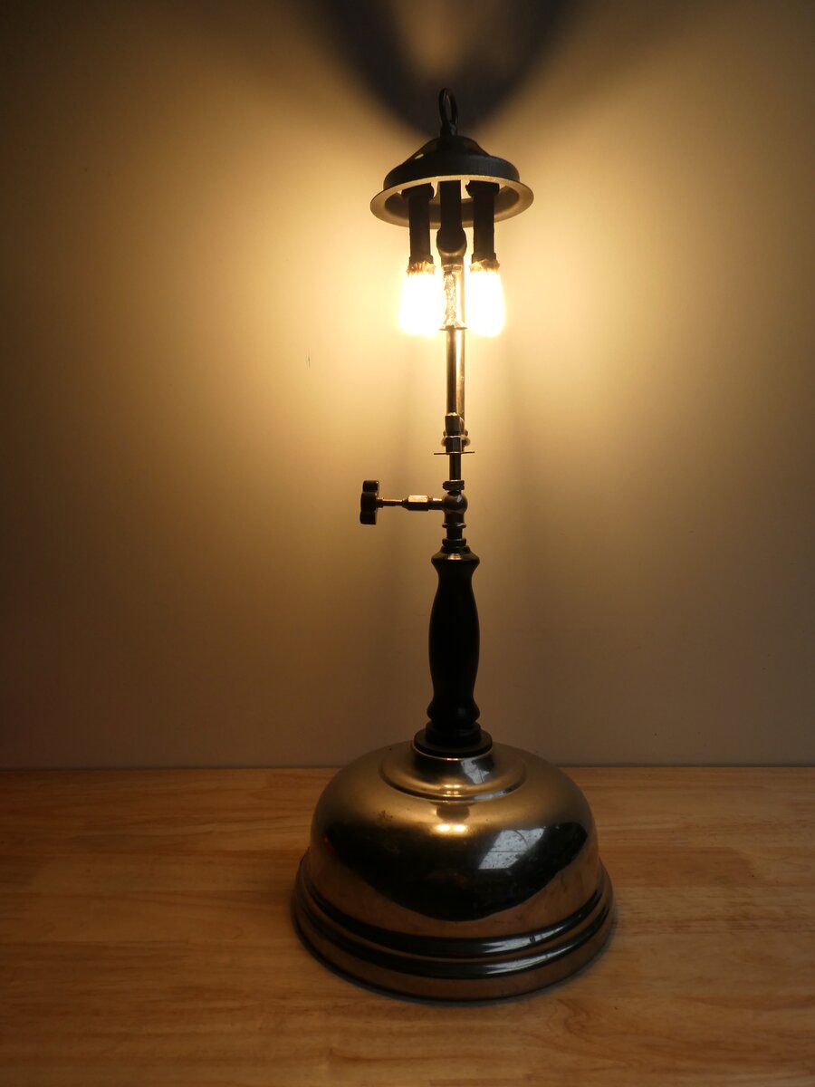

    Up and running.

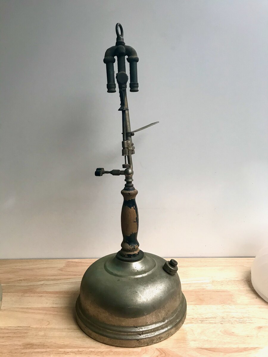

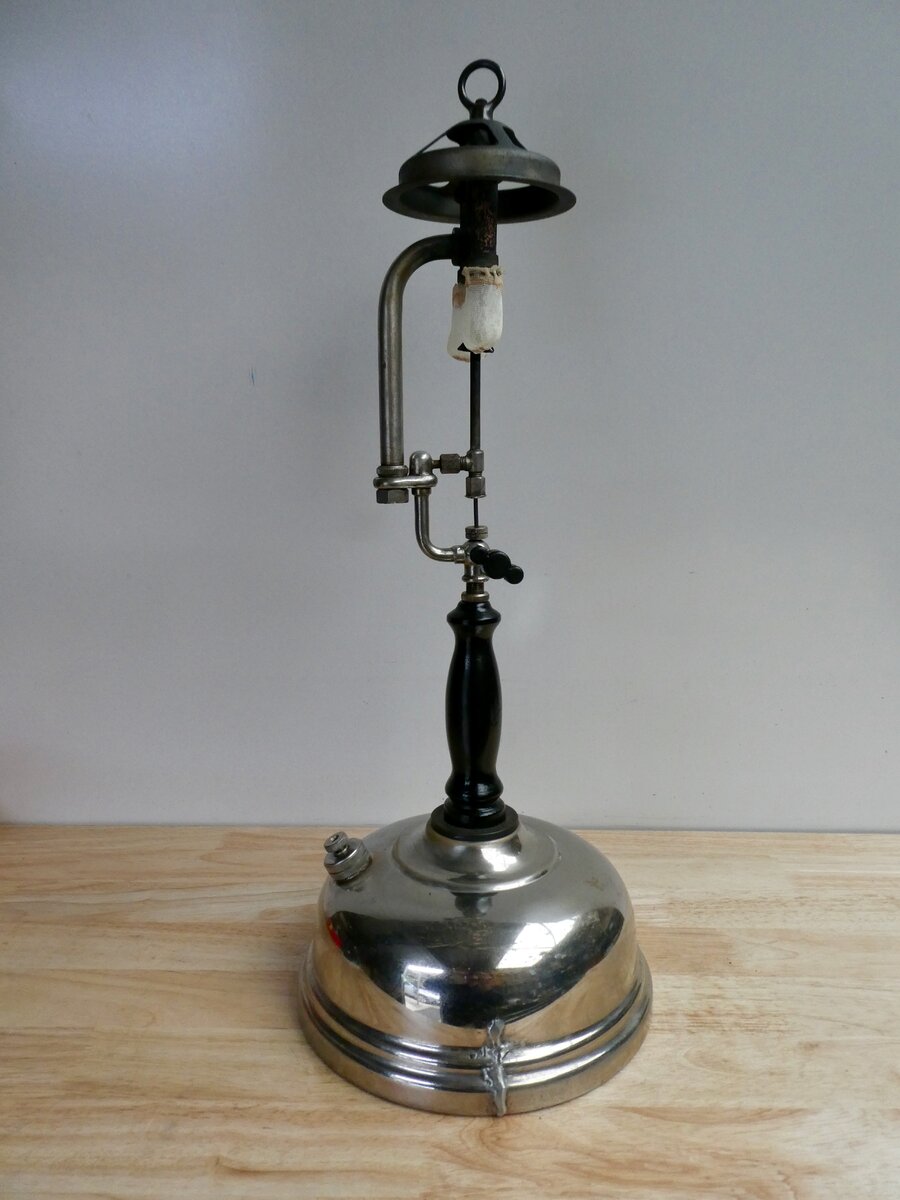

    As it came.

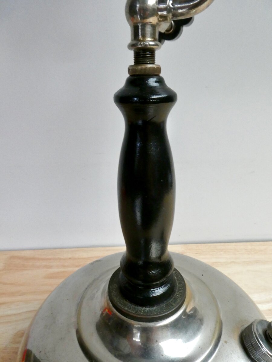

    Some fettling.

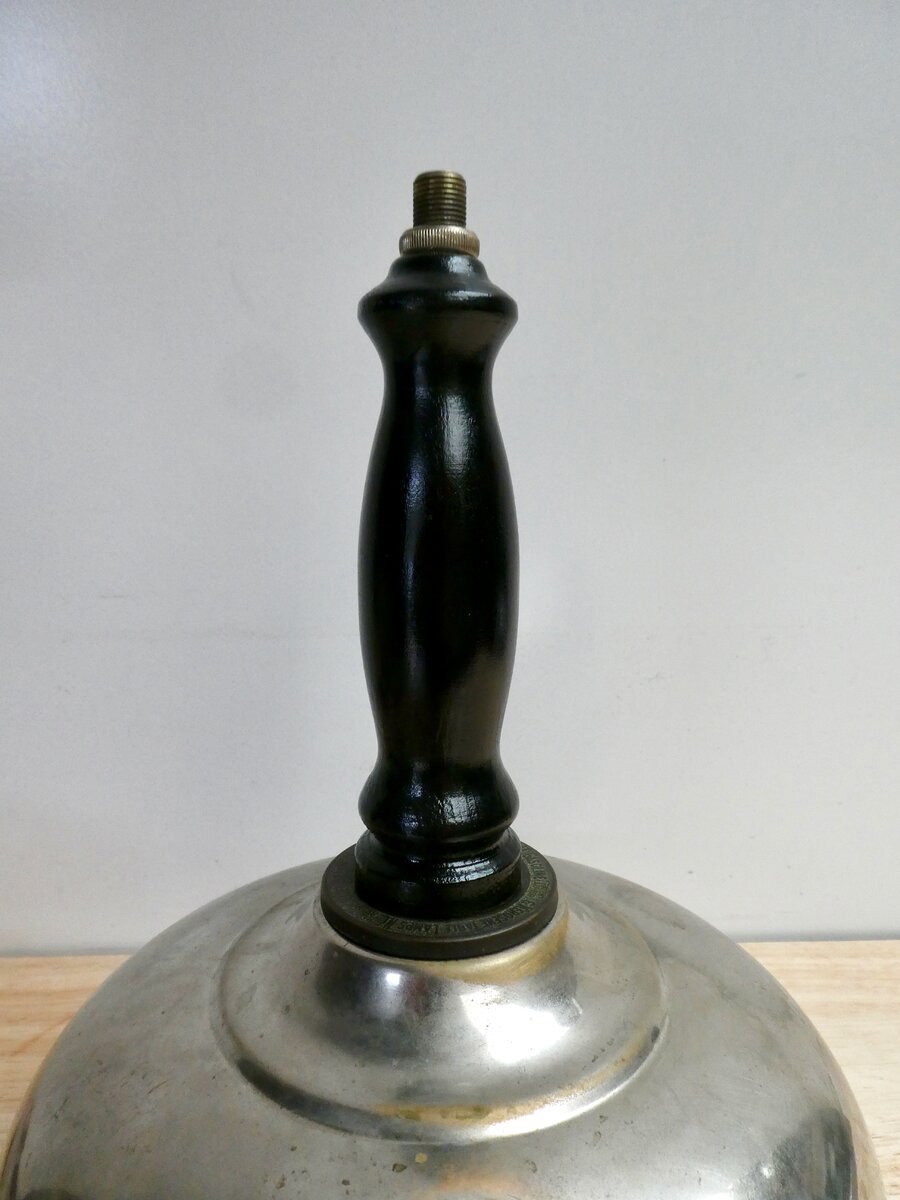

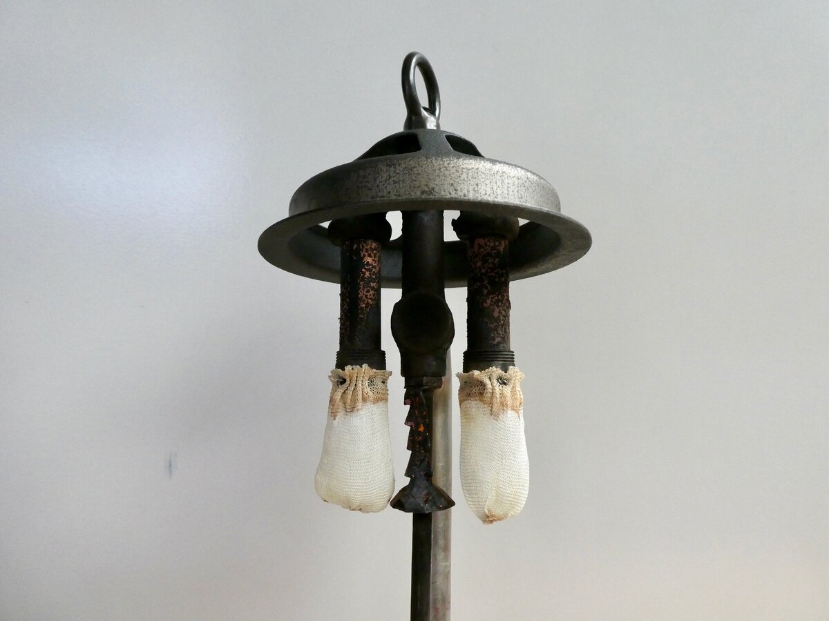

    Aside from giving the whole lantern a thorough clean, polishing the nickel, and taking the generator apart and giving it a deep clean, I had two repairs to make:
    1. I had to resolder this connection.

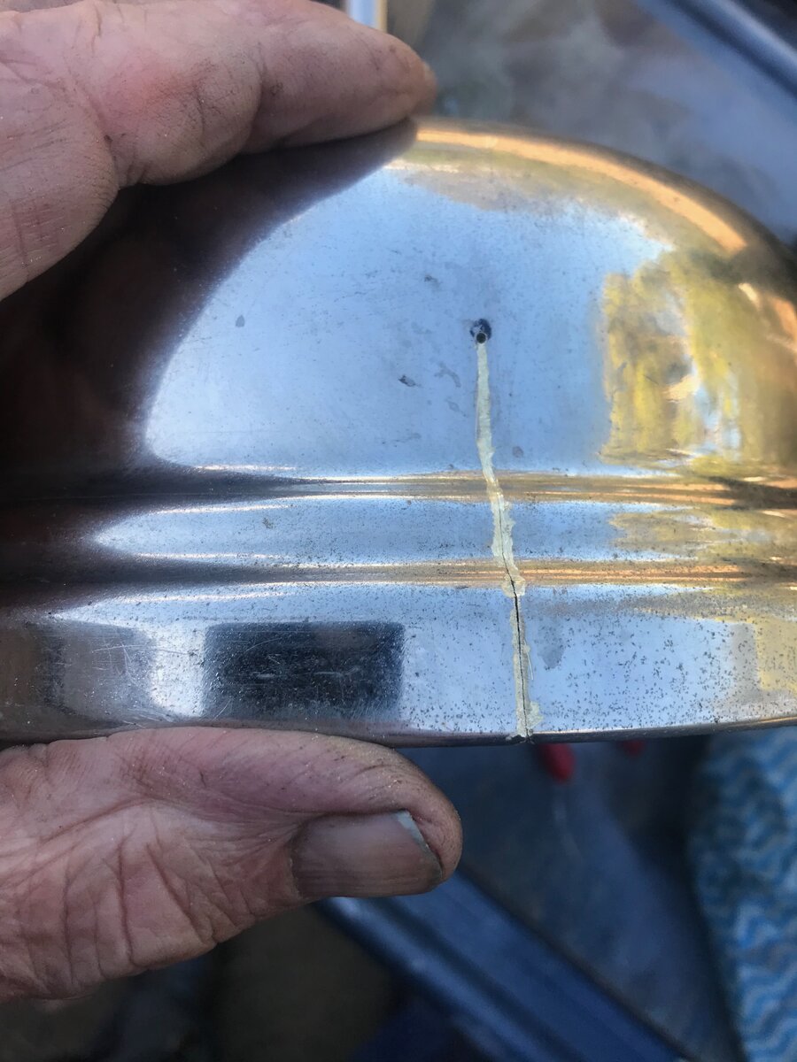

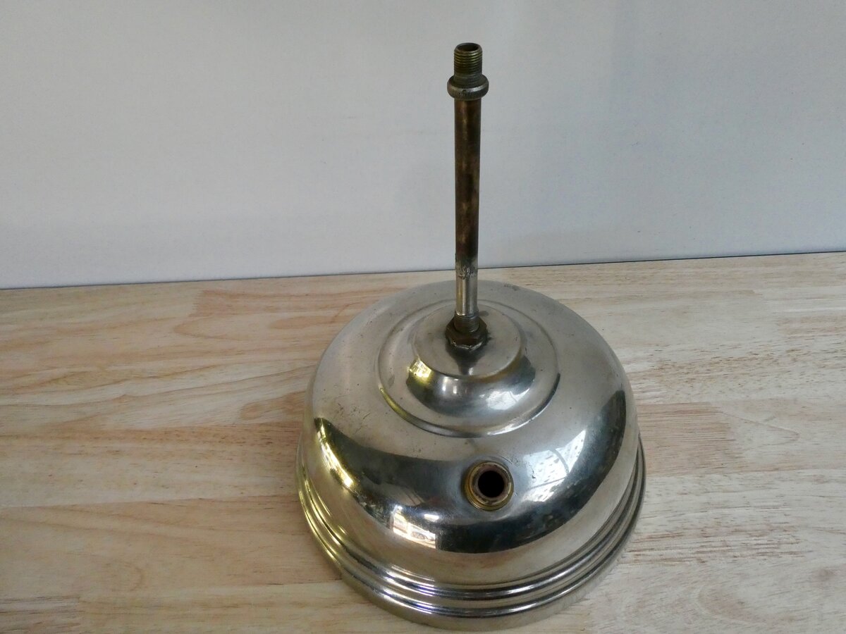

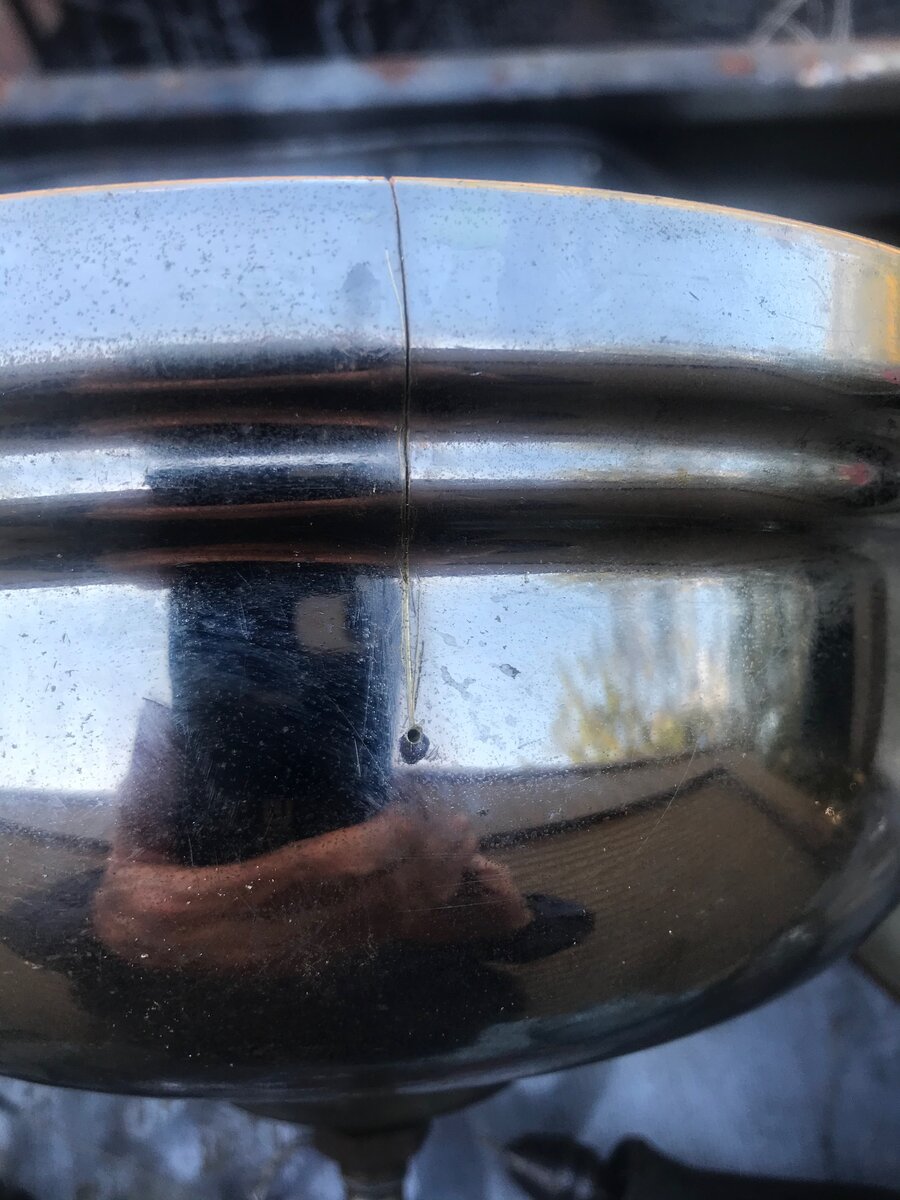

    2. I had to repair a stress crack in the tank.
    I did the job of a journeyman on the stress crack, but it is fixed and tested to 45psi and does not leak:
    A hole was drilled at the top of the crack with a 1mm drill.
    A Dremel with a diamond ball was used to create a channel for the solder.

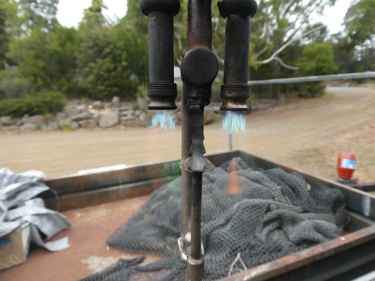

    Testing.
    Because of the stress crack repair, I did a lot of testing outdoors until I was confident the tank did not leak.

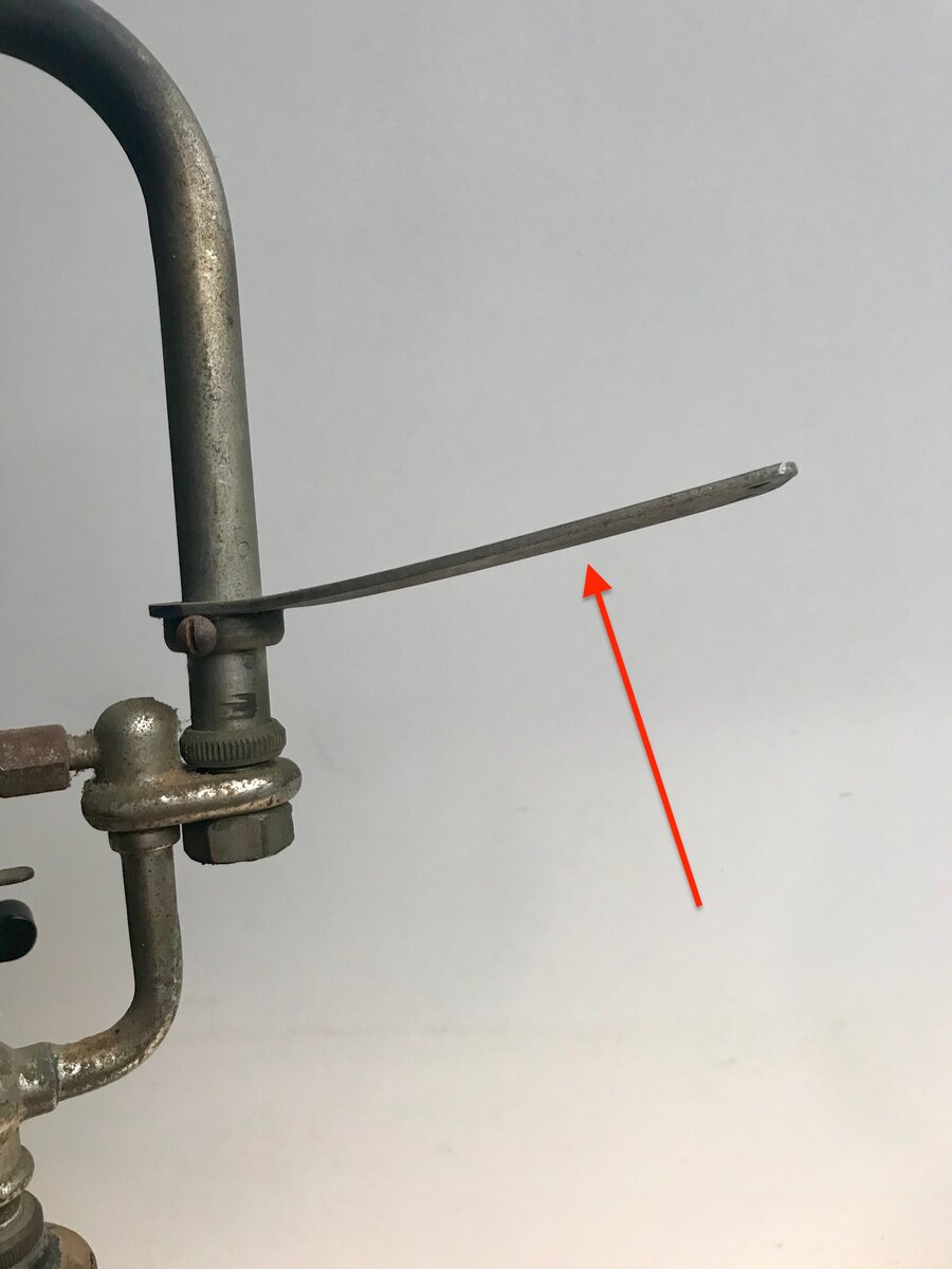

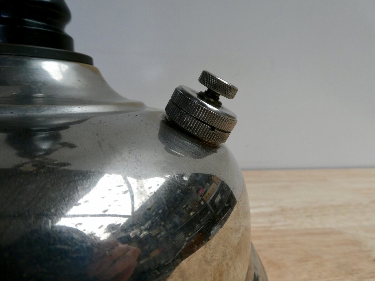

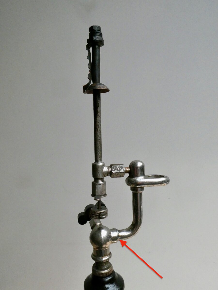

    I never did work out what this was for (see conversation here).

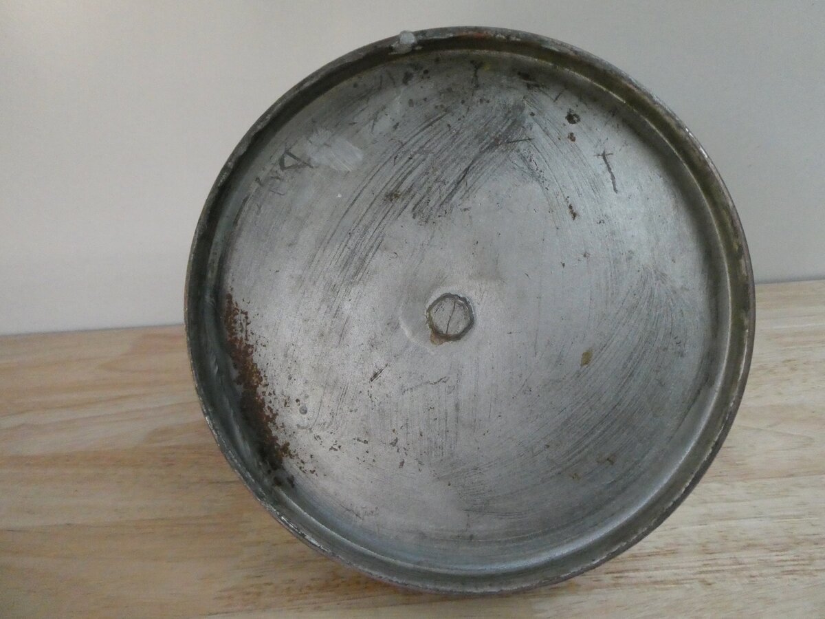

    I take it that you managed to find or sort a plug for it then??

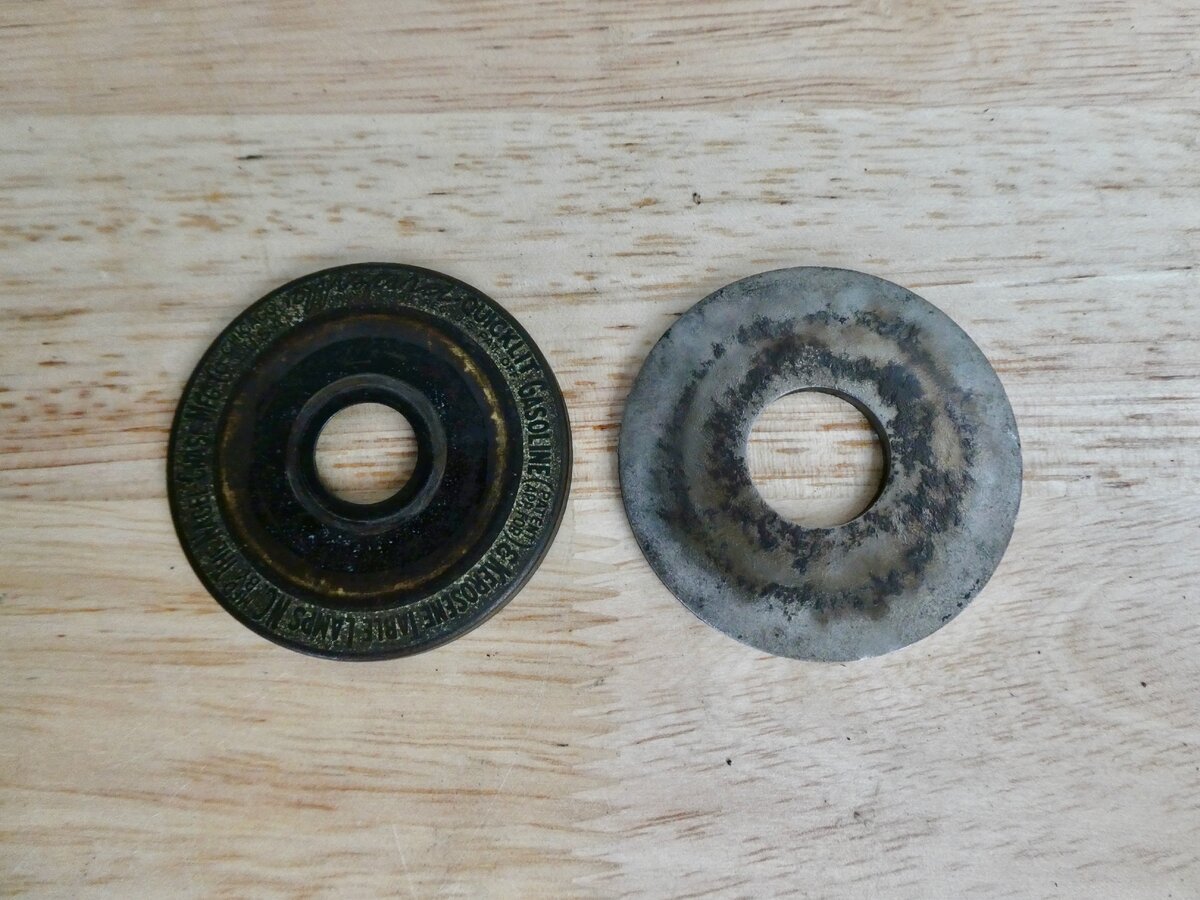

    I haven’t sorted a plug for it. I had it temporarily soft-soldered over with a brass disc, knowing full well it wouldn’t last long. The lamp started fine, and when the mantles were fitted and the light ran for some time, the solder melted and the brass disk fell to the bench, but it continued to burn excellently.
    I’ve been running it without the plug ever since.

    Interesting? .. I assume that other ones have a plug?
    Thanks Tony :thumbup:
    Edit ; just read another post of a similar Nagle Chase and it talks about a supplementary heater for the kerosene version, so that is why the hole was there??
