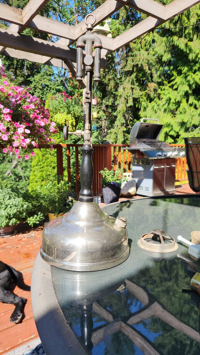

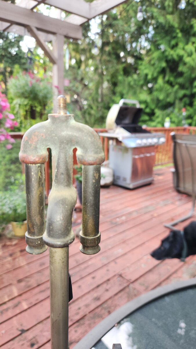

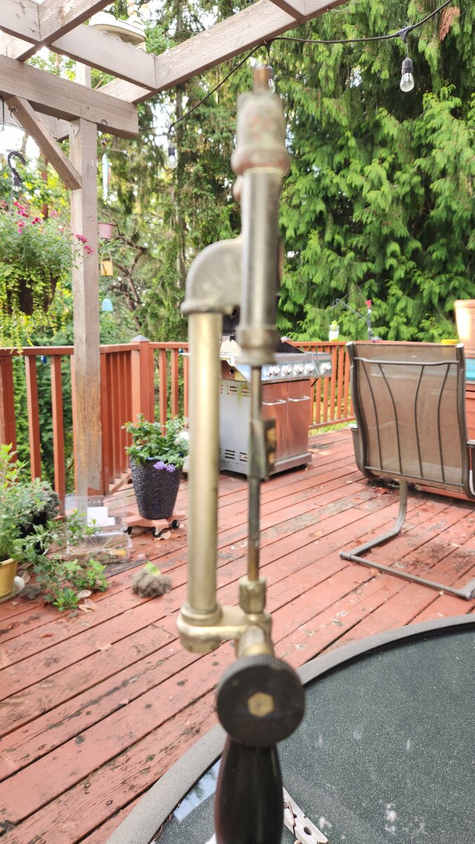

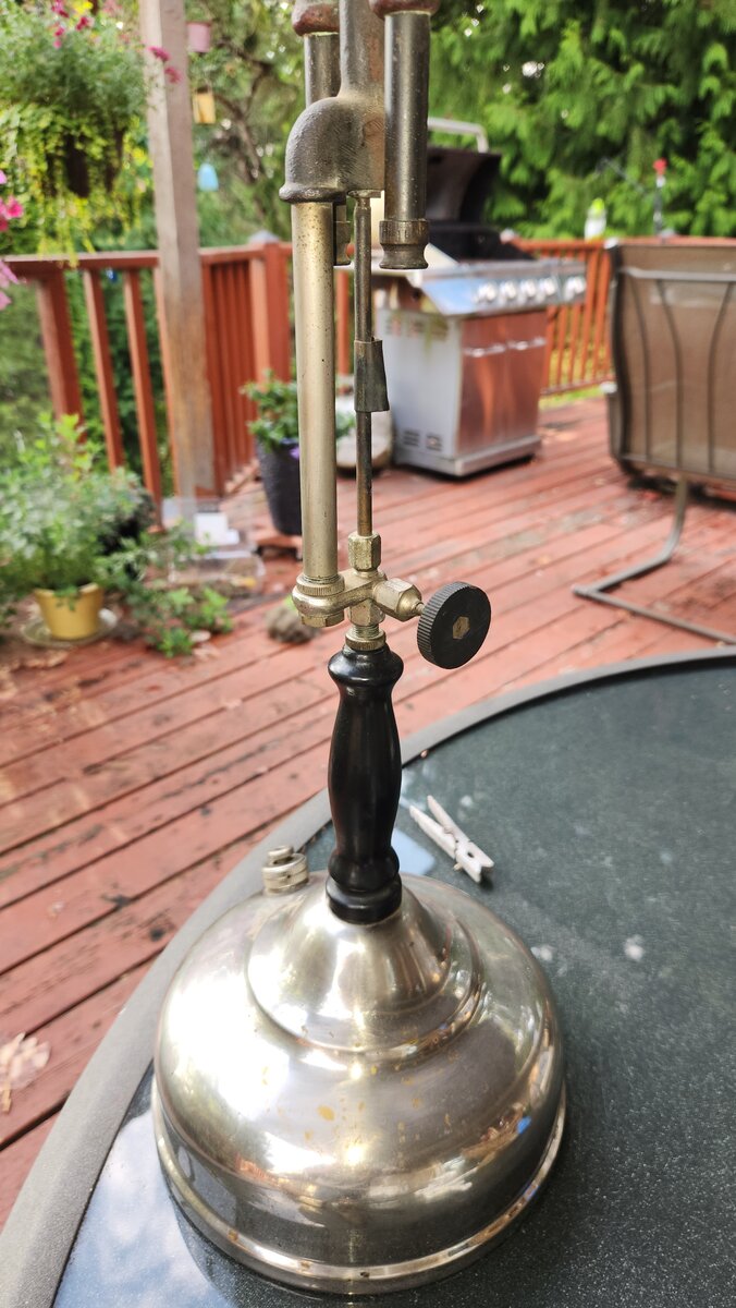

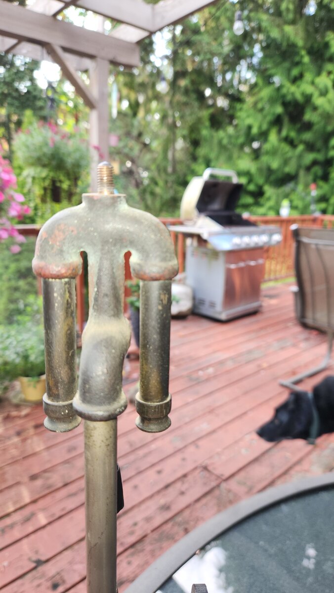

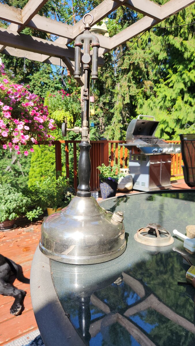

    I scored another Nagel-Chase Lamp and based on Toby Garner's post it looks like a Model 11A. At least from the outside it looks like it has most of it's original parts.
    I have a ton of questions as I dig into repairing/ restoring it. Would it be better to post them. Here or in the Fettering Forum?

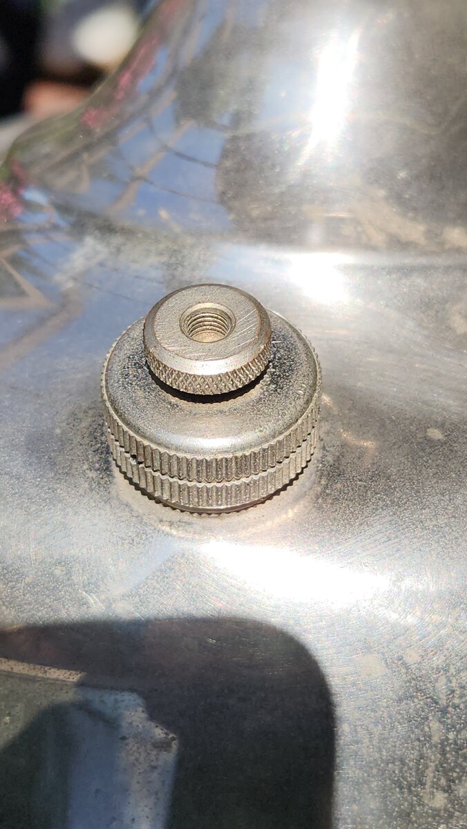

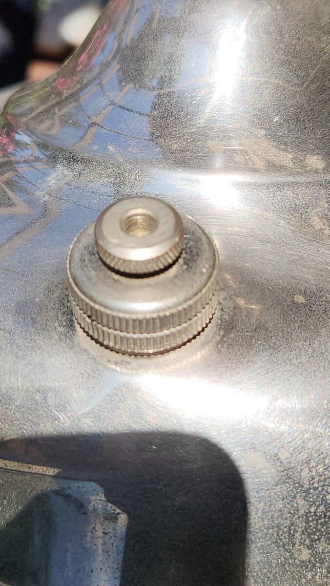

    First Question, how do I pum it up. That's my first step in troubleshooting what it needs in addition to taking it apart and cleaning it. I'm attaching a picture of the pressure valve and a pump and I hope someone can tell me if this pump can mate with my valve? 20230901_105314.jpg 20230901_105314.jpg 20230901_105310.jpg 20230901_105314.jpg 20230901_105310.jpg Screenshot_20230831_082212_eBay.jpg Screenshot_20230831_082212_eBay.jpg 20230901_105314.jpg 20230901_105310.jpg Screenshot_20230831_082212_eBay.jpg

    Hi "Nagel",
    I think you have a Nagel Chase Montgomery Ward lamp. It has a tank similar to the NC number 10 lamp, but is equipped with a burner unit as the N C 15-W (Wizard) “Superlite” lamp.
    You can find this lamp here .... Montgomery Ward's Nagel Chase | Classic Pressure Lamps & Heaters
    This pump would probably be OK. Just test it and be sure you have a washer to get the valve tight.

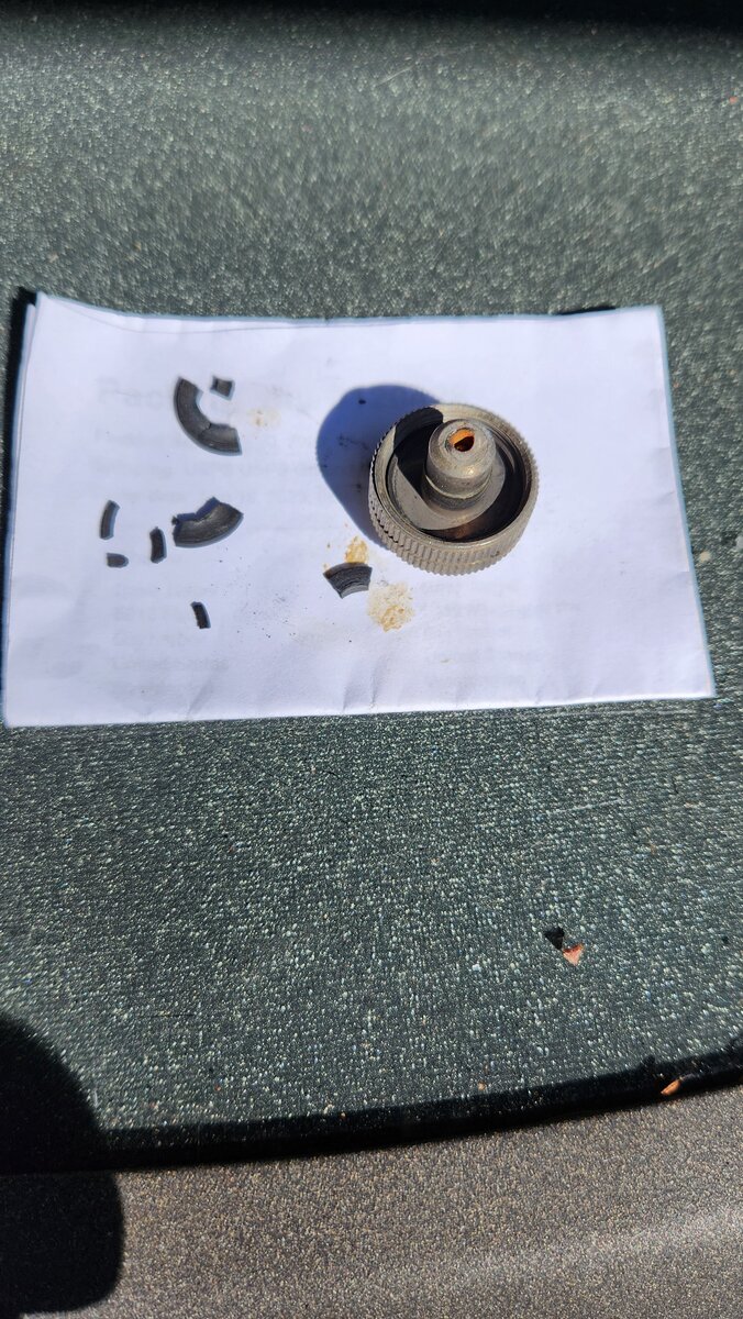

    When you say, "Just test it and be sure you have a washer to get the valve tight."
    Do you mean what's left of what I think was a gasket as pictured or something else? 20230901_150452.jpg

  6. Tony Press
    You will need to replace that washer.
    You will also need to check that the ball bearing in the check valve of the filler cap is loose, so that the check valve operates properly.
    Open the screw in the top of the filler cap/check valve one turn; pump to 28psi; screw tight.
