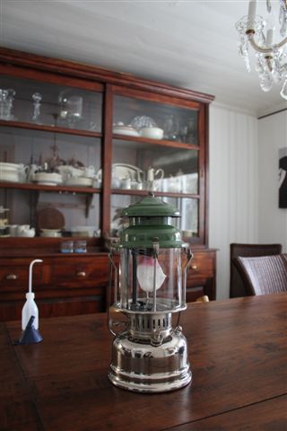

    Recently i bought my first lantern, a Primus 1020 from 1936 (code AA). I cleaned it thoroughly and today i tried burning it, but wasn't successfull. Used the following sprit: t-yellow for the reservoir and t-red for heating up. What did i do wrong, is there anybody who can inform me? Thanks in advance.

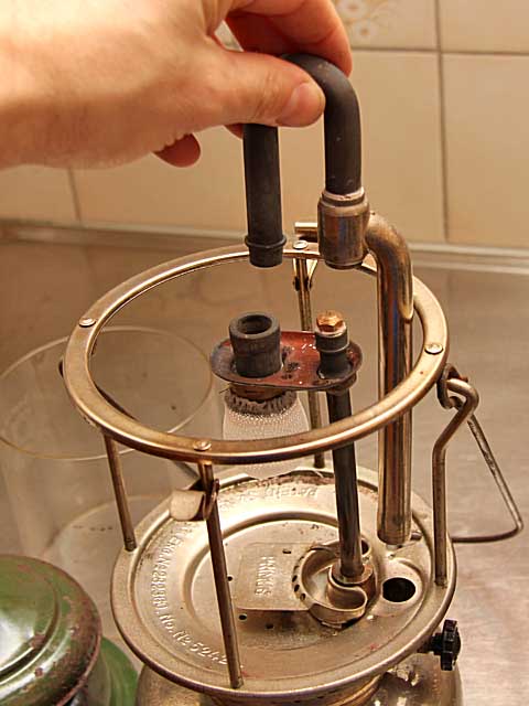

    Lift the gas- and air mixing tube up, as in this picture:

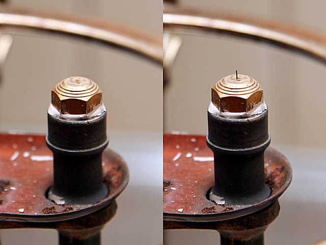

    Then you get a clear view of the jet on top of the vaporizer tube.

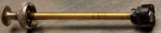

    By turning the control knob fully to the right (clockwise), you will raise the needle to protrude through the jet as seen in the right image on the picture below.
    Then turn it fully to the left (counter clockwise) and the needle shall fully disappear as in the left image below.
    Mind you, the needle is very small, and sometimes hard to see. You might be better off by just feeling it with your finger tip when manouvering the control knob back and forth.:

    Great description Christer. Nice clear pictures that tell most of the story.
