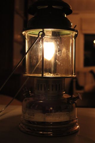

    WAUW, we tried again and succeeded!! thx for all the help, esp. Crister. Se photo (sorry but the glas is upside down)
    One question is left: we think the lantern is shining not so brite we thought is should be. Any comments?

    First, congratualtions on getting it going.
    How much have you pumped it? You should be able to get 40-50 pump strokes in them. Basically just keep pumping until your thumb hurts. :)
    It could also be because the jet needs pricking. Even with a clean lamp, when it starts and gets hot there could be some small residue that carbonises and then gets stuck in the jet. Not blocking it off, but reducing the hole.

    I was also about to suggest the pricker when it comes to your weak light.
    When a jet is starting to get clogged - and it will eventually do that, even in a perfectly running lantern - the light starts to dim, just like yours.
    Just a quick operation of the cleaning needle, and the light turns bright at an instant!
    Since you said that your lantern missed that needle, I would suggest that you'd try to find one.

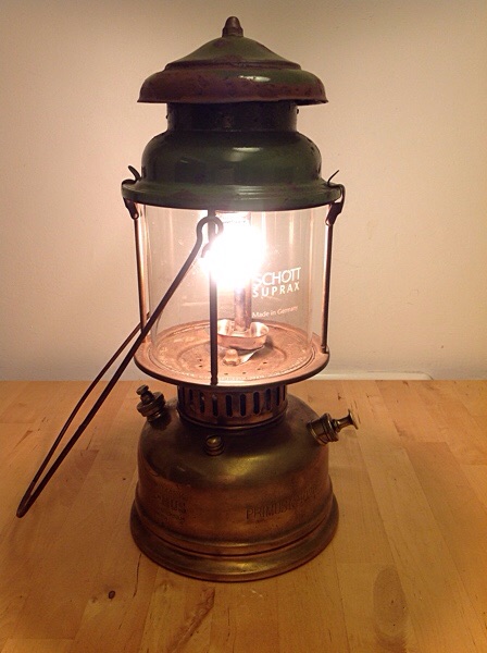

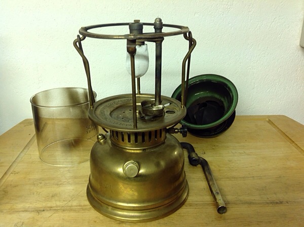

    My Primus 1020 marked AC30 won't light up properly at all. This is my first Primus and maybe I am doing something wrong.
    I cleaned the vaporizer and removed lots of carbon but after preheating vigorously I still get very, very bad flare ups. I switched from paraffin to spiritus and now it kind of burns on very low pressure (2-3 strokes) but very dimly.
    Any hints on what else I can try?
    Cheers,
    Götz

    That certainly sounds like the jet is way too big. It could even be that there is an alcohol jet fitted for some reason. At least that would be the first place to check.

    Yes, I did and the jet & pricker both seem to be pretty big. The bore of the jet is bigger than a 500CP Petromax jet.
    Maybe it is indeed an alcohol jet & pricker. What would I need to do to run it properly on alcohol?
    Regards,
    Götz
  19. Nils Stephenson
    3,409
    The alcohol conversion also included a restrictor in the end of the air tube. This was just a short brass tube with the correct diameter hole that was crimped into the end of the tube. The alcohol models that started out as such also had a short section of the cleaning needle rod that could be screwed off and a small brass mesh disc fitted that was flush with the inside of the vaporiser tube. I believe the alcohol jets had a hole around 0.3mm where as a kerosene jet should only have a hole of 0.19mm.

    With a new jet and pricker it Runs very well now. 8)

    That looks like the way a 1020 should work.
    Is the spirit cup one you have adapted yourself?
