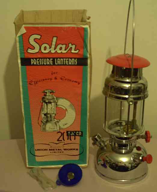

    Hi can anyone tell me anything about this lamp and in your opinion are they any good I know its a Solar 500cp but that's all I know :?:
  2. Mackburner
    Yes the tale is a whole container load or two of those was imported to the UK during the 3 day week and power cuts. Aparently they arived just after it was all over and they sat in a warehouse for years. Generally they need a clean because some of the parts got gummed up from sitting for 30 years but they are a reasonably well made powerful lantern. ::Neil::

    Thanks for the reply Neil, I have searched the net to try and find out more about these but there doesn't seem to be anything I can find? does anyone know more about them? ie age? cost to buy one? etc
  4. Mackburner
    They are early 1970s and cost around £30 then. At one time there were hundreds on sale here and most people like me have one which cost around £25 I think. There are actually some variations in them and there was also a 250 cp version sold at the same time. I have no idea what one would cost now but I suspect not much more because there should be plenty of them out there and mostly folk won't pay big bucks for Chinese lanterns. ::Neil::
  5. David Shouksmith
    Yes, a couple of characters hereabouts discovered a load of these in a warehouse 'somewhere' and knocked them out cheaply about 10 years ago. I think I've got a couple of the 250cp ones around here. I've never lit them - never felt the need to - but I suppose they're typical Far Eastern P'max clones. No doubt if I tried to use them they'd get black mantle disease in very short order... ](*,)
    Anyway, apparently the warehouse roof was leaking and half the lanterns had been ruined. These were left and could still be there for all I know...
    (Edit - just found one. The box is marked 500cp but overstamped 200cp. However, the instruction sheet with it refers only to 250cp, 350cp and 500cp lanterns. Who knows... :? )
  6. Mackburner
    I had three running some years ago and they seem to be pretty good to me. Better than some anyway. All brass construction and easy enough to fettle. The only problem I recall was the glass is bigger than a standard Petromax so is not an easy replacement. ::Neil::

    I thinks the 500 was also called the Spitfire?
  8. David Shouksmith
    Yes, mine's got 'Spitfire' stamped on the box lid.

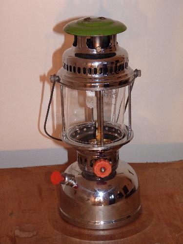

    Hi,
    I found some years ago a Solar in Australia. This Lamp has a green hood.
