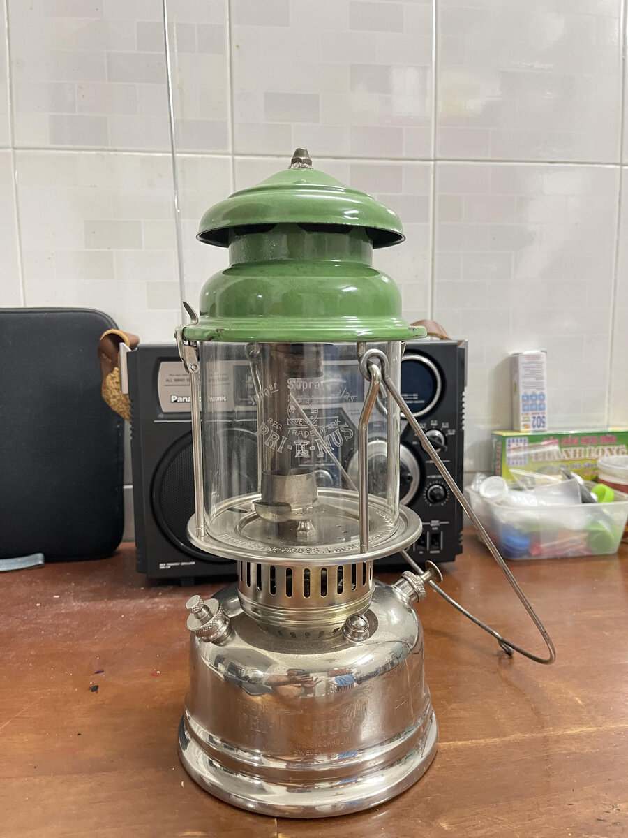

    hi there,
    I have an primus 1020. I want to find some ORIGINAL parts that need to replace for this lantern
    - Glass: 2pcs
    - Alcohol cup: 1pc
    - Needle + tip: 1 set
    i tried to look fogas.se but have no these original part
    Thanks,
    Minh
  2. outback boy Australia
    Nov 15, 2011
    268
    Gowrie juncton Queensland
    Hi, trying to find ''original spares'' for these is near impossible, especially the heating cup, other similar lamp brands have glass that will fit, but the needle and jet are obtainable from this ebay seller, regards Frank
    2 pc of needle and 1 jet for Primus 1020 lamp | eBay
  3. txminhcoke Vietnam
    Sep 20, 2019
    40
    vietnam
    Thanks Frank.
    Lantern has been restored completely. Date 1934
    Thanks

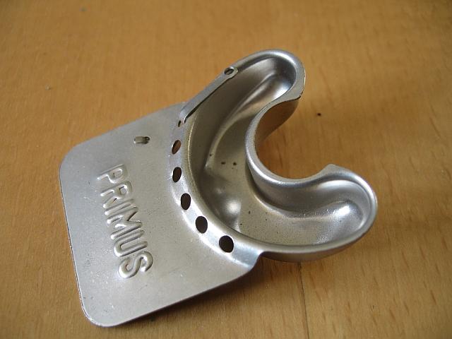

  5. Nils Stephenson
    3,396
    As Frank writes, finding original parts for this lantern will be difficult. Usually it is only found on other lanterns and not many are being broken up for parts.
    The glass you show on you 1020 is correct for the year. The spirit cup is actually from a later period. The one you need is this type.
  6. txminhcoke Vietnam
    Sep 20, 2019
    40
    vietnam
    Thank Nils,
    i can find one more pre-heat cup that is same your picture, But i like this one
    Thanks
  7. Pancho
    Pancho Subscriber
    Nov 26, 2019
    514
    México
    I need to find one of those cups for mine
