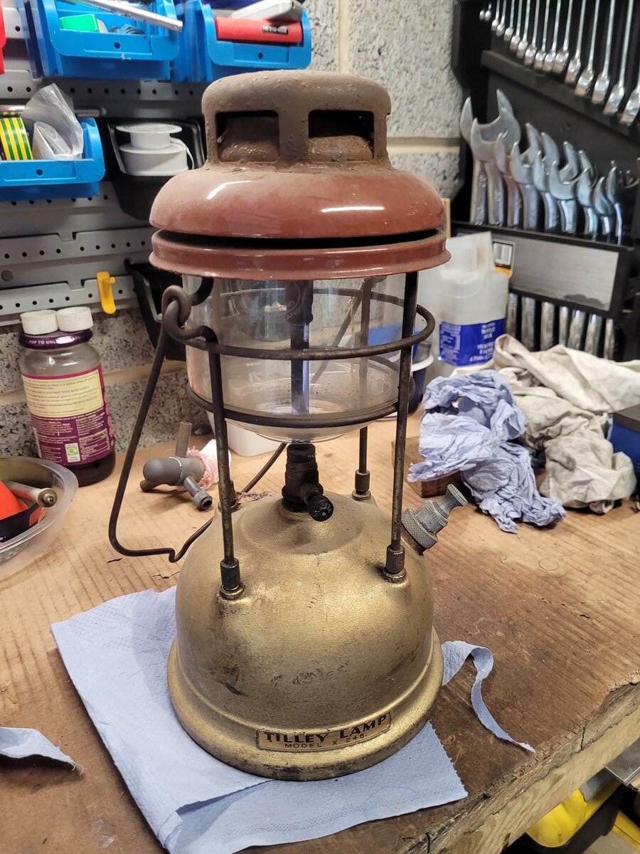

    I had to put some stuff up in my loft, so I took a look in the box of old bits up there.
    I found this 246 looking sad and neglected, I already restored and painted my old camping 246 so I decided just to clean and re seal this one to get it working and a bit cleaner but leaving its knocks and scrapes.
  2. Fireexit1 United Kingdom
    3,536
    Looks just fine to me ! The garden needs lighting...

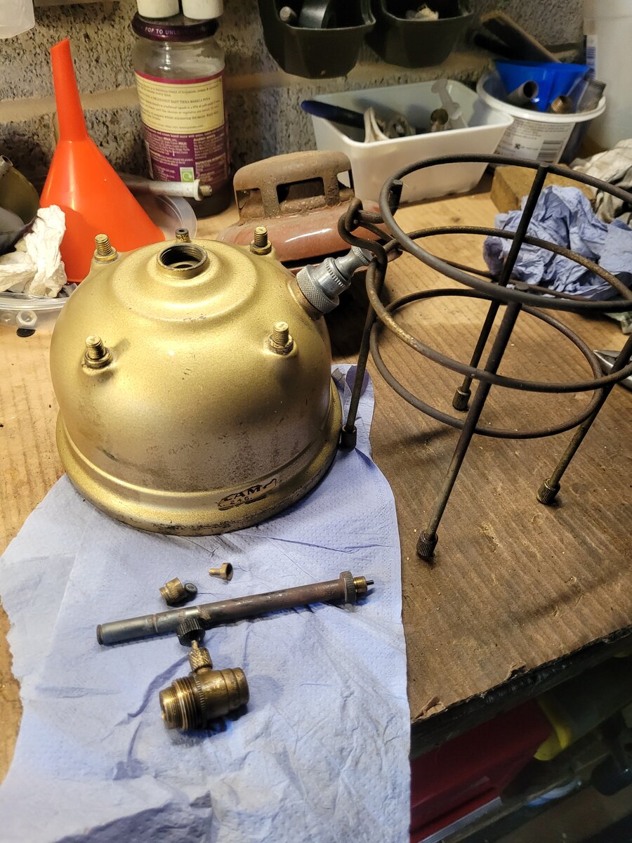

    Started to strip and clean it, the paint but the transfer on the bottom was loose and flakey, may replace it later.
    The control cock seems reluctant to come apart so I'm soaking it in parafin, and there wasn't a spring in the bottom section to push the stop valve seal up.
    Don't like the aluminium pump though, I'll have to get rid of that.
    Wish there was a reasonable price source for the brown hats.

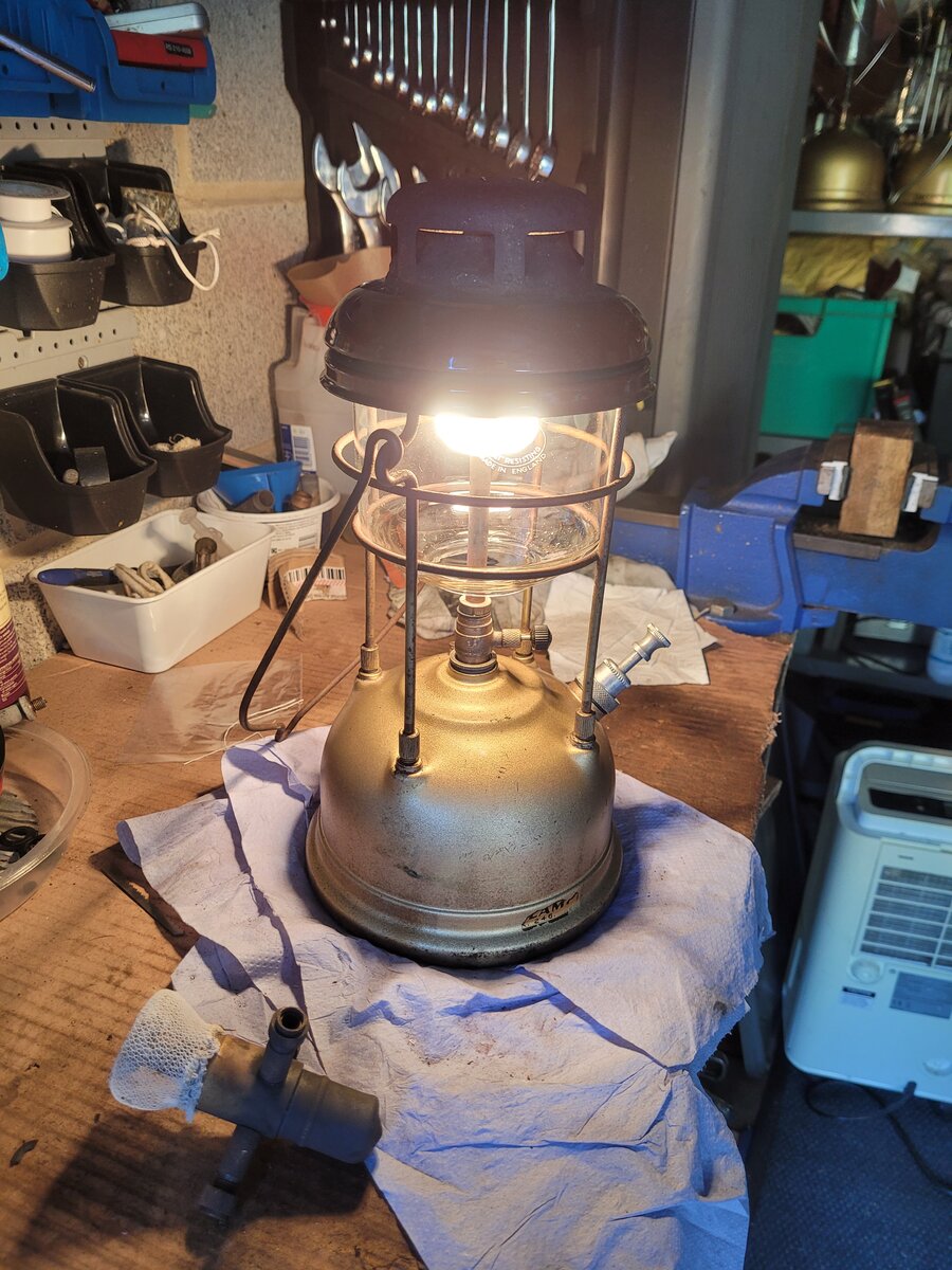

    Gave the cage a bit of a wire brush, and wondered if I should get some gold brake caliper paint and treat it to a coat.
    I decided I would like to see it running first so I looked through my tilley box and found some seals then put a washer on the pump and pumped it up, left it overnight and still had pressure. I chucked some stainless steel nuts in the tank and some paraffin, gave it a good shake up, then emptied it out.
    Cleaned and blew out the burner, then fitted a mantle.
    So I fired it up, it was lovely and bright , but after about 3 minutes it was much dimmer, and I noticed the dome on top of the burner was glowing red.
    So fitted another burner I had in my box.
    Now it seems quite happy, I will be replacing that pump when I source one, may paint the cage, and treat it to a new transfer on the bottom, but I kind of like it as it is, rusty hat and all.

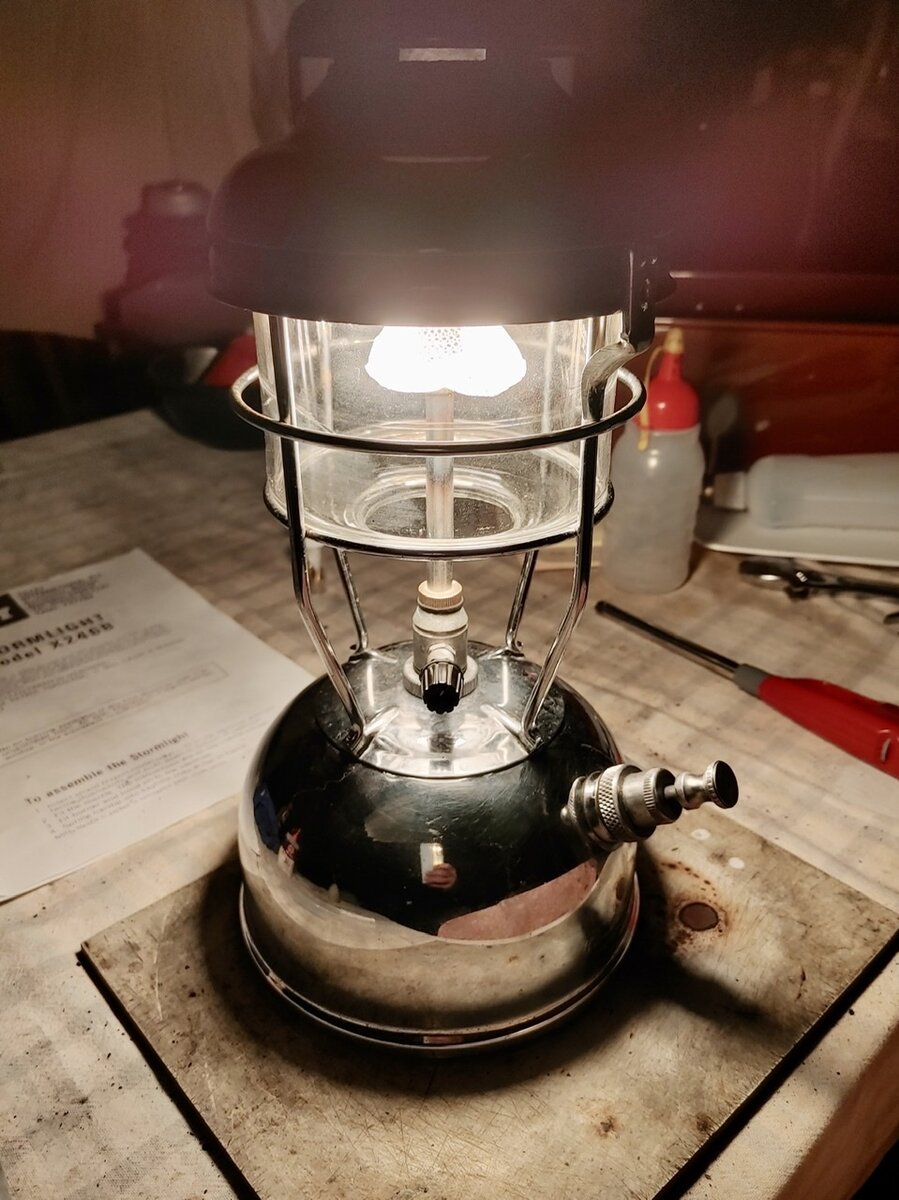

    @rayw, vaporisers are areal problem. It’s pot luck when buying new ones from Tilley.
    Here’s my x246b running on my third of three vaporisers I bought recently.
    The other two just didn’t work.
    I guess the other two Tilleys i have will just sit there until I can find a different source.
    I have the Taiwan version on order but I’ve resigned myself to admitting Tilleys and me don’t match.
    Good to see you got it working.
    Cheers,
    JohnL

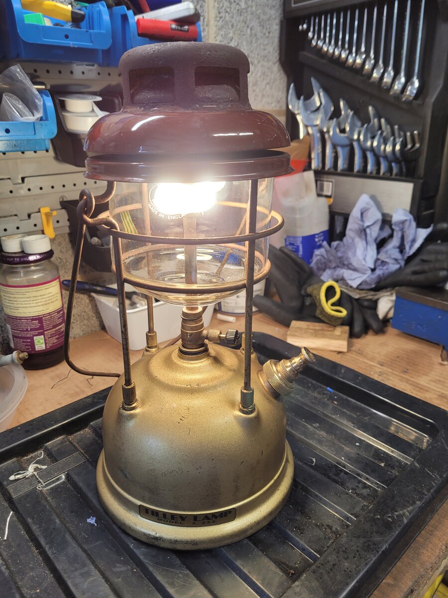

  26. rayw United Kingdom
    Sep 13, 2020
    457
    Back to the subject, thanks to the kindness of @Jean J the old lamp now has a brass pump, which looks much better, and I decided to treat it to a new sticker.
    It's nice to see it looking its age but working well, im happy with the result let's hope it's preserved for another generation.
