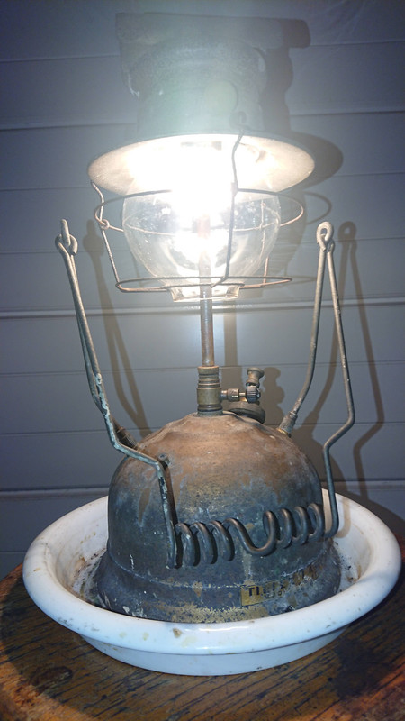

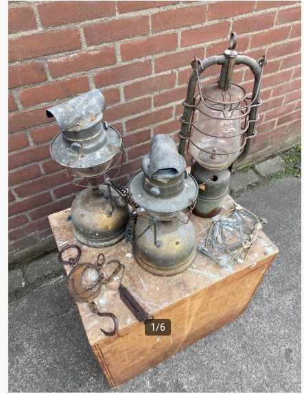

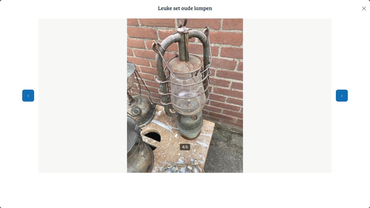

    Just bought two Tilley PL53 lamps, not that common, but there was one lamp more in the lot.
    Look at the picture and tell me, is it some sort of homemade or is it original from some brand?
    It is carbid as gas but the upper side is obviously from a kerosine lamp.

  2. vissertw
    vissertw Subscriber
    Jan 9, 2016
    92
    Wormer Holland / Strömsdal Sweden
    Hereby a picture pf the whole lot I bought.
    [​IMG]

    Carbide lamps and lanterns were made in several different styles, so in my opinion your lantern is genuine.
    The Tilleys appear to be from the 1940 to 1945 period, happy fettling.:thumbup::thumbup:
  4. Toronado Germany
    Jan 13, 2022
    42
    Bavaria, Germany
    These carbide lamps were manufactured by Friemann & Wolf and by Riemann using the upper parts of Feuerhand lanterns. I think yours is a Feuerhand FH 201.
    Best regards
    Roman

  7. Jörg Wekenmann
    Jul 11, 2021
    243
    Hello Ton,
    The storm carbide lantern you are showing is from the Hermann Nier company in Beierfeld, Saxony.
    At least the upper part is from this company. The carbide base was manufactured by the Riemann company in Chemnitz, which also assembled these lanterns.
    These lanterns were available for purchase starting in 1939. Petroleum for private use was increasingly restricted, but carbide was still freely available on the market.
    Best regards,
    Jörg

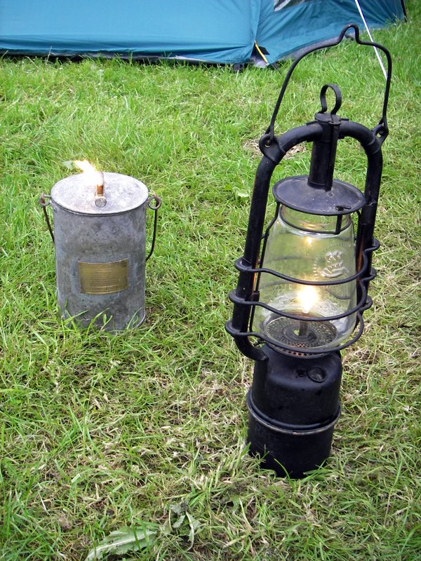

  8. presscall
    1,768
    Lancashire, UK
    @vissertw
    Mine’s made by Riemann, Germany, Feuerhand superstructure and glass. Certainly a factory product and not home-made.

    Hello, it took some time but now the first of the two PL53´s is shining again.
    The other two still in the waiting room.
    "You should resist the desire to polish them which is a common mistake made by some, er, restorers... =; [-X"
    Is it OK for you this way David?
    [​IMG]
    Regards,
    Ton.
  23. vissertw
    vissertw Subscriber
    Jan 9, 2016
    92
    Now that he or she is burning for several hours, I noticed the pressure nipple is working well too!

  24. JEFF JOHNSON
    16,624
    It's working well and yes, it sometimes takes a while for the pressure indicator to start functioning again after a lamp / lantern / heater has not been used for a long time.

    Tony Press Ukraine Subscriber
    11,036
    I always put a drop or two of oil down the pressure pip. It seems to help them re-function.
    Also, I’m awaiting David’s response…
  27. David Shouksmith
    That was specifically regarding the matt chrome hood rather than the entire lantern!
    Well, you've clearly resisted the temptation to polish the hood and the lantern is burning well - great job! :D/
    ...and now you have it! :lol:
