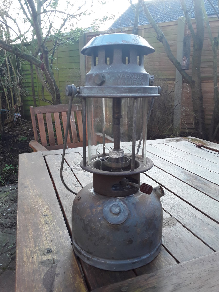

    Arrived early January, but I've just got around to posting it:
    Rapidal Grey, steel tank with pip, all steel frame, glass with hole
    No date marks, but I'm guessing early 1945 .
    Looking at the condition of the inside of the hood, the burner and the pricker wire, it's only been lit once or twice, then left to rust...
  2. ROBBO55
    4,452
    Good find. It should clean up nicely. :thumbup:
  3. Alex74
    Oct 13, 2019
    516
    Faringdon, Oxon
    Beautiful. Are you going to leave the original paint on?
  4. steerpike451
    Jun 29, 2016
    183
    Norfolk, UK.
    Sadly, there's none of the original paint left on the frame, and only about 5 to 10% left on the tank (although quite a lot of the tinning survives), so once I've treated the rust I'll have to repaint.

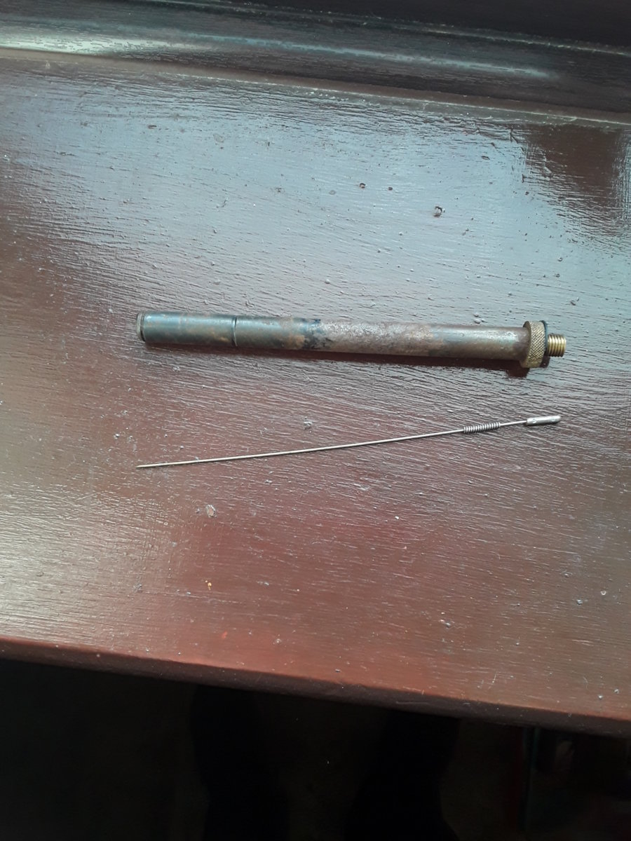

  12. steerpike451
    Jun 29, 2016
    183
    Norfolk, UK.
    Update: I was looking over the bits to assess them for cleaning, tried to blow through the pricker control- blocked! Had a poke with some 3mm wire rope, and found bits of solder coming out...
    To cut a long story short- desoldered the pickup tube to find the bottom part of the cock blocked solid with solder, probably due to a mistake in manufacturing, which I drilled out carefully and resoldered the tube.
    Looks like the lantern came from the factory defective and has never been successfully lit...
  13. george
    That's why it appeared to be used very little or not at all. Made for the military and if it didn't work they just threw it in a corner and forgot about it. :-&:-k
  14. steerpike451
    Jun 29, 2016
    183
    Norfolk, UK.
    Yeah it probably explains that little mystery...

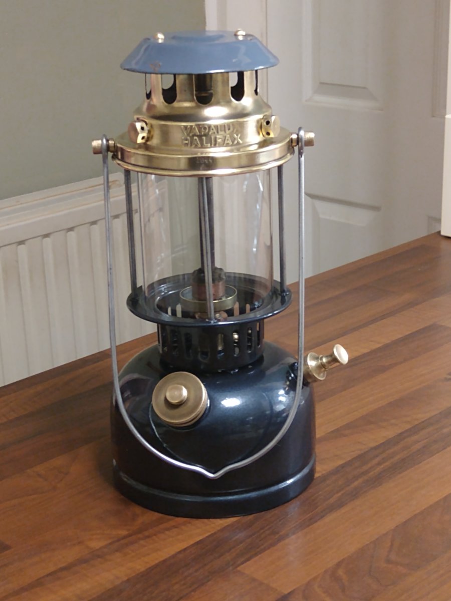

  15. paparazi
    Oct 23, 2016
    434
    Nottingham UK
    I just hope you are as pleased with yours as I am with mine...good fettling. IMG_20200217_210542798.jpg
  16. george
    Beautiful example, well done!:D/
  17. AussiePete
    @paparazi
    Wow, that’s one nice looking lantern. Well done.
