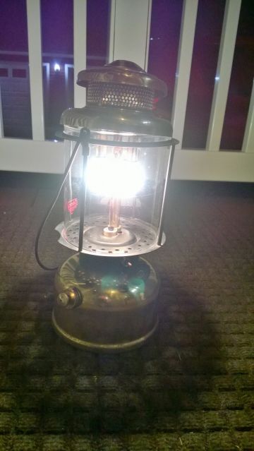

    Years ago I inherited what I believe is a Coleman 427 quick light, made in the early-mid 20s.
    I have a bunch of kero wick type lamps, but no pressure lamps, so my knowledge base is not very deep.
    It’s in fairly decent shape, no major outside issues that I can see, although I’m assuming that all the seals are bad.
    What type of fuel does it take?
    Where can I find replacement parts?
    What else do I need to be aware of?
    Thanks in advance

    Sorry no pics tonight
    A little more info:
    It has the long exposed plunger assembly like you would find on a 427
    the base is marked under the filler cap: Coleman Quick -Lite, Trademark and a small 5 3 below that.
    It's in pretty good shape, no major rust or issues that I can see.
    Is this thing worth restoring and made operational?
    V/R
    Mike

  9. Mackburner
    Made in March 1925 then which is early for the model. Certainly well worth restoring. ::Neil::

    All
    Thank you very much for the replies.
    My guess is that it hasn’t been fired up since the 50s, my dad had it up at his ranch in So Cal high desert. I found it after he passed away.
    So where can I get repair parts for it? Also is there a schematic for parts breakdown?
    Will current Coleman mantels work in this?
    On a separate note, will standard Coleman mantels work on Petromax type kerosene pressure lanterns?
  11. JEFF JOHNSON
    16,886
    Hello Mike, modern Coleman mantles will work, but they are not so well made as the old mantles, Peerless mantles are good and that lantern runs on Coleman fuel.

  12. JEFF JOHNSON
    16,886
    Large Coleman mantles (number 1111) will work on the Petromax type of lantern, but it's better to use a more bulbous mantle, i often use Anchor mantles.
  13. Cigarman
    Cigarman Subscriber
    Aug 23, 2014
    149
    Specifically the Peerless 2C-HG is the one made for coleman types of that size. I use them on mine and they are as good as you could ask for.

  14. Mackburner
    You are not likely to want any parts other than maybe a new generator. Maybe the filler cap seal and the pump leather will want replacing and you need to check the valve gland seal is OK but that will probably be good and may only want tightening a little. However these lamps commonly just work without anything other than a clean out of the tubes and tank.
    Coleman #20 mantles were the original type used on these twin mantle lamps but the standard Coleman #21 or an equivalent will work fine. If you have to go buy then Peerless as suggested will likely be best. ::Neil::
