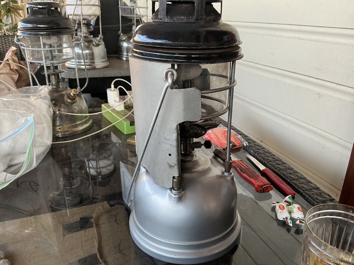

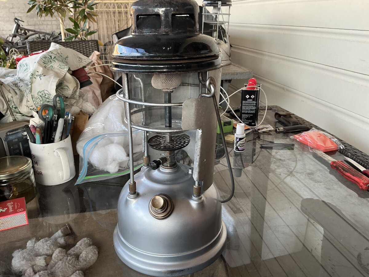

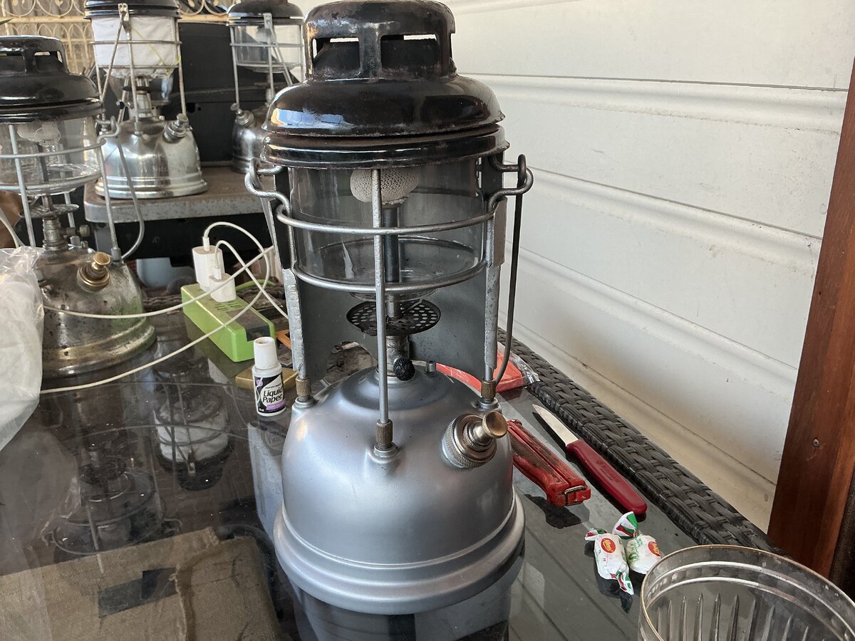

Hello everyone. I have enjoyed many posts here for a few months, and learned a lot along the way. My father, 92 years, took a bad turn, a stroke just before Christmas 2025. He has recovered and doing well. I thought about his old Tilley lamp hanging in the shed, something he will never fix himself. I remember him having it on Rottnest Island in the 70’s, spearing cobbler and flounder in the shallows at night. Since then it has been to Tasmania, then South Australia….never lit as far as I remember. So I got it home and started watching everything I could to help me understand and repair this old lantern. I bid on a few Tilley lamps for ‘spares’. I ordered some seal kits. I bought a preheater. I bought kerosene and meths. The burner was bent oddly, and I also damaged it getting it apart. The domed part I mangled a bit. The steel insert inside it snapped off. So…new burner ordered. I cleaned, heated quenched and polished the generator. I tried polishing the fount but it was the speculum plating, suffering the green patchwork ugliness. I decided on paint. The ventilator was in poor shape, enamel chipped off and rusty. Exhaust paint is what I used. Anyway, I did the best I could. Her it is ready to give back to him tomorrow night. It lights, holds pressure, and I have run it for 8 hours twice already. The ‘reflector’ was on it, and always has been to my memory. I think he made it himself, back in the day I knew absolutely nothing about kerosene or pressure lanterns before this project.
