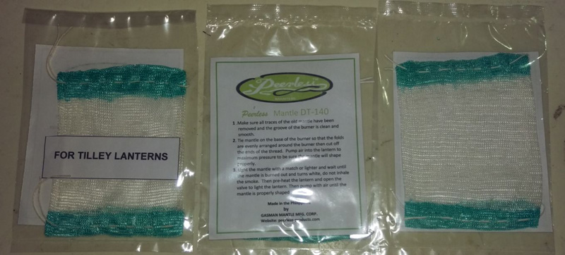

    Got the new Peerless DT-140 Double Tie mantles today.
    The construction is similar to the Peerless 111 but with a draw-string on both ends, and should be suitable for a wide range of lamps including, but not limited to, Tilley, Vapalux, Bialaddin, Primus 1001 series, etc.

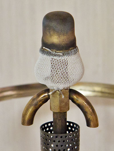

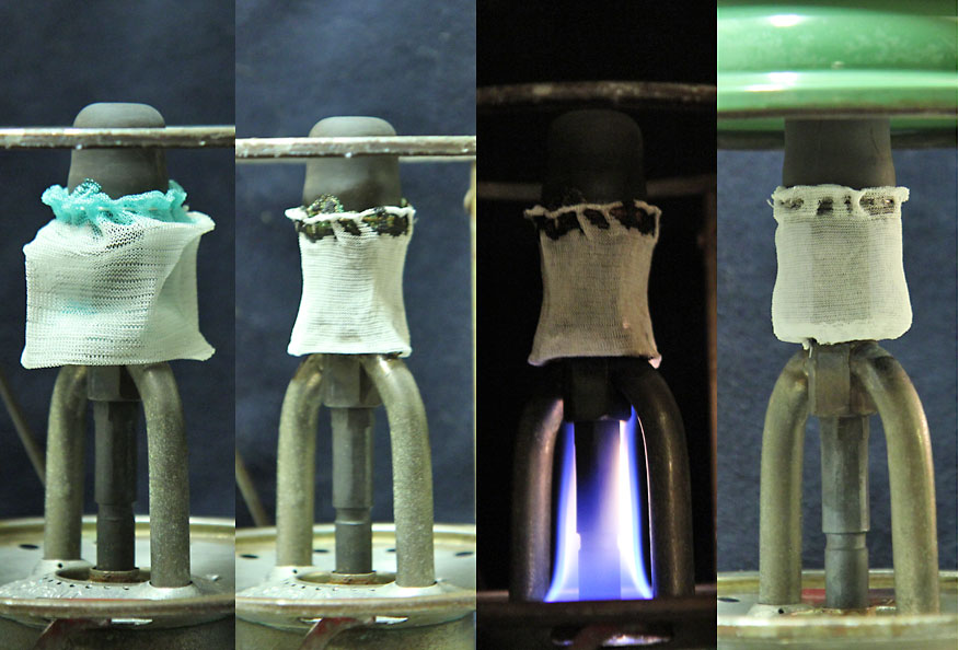

    Phil most kindly sent me ten of these DT-140, and I just tested one on an old Primus 1015.
    I decided to take this one since it is such a good runner:
    So even if it already had an extremely well working mantle, I just had to sacrifice it for the test.
    But before removing it, I wanted to take a picture of it lit so I had something more impartial than the human eye and memory to rely on.
    The camera was of course in manual mode in all aspects; shutter, aperture... you name it. And of course with a fixed white balance.
    I also tried to keep the same pressure by pumping just as much in both cases and keeping the same initial fuel level (fuel/air ratio) in both cases.

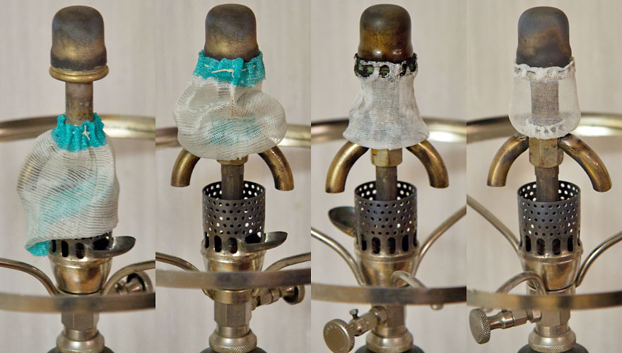

    But firstly the tying.
    Phil recommended to sort of invert the mantle at the lower tying point, i.e. tie it with the inside out there, and then back it all up and tie the upper part.
    I found this to be a good advice, because if you just tie the two points directly as positioned when the mantle is slid straight over the burner, much inner volume will be lost, so to speak...
    You'll figure it out once actually doing it. :lol:
    So here is a combined picture showing the different stages from the "inverted" tying at the lower end, the upper tying, the pre-burnt mantle and finally the pumped-up and cured mantle:

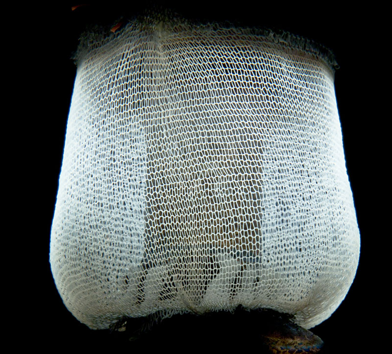

    As seen in the last one, it is perhaps not as bulbous as we are used to.
    This is what the old, generic double-ties looked like just before I removed it:
    But the DT-140 don't look bad in any way.
    It's evenly shaped and smooth.

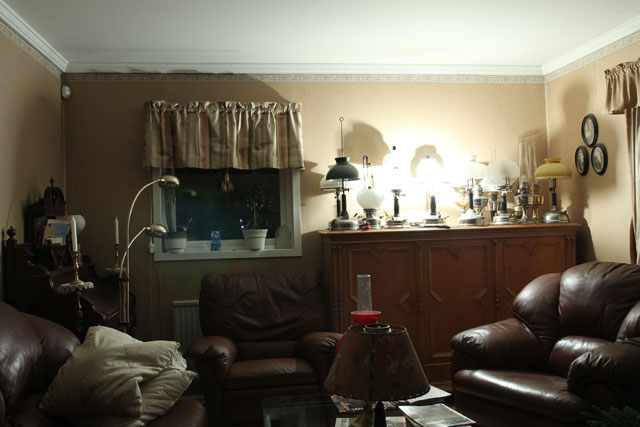

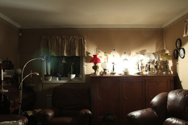

    Still... what we really are interested of is performance, right?
    Old, generic mantle without the shade:
    Peerless without the shade:
    Seeing both live, I found the Peerless to be the better.
    And hopefully these pictures - with all camera settings fixed at the same - will confirm that.
    It is a stiff bastard as usual with Peerless. The fabric they use is still like plastic.
    That is seldom a problem with a single tied sock mantle, but at a double tie like here, it is a tad bit awkward since you normally want to stretch it out from the burner and shape it as well as possible before pre-burning.
    It looked a bit too askew directly after the pre-burning, but a good initial pressure pumped it up fair enough anyway.

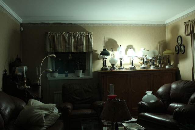

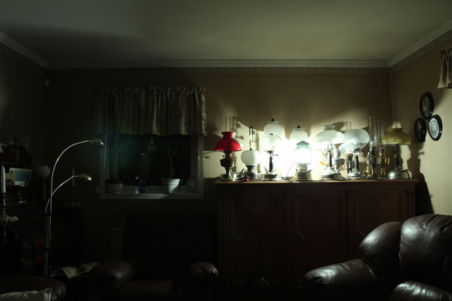

    I tried the second mantle on a lantern; .
    Firstly I took a picture with the old and perfecty well working mantle, again with all settings fixed on the camera, and with the same amount of pump strokes etc.
    As I said above, I would try this one tied the more normal way, and actually I think it worked fine.
    Tied, preburned, preheted and after an hour of action:
    Again, the Peerless looked more shapeless, straighter and less bulbous than the normal two-tie, but the light output is absolutely better.
    The two pictures below is of course taken with the same camera settings in all ways and the lantern with the same fuel volume and pump strokes, etc.
    The Peerless is shown in the second picture:
    Strangely enough with these Peerless, they give a tad bit warmer light. Normally Peerless give a colder (read whiter) light close to 3500-4700K, but these look more like around 3000 to me.
    Which suits me even better. I'm not a fan of cold light.
    It's just in peoples head that a colder light is the same as a better light output.
