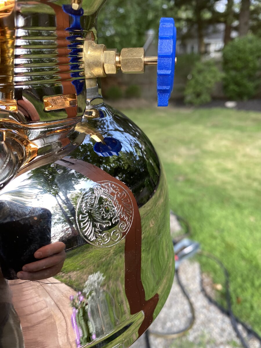

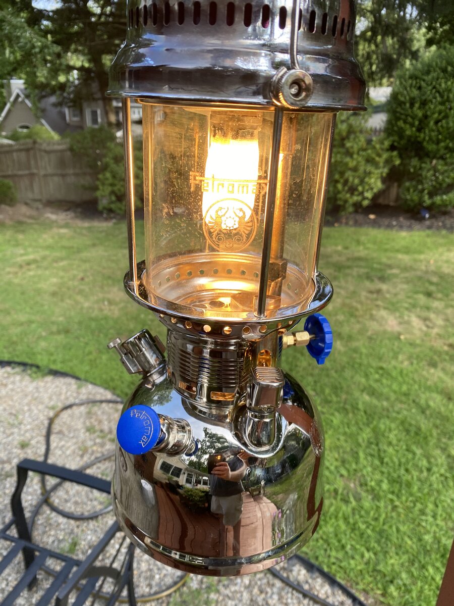

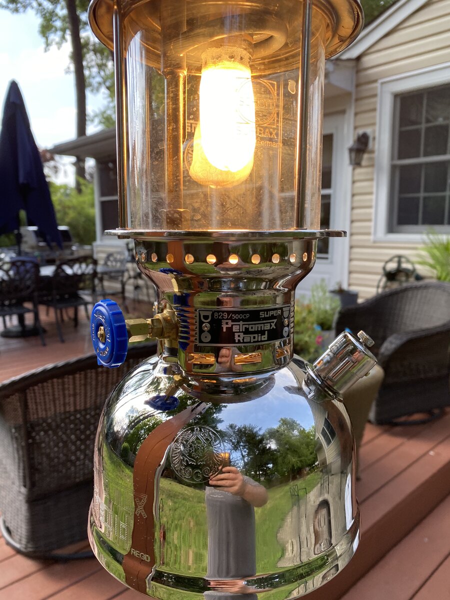

    Pics
    BAE99EE3-B2AB-4D27-AEF9-F773CAB62DC9.jpeg 2566F6A2-6954-4AA6-9380-C88A69A79931.jpeg 39F90FA9-B623-4A7A-AD5E-0BD800CEE50D.jpeg

    This lantern maybe is from Pelam, a company founded by Jonas Taureck, who bought the brand name some years ago. At least some of them are/were assembled in Germany from parts imported from China.
    Pelam sells all kinds of outdoor stuff under the Petromax brand name.
    However, the quality is unfortunately not as high as from the lanterns that were made by Graetz in Altena/Germany from the 1950s on, or from those made by Casa Hipólito in Torres Vedras/Portugal from the 1970s on until the 1990s.
    Nevertheless, with some thorough servicing from time to time they can be reliable workhorses. Have fun with it! And be careful: they tend to breed somehow and become more and more!
  22. george
    Unless it specifically has stamped on it “made in Germany”, it’s not an original. The newer ones have a serial number on the bottom of the fount, and it usually has “German reg.” stamped on it.
    Never the less I think you will enjoy your lantern!
    :D/
  23. WimVe
    3,523
    The blue plastic and angles of the cage and hood give it away: modern China made.
    Iit also bears the Graetz monogram. I wonder if that is legal at all. I never have heard Pelam did own the Graetz logo (Bildmark) too.
    Maybe you know it but it is on or off, nosewheel down/up.
    You can not regulate the light.
