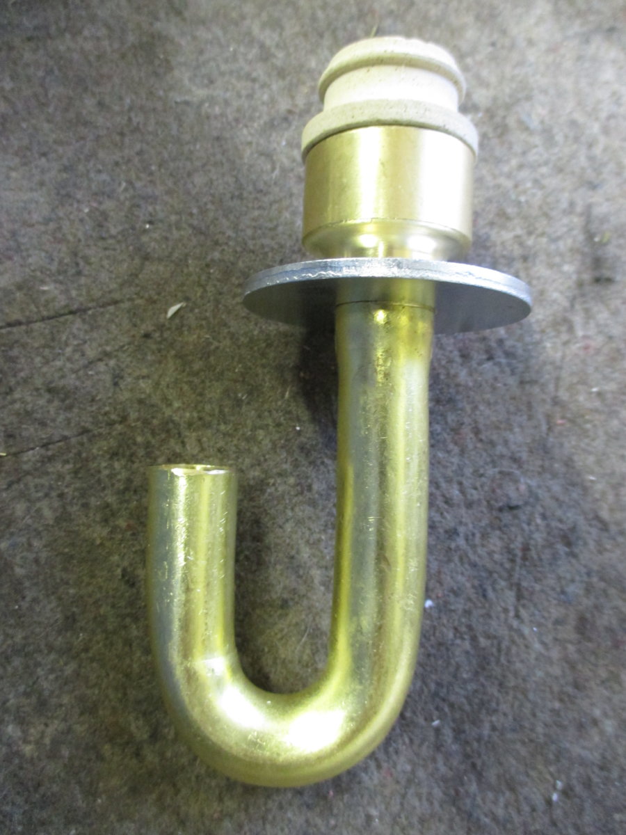

    Today I got home and in the mail was a box, it was from Pelam in Germany and it had this inside
    Now the back story is a few weeks ago i took a pic of my mixing tube right after shutdown it was a deep red color..

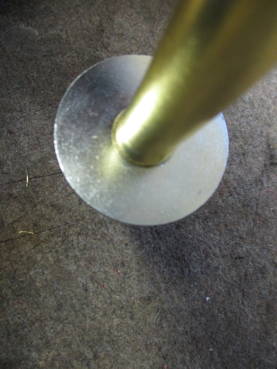

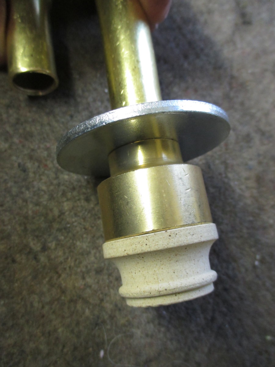

    I sent the picture to Petromaxs facebook (as i thought it was a cool looking pic)and they said something was wrong, it should not be red and sent me this as a replacement... There is this 3mm thick washer, threaded to match the tube and installed as seen. There is also no "mixing paddle" for the fine tuning which from reading, is very hit or miss anyway
    Thoughts on the washer? None of pelams or petromax's stock pics show a tube like this.

    Looks like a simple solution to just deflect a bit of heat. My ceramics glow but not the main tube as it should get cooled slightly from the incoming fuel/air mixture.
  3. MYN
    Getting a red hot/glowing flame spreader/lower mixing chamber or whatever you would call that and a ceramic burner after running a hot lantern is quite normal and there's nothing wrong with it.
    However, you should NOT be getting the J-tube mixing chamber red hot even after hours of burning. If so, something's really not right, which indicates back burning within the mixing chamber.
    The new design from Pelam looks interesting. Normally, the heat deflector/heatsink is in the form of a shallow, inverted steel dish. But that's for earlier designs with two flat nuts securing the J-tube to the inner hood. Later Petromax designs do not have that.
    Well in my opinion, the dish serves to deflect the rising heat from the mantle towards the coil of the Preston loop as well as away from the J-tube.

    So you think that a "washer" will keep the heat away ?
    The amount of heat produced will heat up anything that is in the way up.
    Like said, glowing is normal as long as you don't get a backfire. But you wll hear that for sure.
    Btw: the flat ring (aka washer) will heat up the bridge it the inner hood faster, since it has more contact surface.
    That is the reason why the "old guys" used a concave form, to minimize heat transfer contact.
    Btw2: its not your mixing tube that is glowing red hot but the burner head. As far as the picture shows.
    Would be nice if you can experiment with the different set ups: no disc, washer, old cup disc.
    I do see that there is no mixture screw on the new J-tube. So I guess that the noise would be less.

    I use this style of dish above the mixing chamber a lot, in many PX lanterns.
    In German Pelam forum it's called 'Staukappe'.
    The effect of it is to deviate the flow of uprising burner exhaust gas further away from mixing tube.
    And as air is an excellent thermal insulator, the gap of increased distance from hot exhaust gas to the tube does the trick.
    Tube and chamber stay cooler. No red glow.
    You can cut such plate/ring from cans of tin , and with a radial cut , you mount it even without disassembling anything.
    Must see if I find a photo of this.

    thanks for all the input! I'll install it and give it a whirl!
