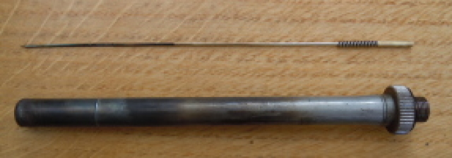

    The pricker wire was fitted inside but it had a bend of maybe 20 degrees at about 1/3rd the way up. How? Straightened that easily enough. Reasonable pressure on the brass end would not make the pricker tip appear through the jet... No point fitting that yet.

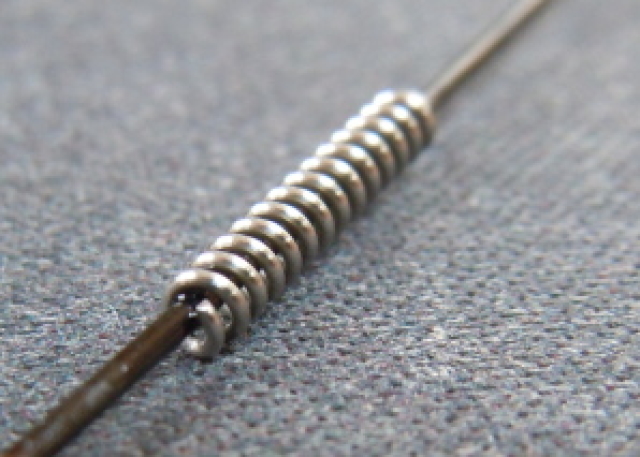

    If the spring was removed the pricker alignment with the jet was fine and the length appeared correct. In some orientations with the spring fitted it was just possible it would all work but at other times the spring jammed it in the barrel. The spring was the same length as the others I have so I concluded it must be the ends of the spring catching where they had been cut.
    I squeezed the ends with pliers so they were inside the spring's major diameter.
    In hindsight this has a double benefit since the spring tends to catch on the weld between upper and lower parts and that helps withdraw it from the barrel. I have had the spring get stuck in there before.
    By now I had an assembly that worked nicely - this is how it should have been out of the box.

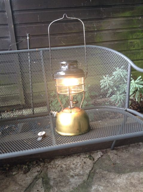

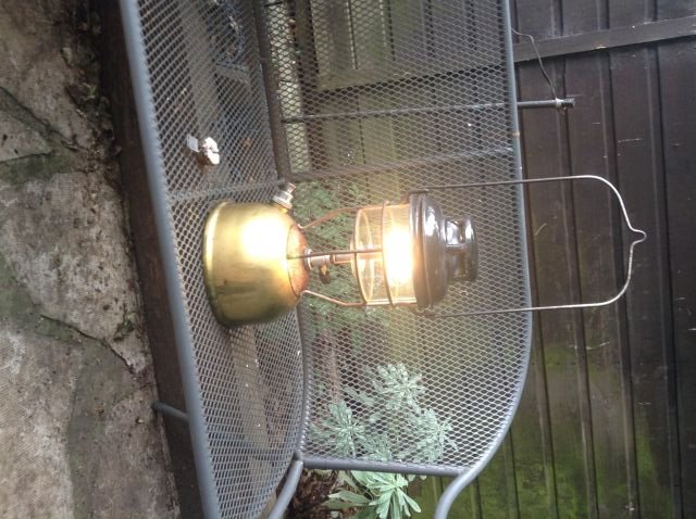

    I fitted it to the lamp which lit and ran perfectly for 4hours last night. It needed only a single prime and I only worked the pricker a few times to prove it's action. I'm happy so we'll see how long it lasts.
    Here's how it looks after running in.
    I conclude that these work but don't just slap them on without checking and fettling them to the lamp first.

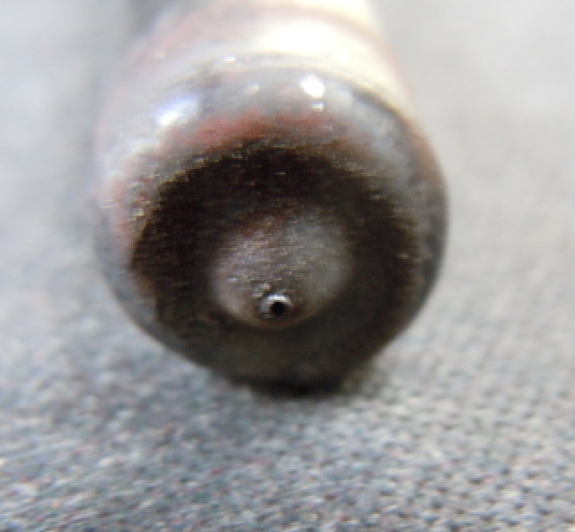

    It seems like it's quite thick gauge material. They have stamped the "pip" and then ground the face of it flat by the look of it. Whether the hole is drilled, or it just appears during the grinding, is hard to tell.
    I wonder if you can spot in the picture above a small rim around the jet hole? I was suspicious of that when I took the picture. Last nights light up proved I was right - big yellow flames - horror!
    The pricker has done it again, it's enlarged the hole. :rage:
    I suppose this happened when I shut it off using the control cock. The pricker was raised while the jet was still very hot. Perhaps the inner wire expands more than the outer? Maybe the metal at the jet edge is very thin (result of the grinding) and it is soft when hot?
    I'll never know but I think if i had just released pressure to extinguish this would not have happened.
    I peened it and lit it again. I removed ~0.5mm from the pricker wire length too so hopefully this can't repeat. It ran a bit rich. The flame was contained inside the mantle but the light was not as white as I would like. Starving it by raising the pricker was a big improvement. The jet needs to be smaller.
