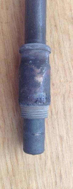

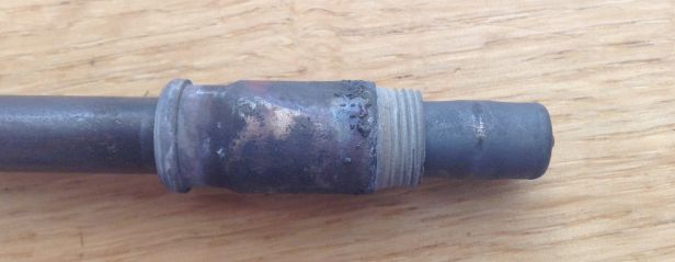

  2. JonD
    JonD Subscriber
    Apr 15, 2014
    1,012
    Hertfordshire, England
    Dear old X246B has found a new way to taunt me.
    The vapouriser has done at most 6hours after the decoke. Last night it began to dim again. That seemed a bit soon. Investigating the top would not come off. Spigot stuck on vapouriser.
    Humph! Not pleased.
    I can get it out all right by squashing down the bulge but I reckon it's dead now.
    I'll use the cleaning wire from it (which is OK) in the other body I have and see how that fares.

  4. JonD
    JonD Subscriber
    Apr 15, 2014
    1,012
    We really need to talk PB!!
    Tonight I have just posted elsewhere about about my sad X246B... It has been through two of the new Vaps. Why??
    I want to understand what happens. If it's down to the fuel - how come?
    I'm thinking it's about the temperature of the vap tube up near the burner. Too hot and it balloons up perhaps?
    Why it is too hot is another question. Thin gauge material or not enough contact with the spigot to remove heat? I don't know.

  10. JonD
    JonD Subscriber
    Apr 15, 2014
    1,012
    Hope your 606 works OK.
    I still think mine probably overheated.
    I have sawn the end off it now leaving about a 2" stump of the bottom. I plan to convert it to running petromax jet and needle when I can get access to some machining tech.
    At some point I was planning to section the bulge to see what went on inside. I might do that today if time permits.

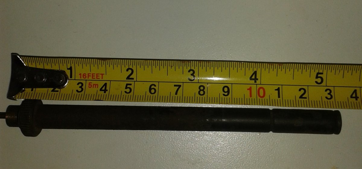

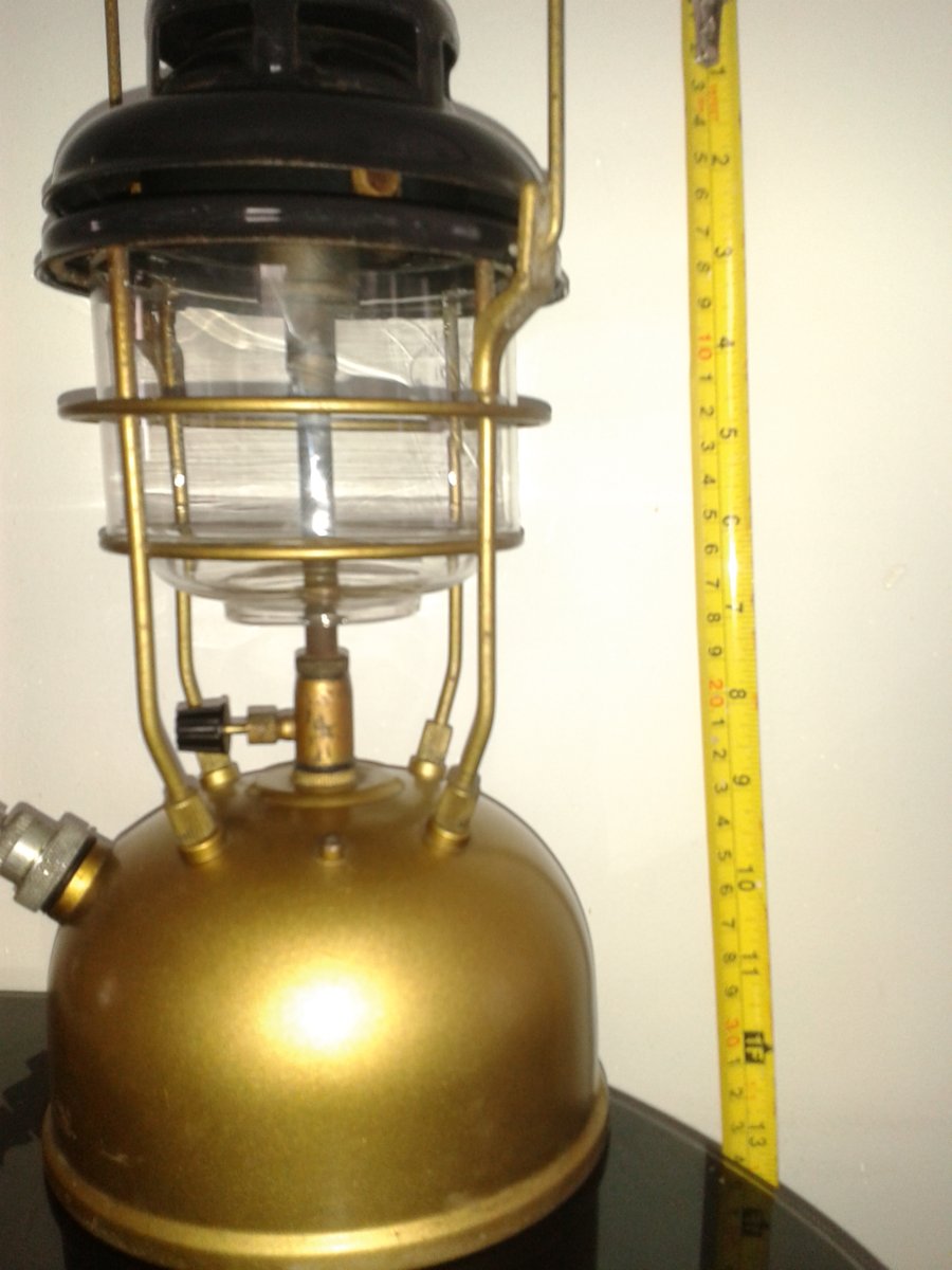

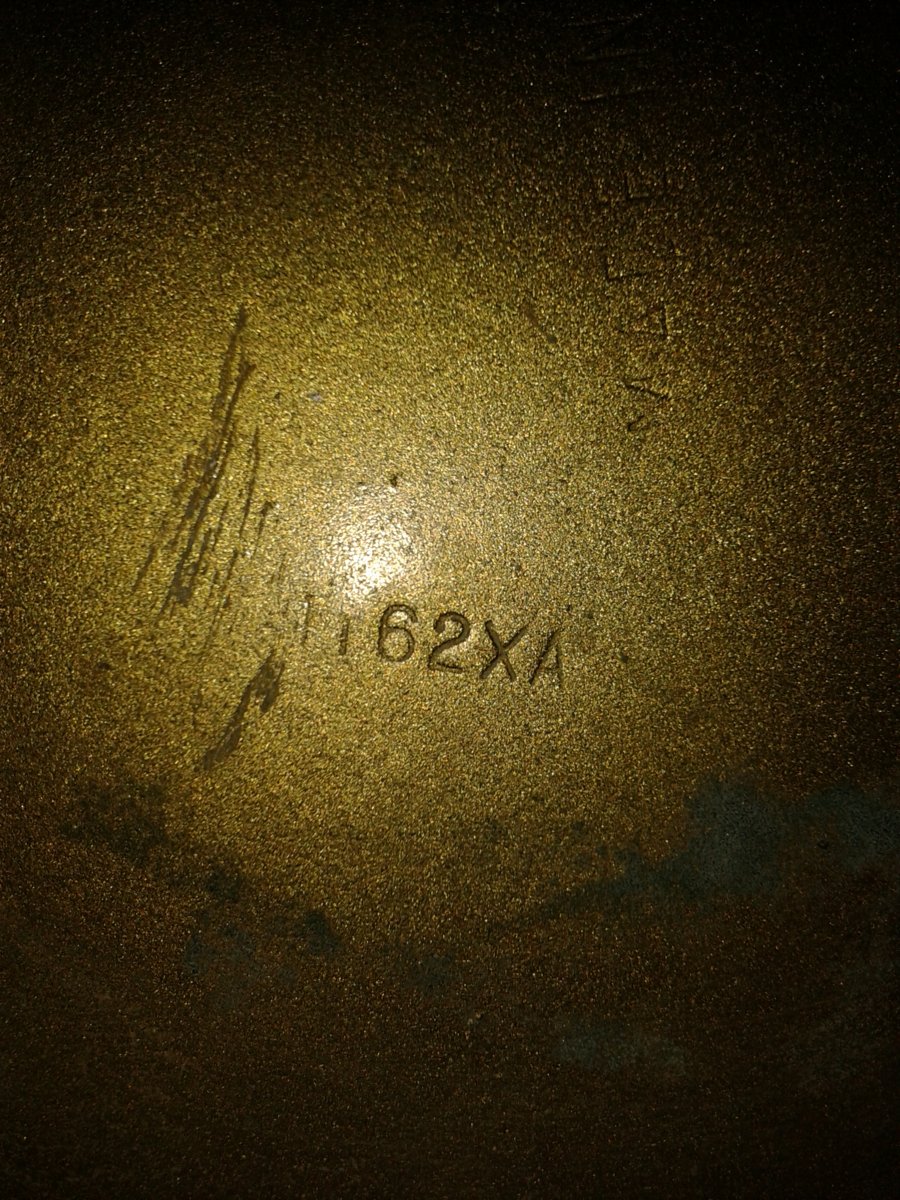

    Hello all,
    I've just been given a X246A from 1962 that needs a new vapouriser. On the Tilley website it suggests a 7" one, but the one from my lamp iscloser to 5 1/2". II've sent a message to them asking about this but I've not had a reply. Does anyone here know which one I should get and, in light of the above conversation, where from please?
    Thanks in advance.
  14. Tony Press
    @60GT
    It's the 5 1/2 inch one. The No.606 vapouriser.

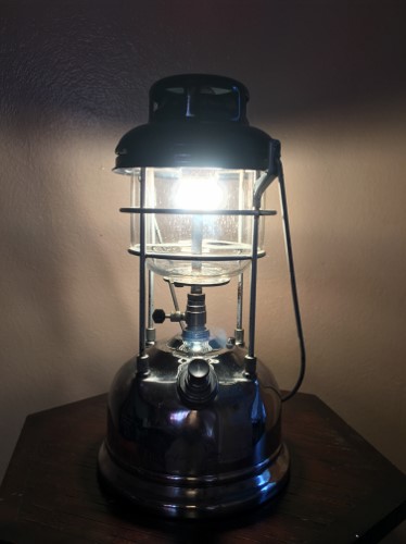

  15. Hanzo
    Feb 2, 2016
    574
    I just put a new 606 from Tilley on my X246 and its working fine. Only about 3 hours running time with it but no problems at all.
  16. 60GT
    May 10, 2017
    11
    Gosport
    Hi Tony,
    Thanks for the reply. The information was on the Tilley website......
    Vaporiser - 7inch and it says '7 inch vaporiser. This item is for other lamps not the Stormlight X246B models'
    So Tilley are saying the 7" is for the X246A, mine measures 5", and you also recommend 5". I am thinking that you are correct. Could it be that I have a 246A base and a 246B upper assembly?
    Also, where can I get the best quality vapouriser from? I don't want to go cheap and risk it failing. Thanks again for your help.

  20. Tony Press
    @60GT
    You need the 606 (5 inch) vapouriser for your X246A.
    Tilley website is not so clear, I see in retrospect: the 606 fits any (unmodified) X246, X246A and X246B. I think Tilley's intention was to make sure people bought the correct spare for their only new lamp, the X246B.
