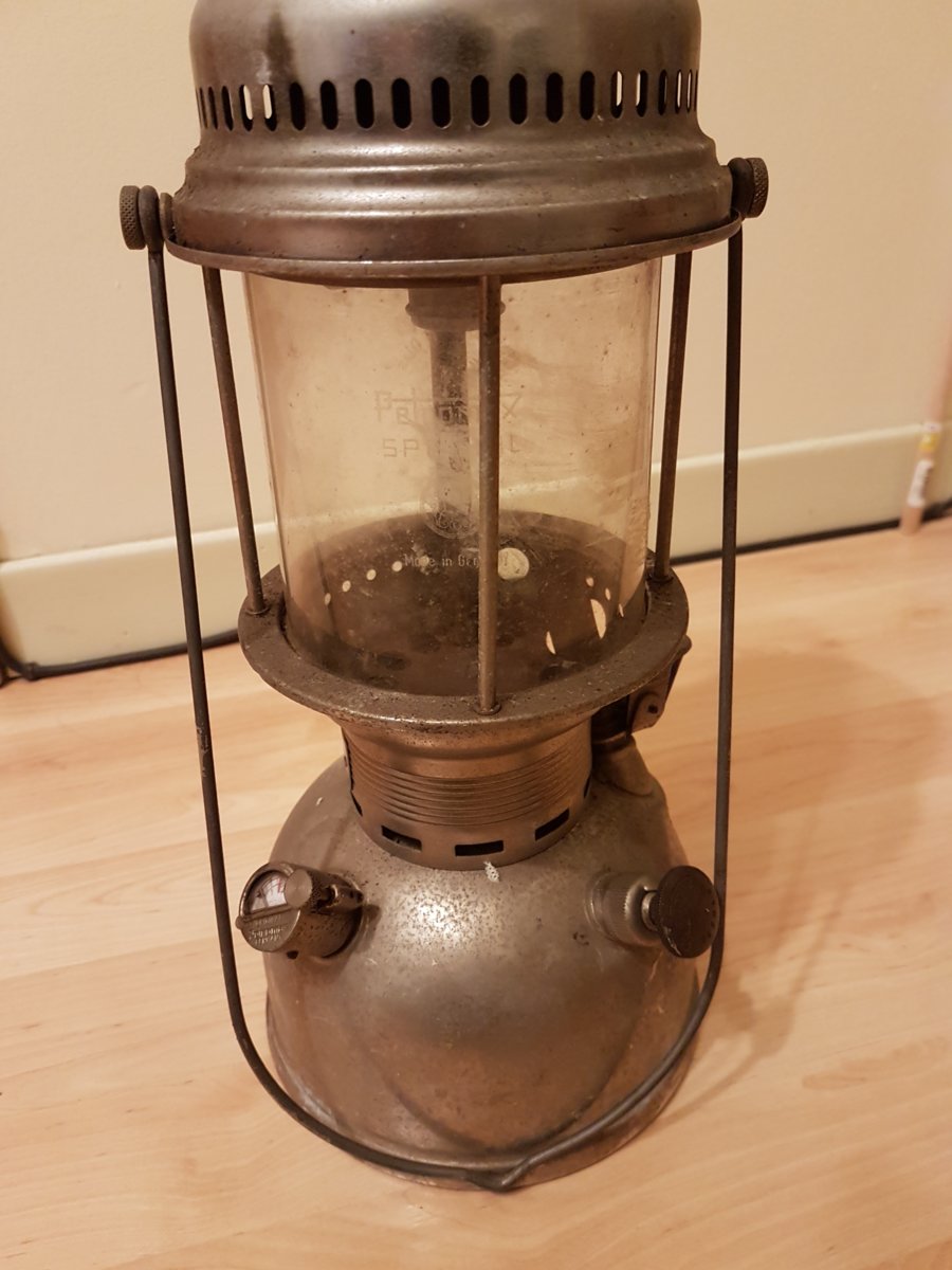

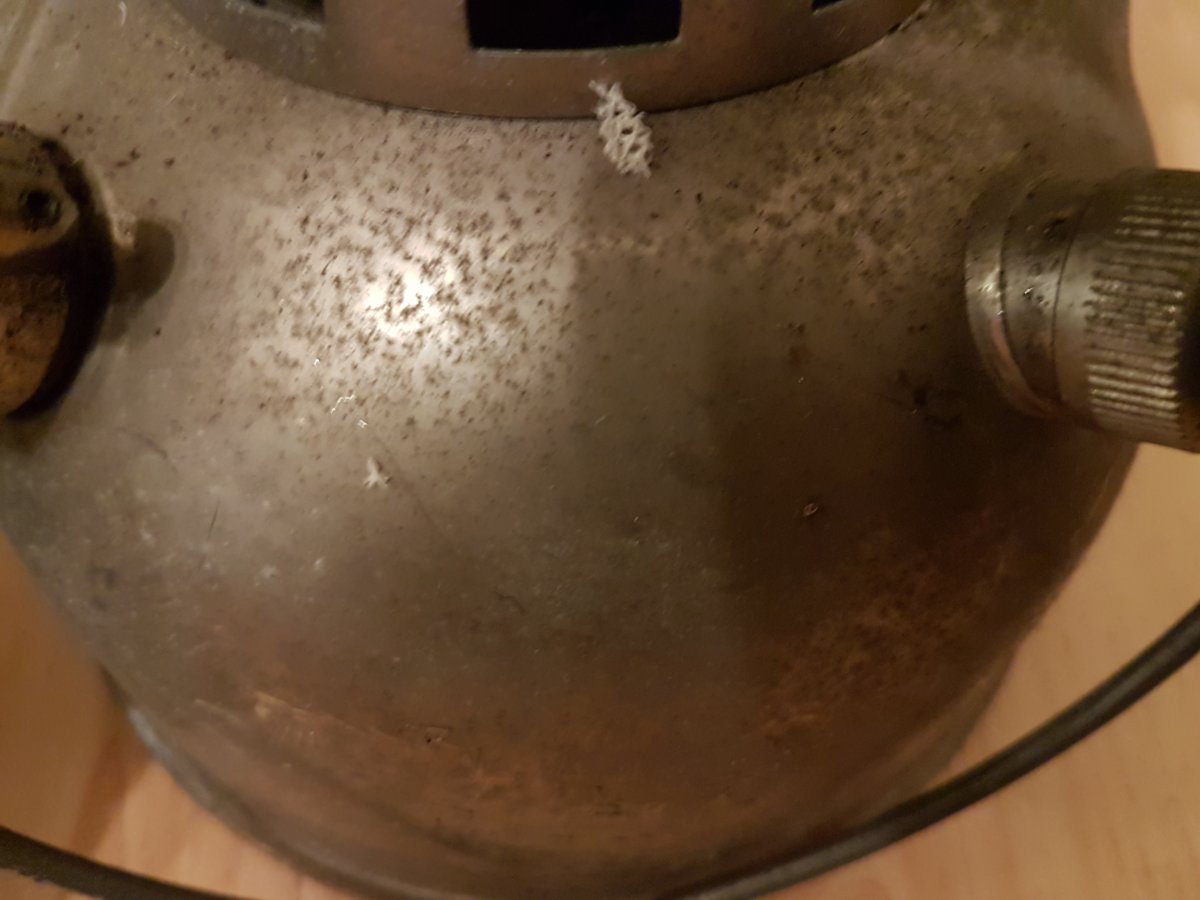

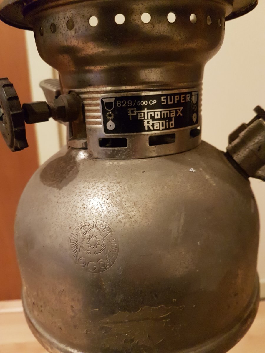

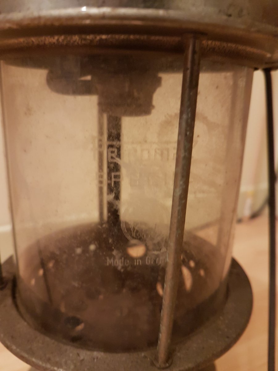

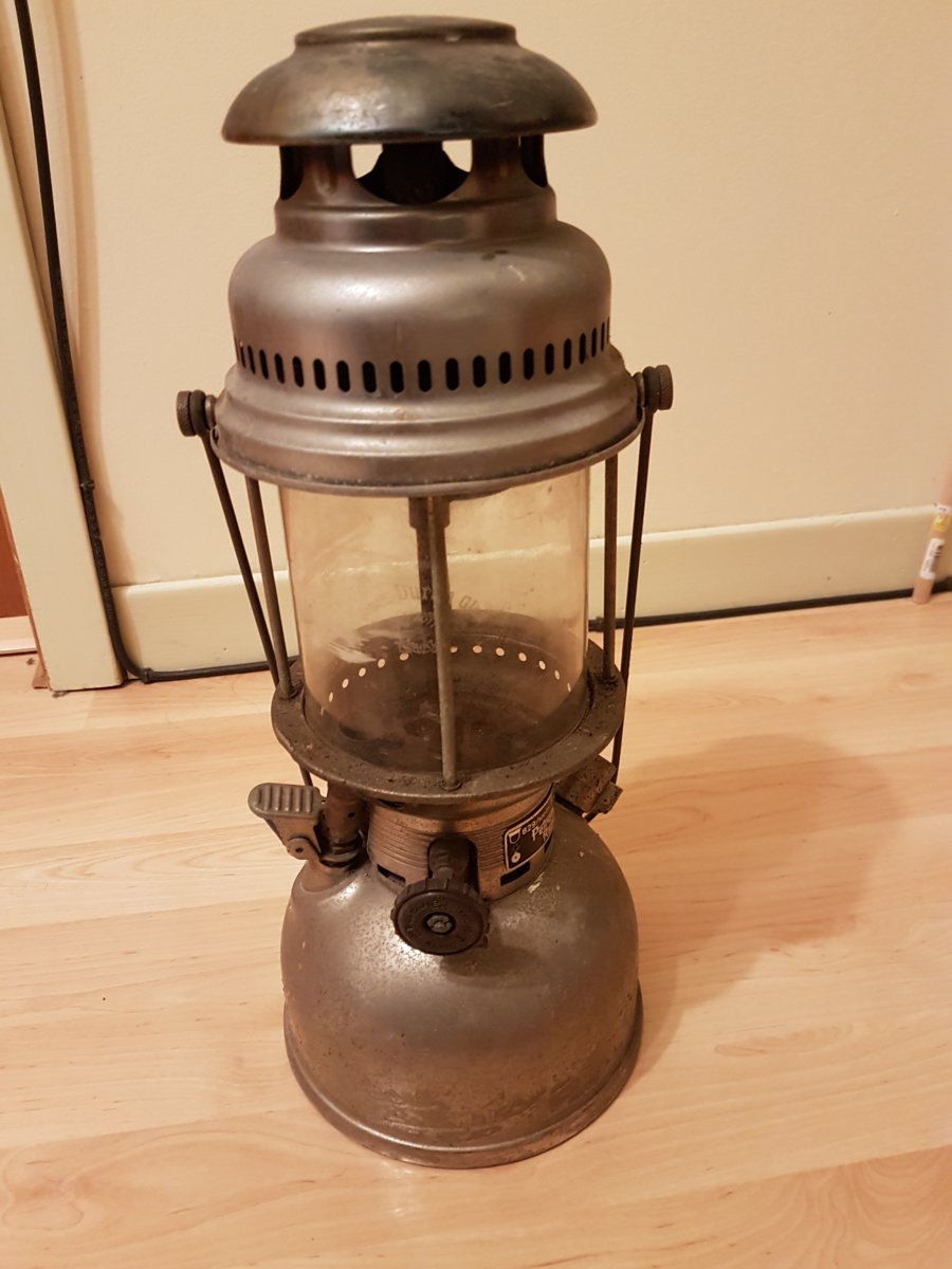

    Always wanted a real Petromax but they are rare as hen's teeth here in Canada so I bought this one from England and cringed at the £35 shipping. The outside of the lamp is covered in 20+ years of barn dwelling that will need to be cleaned off before I can polish it, if anyone has any tips for lamp washing I would appreciate it. I plan to polish it with Autosol unless someone can recommend something better.

  2. Martin K.
    Martin K. Subscriber
    Sep 20, 2013
    1,148
    Gratulation to your fine acquisition. That's not really an old lantern, in fact it seems to be built in the late 1960's.
    From my experience Autosol is good for the finish. But using only that you will need lots of elbow grease to get all that muck what I can see on the photos off the parts. I use thinned citric acid in an ultrasonic bath to get off the most serious oxide plaques. But don't do this too long, only a few minutes. After that polishing with Autosol will be much easier.

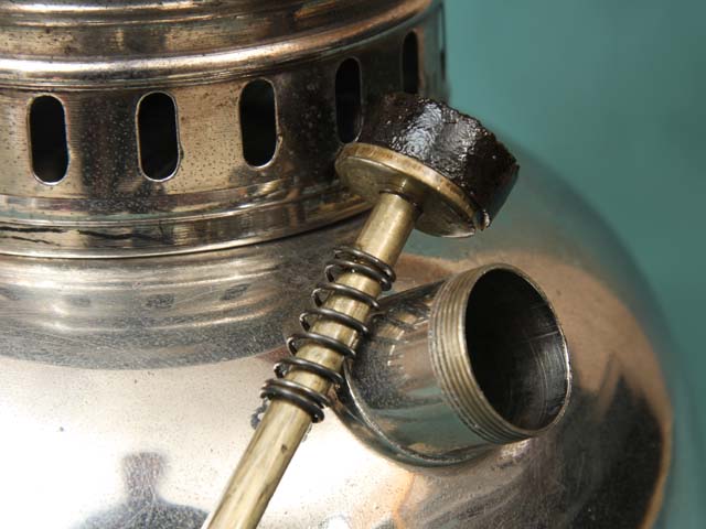

    And be sure to renew all the seals and gaskets as they most likely will have hardened over time. The most important is the NRV pip of the pump. If you like to use the Rapid torch preheater the fuel valve at the bottom of the pickup tube needs to be OK as well. And last but not least the sealing insert at the preheater or at the filler cap could be annoying due to pressure loss if they fail.

  4. phaedrus42
    phaedrus42 Subscriber
    2,056
    It will clean up well, I think.
    Just be very careful and gentle with the painted aluminium plaque on the side. The paint comes off more easily than you think :shock::)

  6. ROBBO55
    4,408
    It should clean up nicely using a citric acid solution. :thumbup:
  7. Thomas
    Thomas Subscriber
    Jun 24, 2017
    209
    All washed now and about to start polishing, has anyone used 0000 steel wool to start the polishing process? First time if ever polished nickel.
  8. phaedrus42
    2,056
    If the nickel plating is strong and not flaky 0000 steel wool to apply and rub in the polish generally works very well after the citric treatment removed the tarnish.
  9. bp4willi
    1,156
    Better use autosol instead of Steel wool.

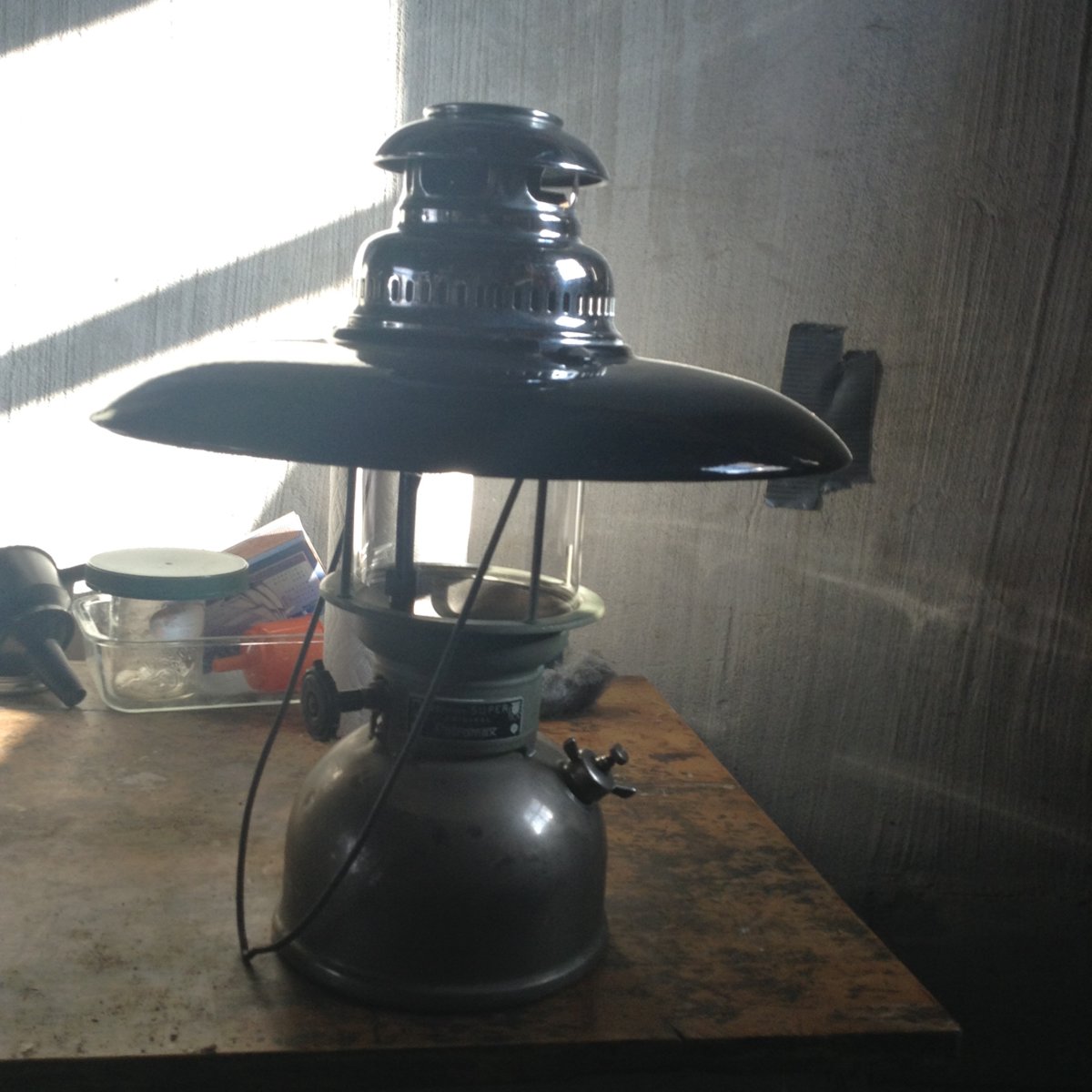

  10. Cameo Canada
    Sep 25, 2017
    42
    Ancaster Ontario, Canada
    Hi Thomas. Last year in Paris Ontario I was lucky to drop by an antique show and bough a 1956 Petromax 826 . It is in great shape.
  11. Martin K.
    Sep 20, 2013
    1,148
    And that's really a good find: it's what we call a "Sickentank" in Germany. That model is quite rare due a short period of production. Well saved :thumbup:
    BTW: nice collection that you have there!
  12. Cameo Canada
    Sep 25, 2017
    42
    Thank you very much Martin. Question - will my Petromax also shine up with the suggestions as above or is this model " the way it is " ? I have collected Coleman lanterns and two lamps here in Canada. Slipped into a few railroad lanterns but a very expensive hobby.

  13. Martin K.
    Sep 20, 2013
    1,148
    That's hard to say from the photos you made. To be honest, personally I wouldn't try to polish it up. The tank is nickel plated and you may uncover the brass if polishing it too hard. After all it's an old lady and may well have some authentic signs of it's age. If in your place I'd rather look for another one that is more shiny from the beginning. But as always, it depends on your own preferences...

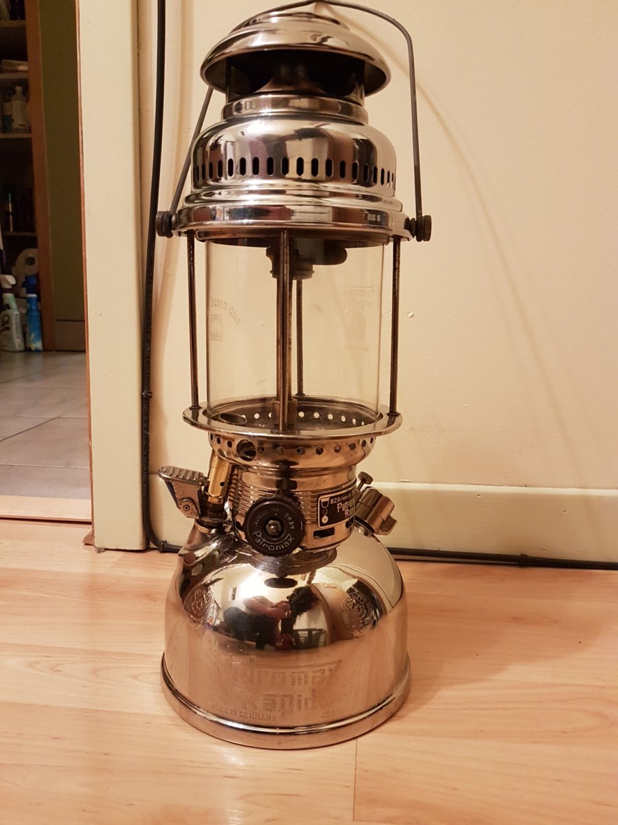

  17. Thomas
    Thomas Subscriber
    Jun 24, 2017
    209
    It shined up pretty well, the nickel does have some pits in it but no flakes.
  18. phaedrus42
    2,056
    Congratulations on a very good end result, Thomas!

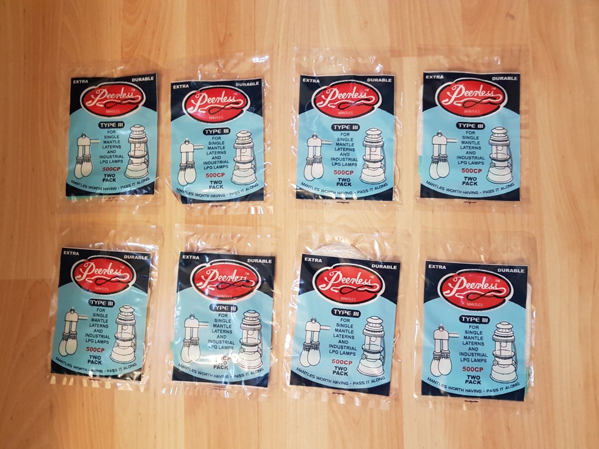

    Mantles came today, I'm still waiting on new seals and gaskets.

    A trick with the Peerless mantles is to gently stretch the cloth wider around the middle after tying it on. It will then form into a rounder shape which should work well on the Petromax

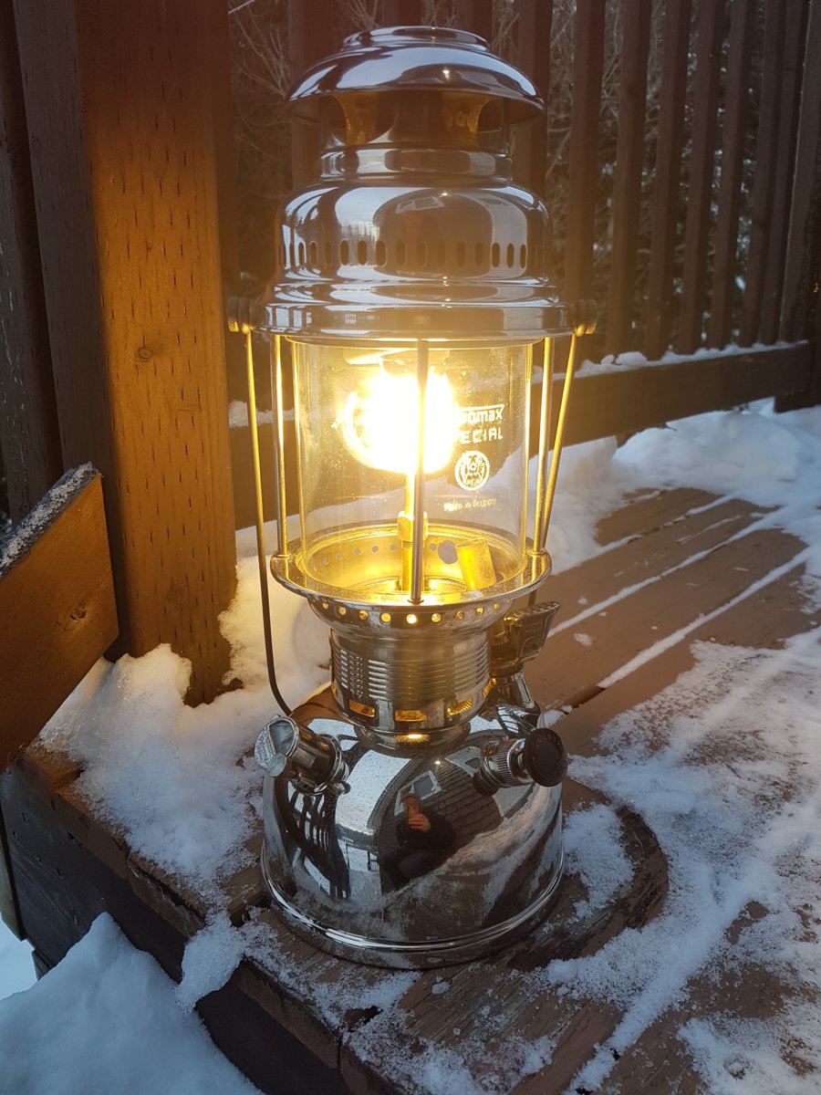

  23. Thomas
    Thomas Subscriber
    Jun 24, 2017
    209
    It lives!
  24. JonD
    JonD Subscriber
    Apr 15, 2014
    1,011
    Hertfordshire, England
    Lovely job Thomas, there is some more to come in my opinion.
    When that is going as well as it can, you will have a hard job to get a photograph of it.
    The good thing is that they can do many roles. Sometimes quiet and just enough - as you have it.
    Sometimes howling and bright as the sun. It depends how you work them.
