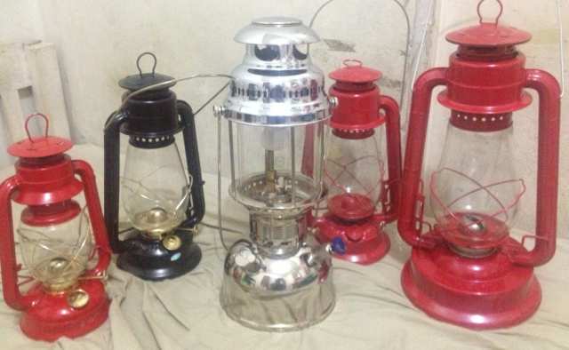

    Welcome to the forum. Would you be able to share a picture of your lantern with us?
  3. Jelopascua
    Jun 28, 2013
    15
    Hi there!

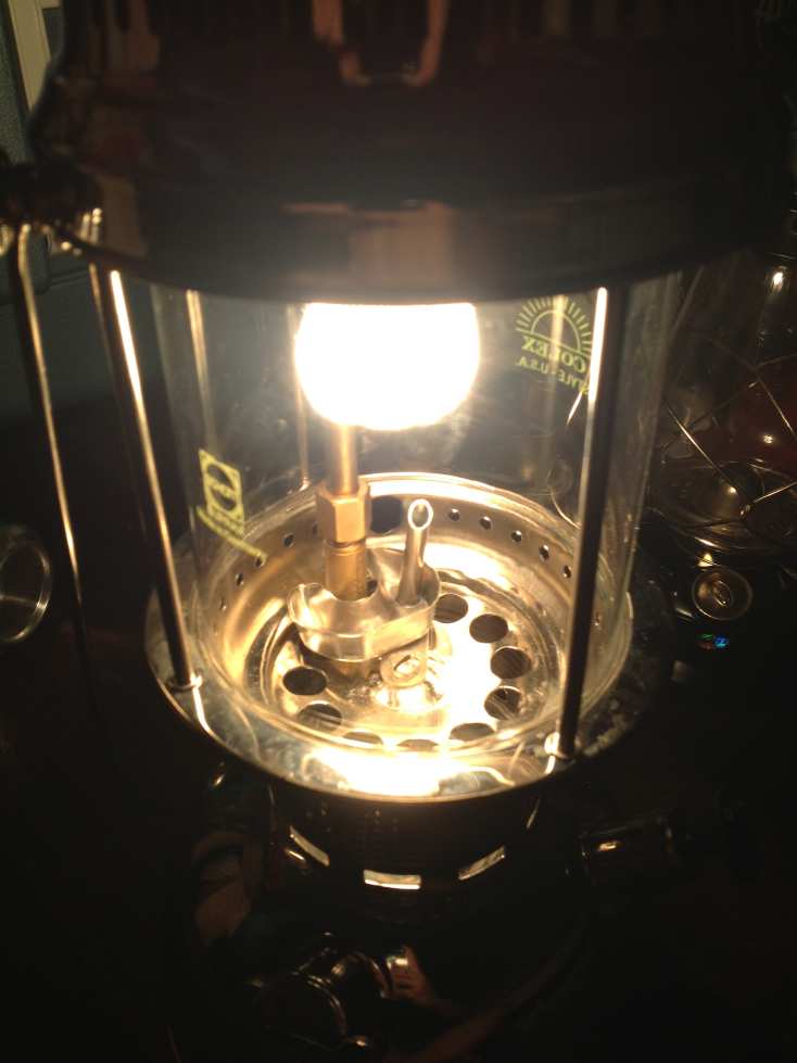

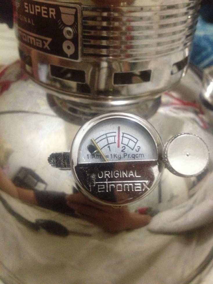

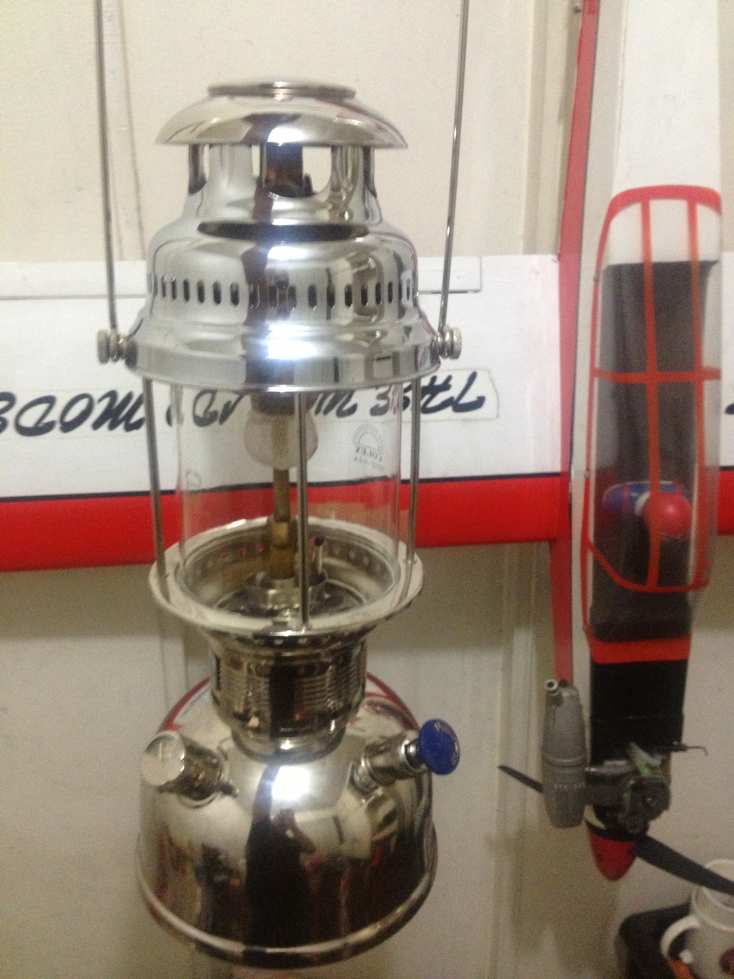

    Here are the pictures of my lanterns. I am worried with my recent purchase the "Petromax" I just purchased seems like SS on the top. I have checked the Parts are stamped petromax including the brass thing with the small pin at the end that connected with the regulator. I think its no 19 in the parts list.
    1372427965-IMG_1289.jpg 1372428008-IMG_1302.jpg 1372428036-IMG_1301.jpg 1372428075-IMG_1297.jpg 1372428098-IMG_1287.jpg
  4. Graham P Australia
    Mar 3, 2012
    982
    Albury area NSW AUstralia
    If its got "Made in Germany with Petromax" + 10 point star on the font + 4 figure date code on base its original. With the blue valve wheels it`s probably the same as mine 11 point star "Original Petromax"Germany ,six figure date code ? = Chinese modern production. Hows your other hobby hanging on the wall go.

    Nice lantern.. As a newbie myself I know nothing, but it seems your mantel is much smaller than Peerless 111 mantles I use on Petromax 500cp.. you may want to experiment in the future..
  6. paul m
    paul m Subscriber
    764
    lancashire. UK
    Strange that it has a "Colex" glass in it, did you buy the lamp new or as used?
  7. Jelopascua
    Jun 28, 2013
    15
    I bought it new and researched about it and found some old PMaxes on ebay having the same glass.
    @Graham P I'm pretty sure that it's a Chinese made PMax. However, thanks for the tip! I did notice some numbers on the bottom of the fount will check later when I get home. Off topic I switched to quads since I have a hard time finding a clear space to fly nowadays.
    @SoakedKarma I've noticed that too i've been using a butterfly no.41 rated 500cp but it still seems small. got them for 4pcs per $1 read about peerless and found out the factory is just 10km from my place.

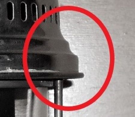

    Wow, that's seven years ago. Anyway, it doesn't look like a Chinese-made Petromax to me. The blue knob would likely turn brown with a little aging. I don't think the Model 523 is of modern manufacture.
  11. Henry Plews
    3,068
    Perhaps it's my eyesight but it looks Chinses made to me. Look how poorly defined the contours on the hood are.

  13. MYN
    The picture's resolution isn't very high. Its pretty blurry to me too. I was only guessing from the rest of the lantern's overall. Couldn't see much the details like the logo, stepped or flared sides/edges, rib definition, etc. Just wondering if the model 523 was ever made in China too.

    @Henry Plews @MYN
    I have one of those China Px 523 with bottom nr 468929,
    the hood showing the faint , not the sharp step of a Germany
    made lamp like on Henry's photos. And, very strange, the pressure
    gauge dial only shows digits from 1 to 3, but no explaining formula.
    But, to be honest, she's shining well.
