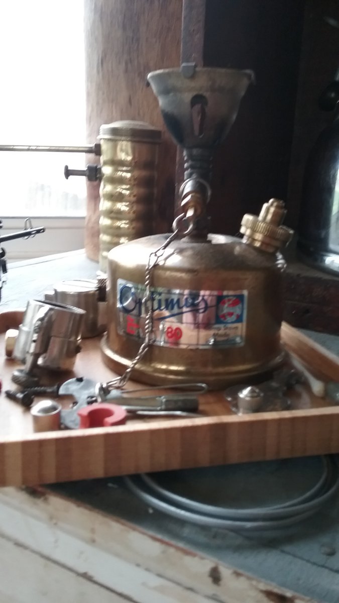

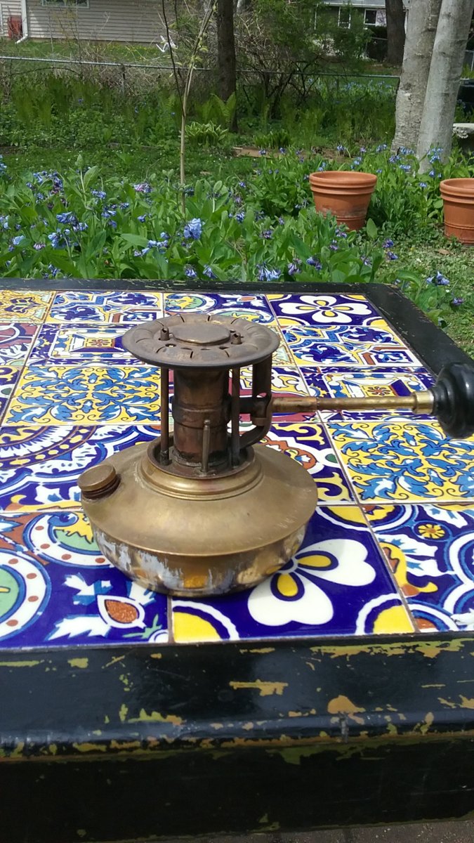

    Do I see stoves in your avatar @Lundo007 ?? :thumbup:
