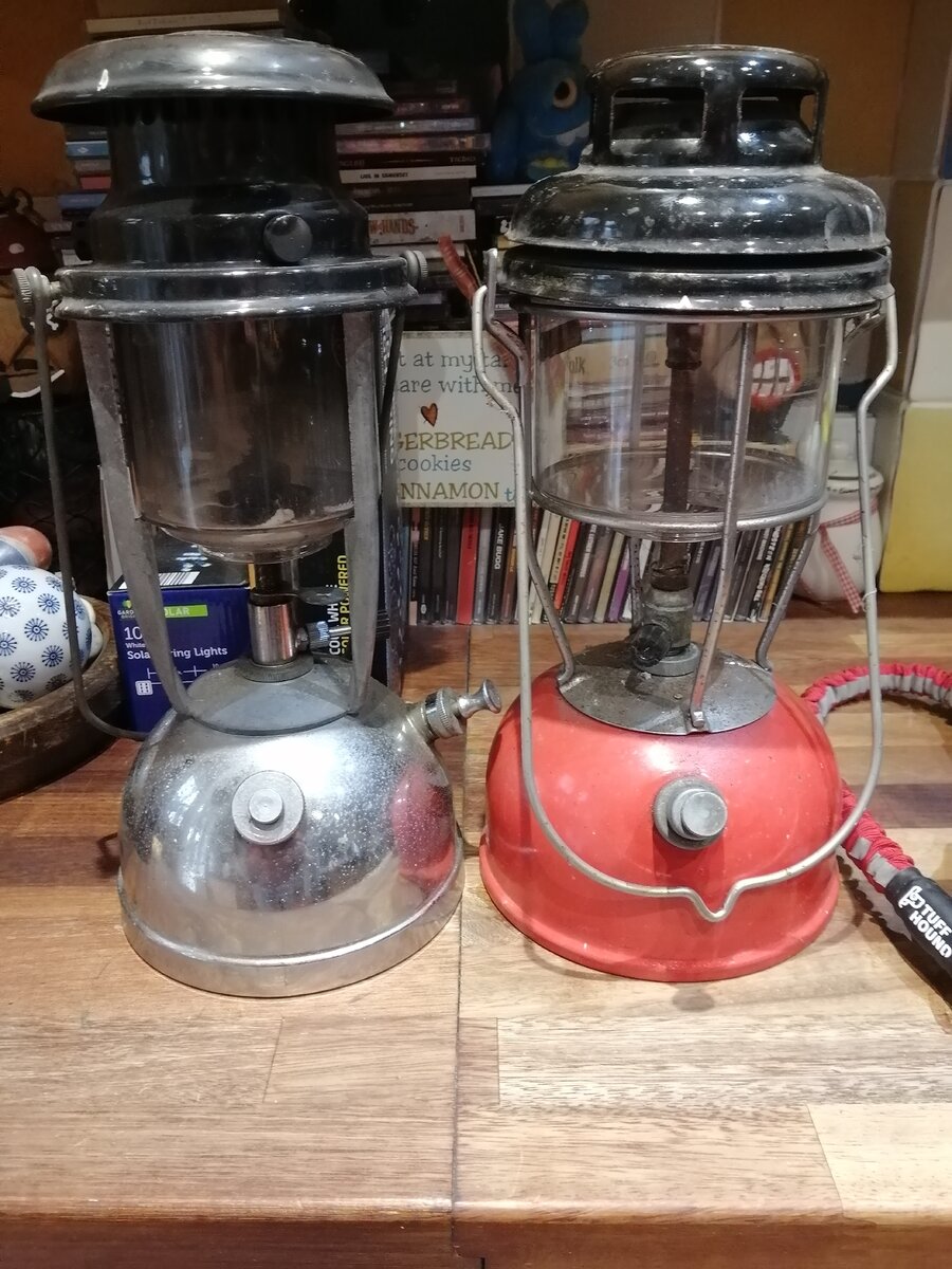

    Evening, my name's Steve and I recently bought 2 pressure lamps, much to the wife's chagrin "what do you want one of those for?" etc. Any road I think they're cool, my question to you is ...... err what did I buy now the one on the right is a Tilley but no idea what the one on the left is? would a kind soul be able to identify it for me? ta very much.
  2. plantpot United Kingdom
    Aug 2, 2019
    243
    London
    year 1965-1968. It's a 320 Bialaddin/Vapalux I think... have a look under GB/Bialaddin in the reference gallery.

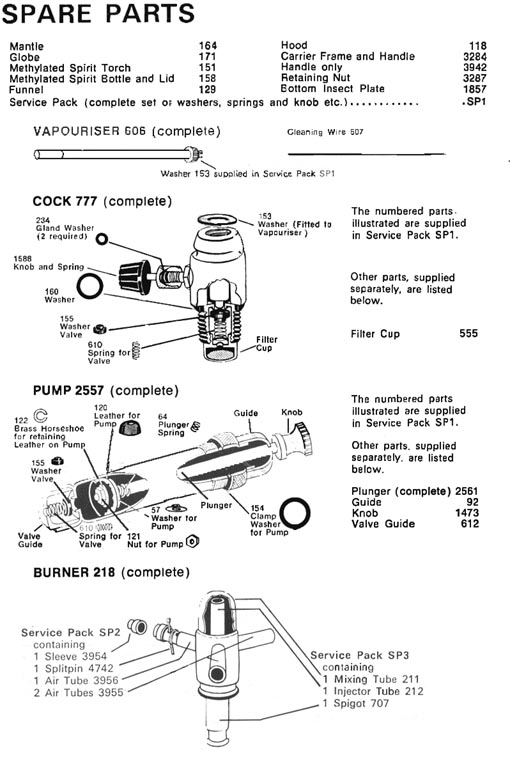

    Unless your 246B is an early one the Fettlebox seals won't fit. However the seal kit from Tilley will fit both Tilley designs. So for your first lantern if the seals need replacing get the seals from Tilley.
    Service pack 1
    There should be a series of numbers and letters stamped into the base of the font. The numbers are date of manufacturing. ie 0767 is July 1967.
