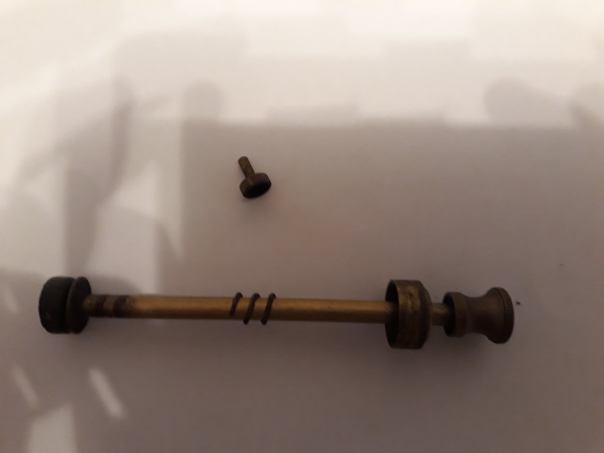

    Hi all. I found this superb forum after digging out a Tilley 246 ( as I now know it) that had hung up in my barn for about 25 years. I decided to give it a clean and get it going. First item on the list was a new pump piston, as the end fell off the old one. Then a new seal kit, when I became covered in paraffin after pumping it up. The NRV was refitted the right way round, and a new spring added. The kit came with a little rubber disc that I stuck to the end of the plastic NRV pip thing, but then the whole thing bottomed out and wouldn't open when the guide was screwed in. I trimmed the disc a bit and shortened the spring, and all was good. A bit of pumping and preheating, and away she went. I was amazed at the amount of light and heat. It's my new favourite toy. Her indoors was less enthusiastic then I was when I marched into the kitchen proclaiming the awesomeness of my lamp, but was quite impressed when it raised the room temperature from 21 degrees to 25 in about half an hour. (it's not a small kitchen, either). It will give some welcome extra warmth in my freezing workshop, and provide many happy hours of browsing for new lamps on Ebay. Anyway, I did have a question. Do the brass NRV things I see advertised fit my pump, which is an ugly new aluminium-ended job? thanks in anticipation, and sorry for the rambling, but I'm VERY pleased with my lamp. So much better than the Coleman propane North Star I use for fishing and camping.

    Welcome Chris, glad to hear you have had some success with your pressure lantern.
    I don’t have an answer to your specific question about the brass nrv parts, it may help to know more about the model you have, our if you post a photo.
    11,052
    Chris
    I’m not sure what you mean by “brass NRV things”.
    Post a photo of the bit you want to replace.
  4. AussiePete
    @chris sumpter
    Welcome from Queensland Australia.
    A photo or 2 would help heaps, however, when you mentioned the aluminium part, it indicates to me that you have a X246B.
    I could be wrong, that’s why pictures help so much.
    There is an option of obtaining earlier X246 brass pump parts and using them as replacements parts, once again pictures would help us determine accurately.
    Enjoy this wonderful hobby and I look forward to seeing your future posts.

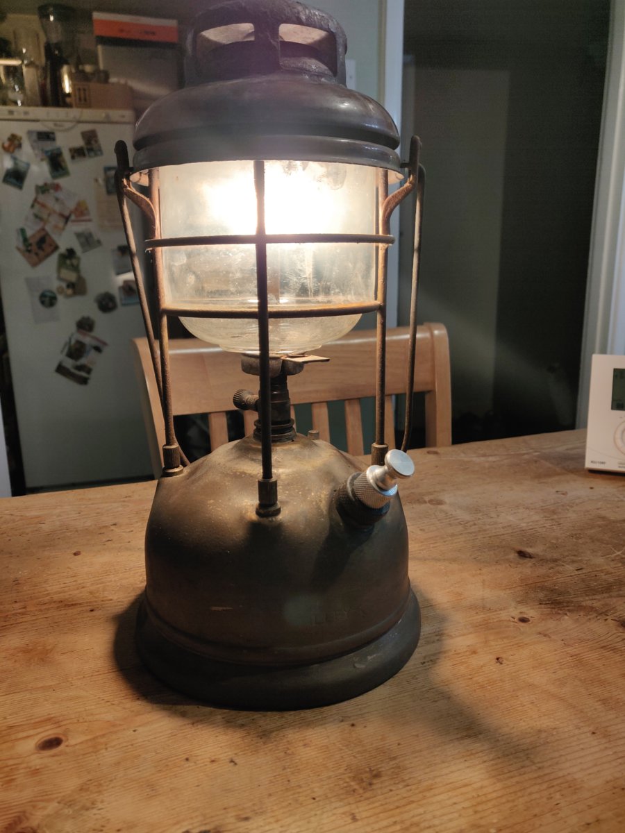

  9. AussiePete
    @chris sumpter
    Good news, that’s an early X246 AKA Guardsman possibly from the 1950s. They’re very good lamps and solid performers. You even have the correct deep dish glass globe, these are not so easy to get hold of.
    The pump looks to be from a later X246B and the quality of the aluminium pump is far less than the quality of your earlier Guardsman. You can get the correct solid brass pump assembly from another Guardsman that is a junker, that is for parts only. It’s worth the try, It’ll make you lantern look so much better and get her back as she was.

  15. ColinG United Kingdom
    4,815
    Nice lantern and easy to work on. I would consider buying a modern glass globe for everyday use to protect they one that came with it as they aren't easy to come by.

    Hi Chris and welcome aboard. Going back to your first post, sticking the disc on the plastic bit.... older NRVs have a round brass cup that the disc seal fits into, newer aluminium pumps don't have a cup, just a square lump of rubber with a pip that fits into the spring. It sounds like your NRV now has an over thick seal. The square ones are available online. Enjoy this lamp and buy it some friends , but , they play well together and multiply when you're not looking :lol:
  18. Ian Bingham
    Ian Bingham Subscriber
    239
    Kent, England
    It looks to me a though the pump is part brass and part aluminium. Possibly someone has replaced the original pump rod and cylinder cap with nasty modern parts.
    If the cylinder is brass, it should/did have NRV in the form of a small disc sitting in a shallow cup, with a short shaft that the spring sits around. But quite possibly the NRV has been replaced at the same time as the aluminium parts were fitted - and the modern lumpy NRV used, which does away with the cup.
    Getting a complete, brass pump will be the easiest way to make it look better

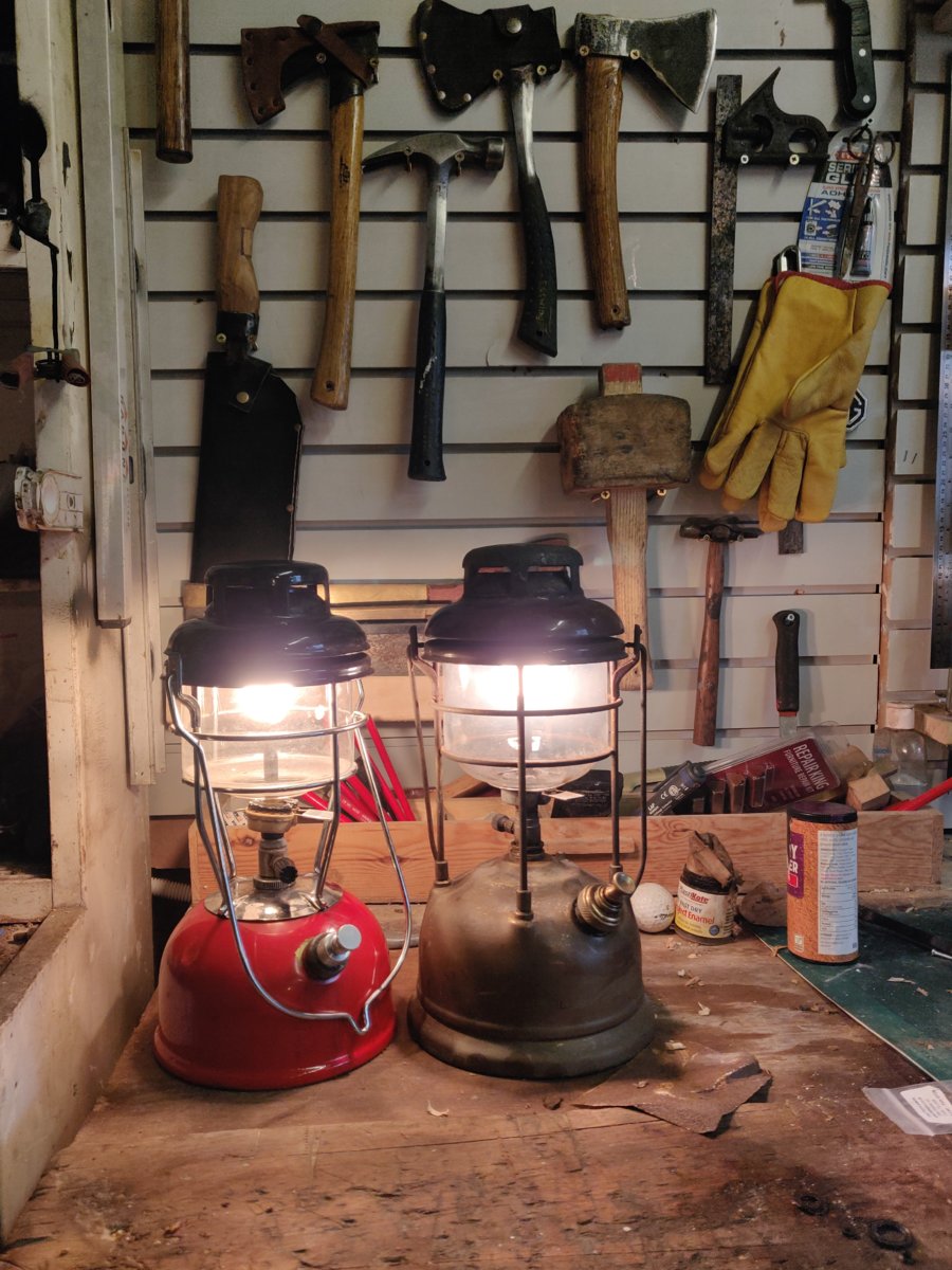

  29. chris sumpter
    chris sumpter United Kingdom Subscriber
    Dec 4, 2019
    12
    market harborough
    Thanks to the kindness of furum members on here, I now have two working lamps
  30. LatMag49
    LatMag49 Germany Subscriber
    Aug 31, 2017
    289
    Good to see them working, I like it.
    And be sure they will not stay allone.
    Matthias
