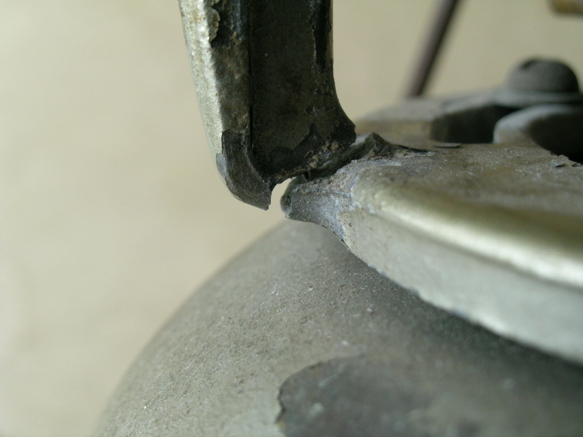

    Colin, I understand and agree with your view on these lamps, but the unique feature that sets the later Willis & Bates lamps apart from any other lamp is the alloy frame. Which can break, as indeed they do like my 315.... No such thing on the older models with the brass cage: they bend, which is straightenable.

    @M.Meijer I definitely agree that the alloy frame wasn't a good move but I suspect it reduced manufacturing and assembly costs considerably. Zink alloy can be brittle especially when it's cold, and if it's left unpainted it looks grey and ugly. However I do like the look of the 315 and they work well... plus the three point screw fixing is more stable than the later 320 in my opinion. To be honest I'm not a fan of the 320. To me it looks like an alloy copy of Tilley's X246b frame design with it's central securing ring. My one and only Vapalux 320 gets extremely hot with prolonged use so it sits on the shelf most of the time!

    As for the construction, I do not see any practical advantage in three screws keeping cage and tank together as opposed to one circular nut. Rather, it can only lead to uneven stresses on the horizontal lower ring of the alloy frame that might have been the cause of the broken leg at the connection with this ring as on my 315.

    But I am fine, as this frame is now part of a parts lamp, with a better overall 315 in the collection. I also dramatized the break by sticking a pin in it, and normally nobody would notice.
