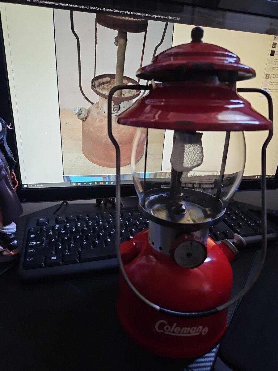

    Well while I wait for parts for my other project (the two quick lites and now soon to be three) I noticed more and more my wife sitting and watching me fix things...ask the occasional questions... Offer help to hold things... Etc...and eventually I asked "well... Do you want to try it?"
    She said yes...and not knowing a thing about stoves and lanterns other than using them on trips I asked her to pick out something she liked...
    She said "the red one is nice and small"
    So...I scoured eBay for a project...and brother did I find one...
    For her first attempt...id have to say she did really well. Her first question was if she can put the sticker on....now we're assembling it...
    Not bad huh?
    Paint stripper... Then citric acid to kill the rust and another bath of baking soda to cancel the acid...a wire wheel and 3 coats of paint.
    All I did was watch and offer advice...I just let her go at it hahahaha...(She did really well at mica gloves so why not?)

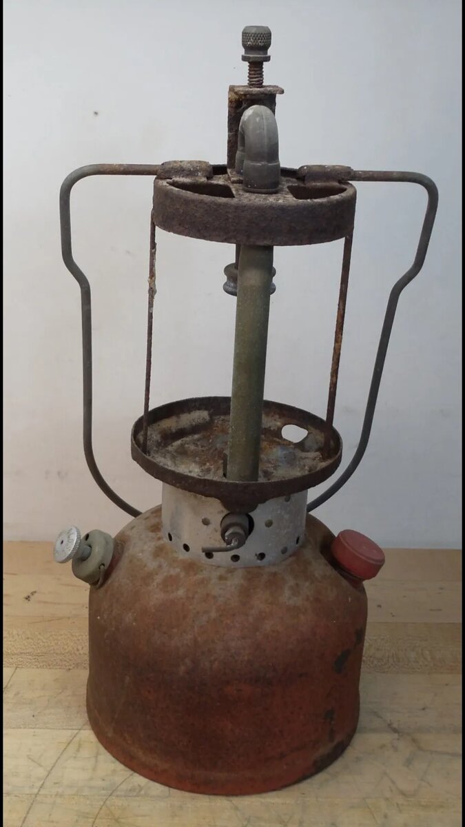

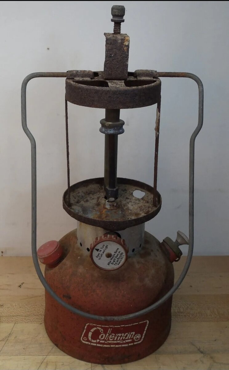

    Before photos from the listing:
  2. podbros
    3,999
    Great result! :thumbup:
    Nice one ! :-)
  3. ROBBO55
    4,335
    She'll be taking over the workshop soon. :lol:

  5. MYN
    Really nice outcome, what your wife just did.:thumbup:
    Congratulations to both of you.

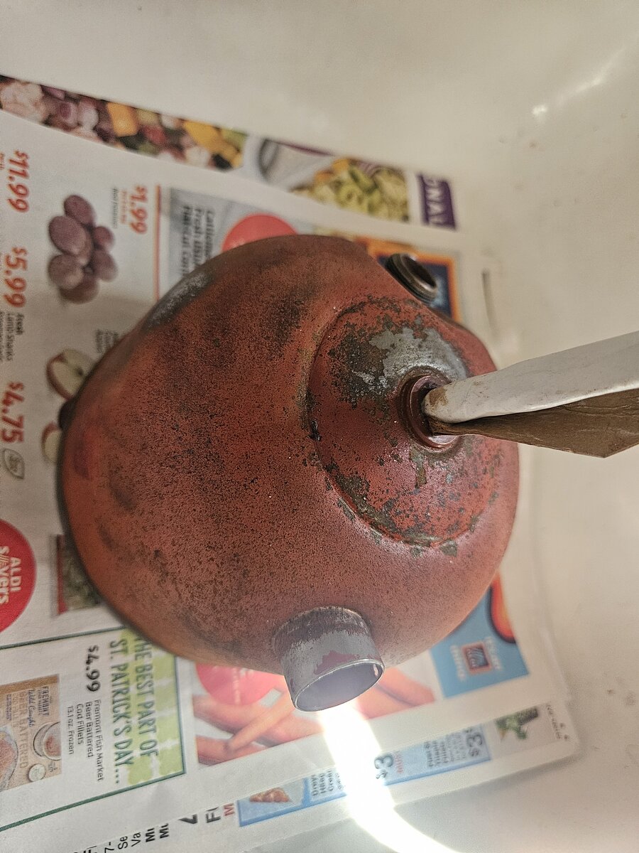

    @MYN you didn't see the efforts it took to get that paint off.
    We used three products... actually 4... It was interesting (not the first word that came in my mind)
    First was a "green" paint stripper... That was a joke. Did nothing at all at 24 hours but no worries...all the whales and trees are safe haha
    Second was acetone....nope... Nothing... paint was suspiciously enamel like and didn't do anything
    Third was regular paint stripper...12 hours and a little pink color... But nothing...
    The last and only savior in the holy war against the tank was...
    Aircraft paint remover... This is strong enough to start melting my gloves and will bubble regular house paint on contact. It's no joke and can only get that at auto parts stores. It does it all...oil base, laquer, polyurethane and baked enamel...
    Overnight and the paint came off with a brass brush with ease.
    Then it was citric acid to remove rust... Then the baking soda to stop that reaction... Then the repaint.
    Here is a photo of the tank right before the aircraft paint remover... defiance in a Coleman font...
