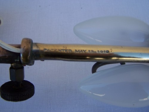

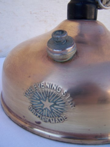

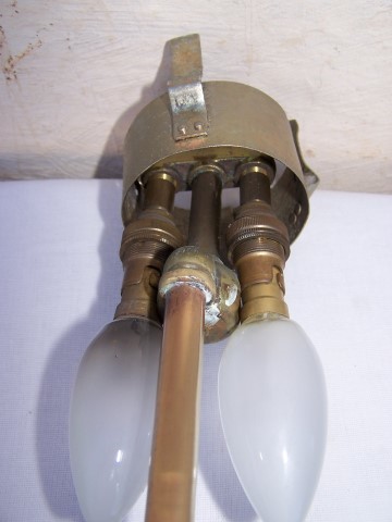

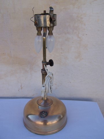

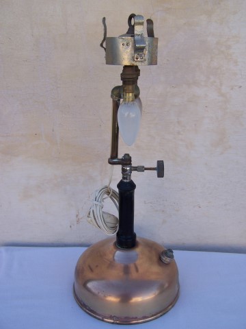

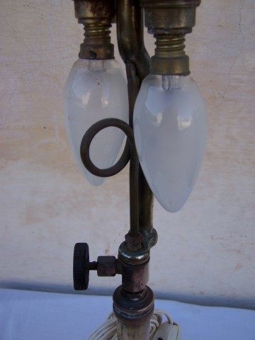

    I overpaid for these two abused lamps, a Kildark (KG232?) and a The Eveneing Star (P92066?). I hoped that I could rescue and restore them.
    I knew it was going to be a battle, The Evening Star is missing the vapourisor, both burner tubes and caps, and a lampshade. The Kildark's condition is similar, also shorting a finial, although it does have its vapouriser. I also suspect some components between the 2 lamps are mixed (founts?). Both have no chrome left.
    My obvious problem is where to find parts. I suppose I can DIY burner tubes and caps, but glass shades and vapourisers are rare and very expensive to import to South Africa.
    Now the dilemma: My dear wife saw how distressed I was when I unboxed them and I explained how someone had butchered the lamps by electrifying them, and how much effort it would be to restore them. She promptly suggested that we used them as is, electric bedside lamps. Since I don't have an immediate way forward, they are temporarily doing service in the bedroom.
    I kind of feel like a traitor on the one hand, but on the other hand my wife is happy and the lamps see daily use. I would still restore them to original condition in a heartbeat if I had reasonable access to the needed parts (please advise).
    In the meantime they will light up the bedroom.... as I try to cope with the guilt and shame.
    Please let me know if anybody has advice about restoring them, or, make me feel better by saying it is OK to have electrified lamps, even if you have to lie.
    PS Please don't ban me from the forum ;)

    Ok @JohanOptimus , here goes:
    You can think of them as genuine, original electric lamps that have been modelled and made to look like Kildarks. Replicas of the original Kildark pressure lamps.(indeed some unbelievably good replicas).
    Some fine day(when the wife's not around), you might to 'cruelly' butcher and convert the perfectly working, electric bedroom lamps into pressurized kerosene lamps.

    The Kildark has a Coleman valve and burner. The ES has the correct burner casting and valve unit so you just need a generator. The KD generator probably won't fit because that will be a Coleman Q99 I guess. You can find parts for these in the US. All the valve and burner bits are compatible with Akron parts. In fact early ES and KD lamps were imported Akron product. Since Akron lamps are rather prone to stress craked tanks and fuel tubes there are parts lurking with quite a few collectors over there. ::Neil::

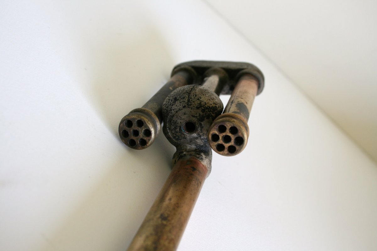

    The photo below shows the proper burner tubes and caps, and is from this excellent post by #Tony Press (I hope you don't mind Tony)
    The Evening Star (92066 Table Lamp)

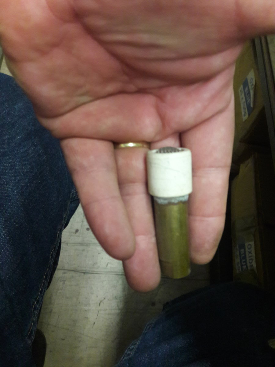

    MYN, I note the problem with the copper, how about trying the burner type below? I am not sure what they are for. 20180723_155003.jpg
  14. JEFF JOHNSON
    16,854
    Happy fettling!:thumbup::thumbup:
  15. MYN
    @JohanOptimus
    If you could secure that in, why not? Proper length would be crucial or you might end up in some 'back-burning" inside the tube.
    Its brass and...the white sleeve? Is that made of Alumina or some ceramic?
    If it is, sure...not a problem.
    There should not any soldering.
    Anyway, how would you tie the mantles on that?

  17. broadgage
    May 2, 2016
    107
    North Somerset
    I would think twice about use in electrocuted form. Look doubtful WRT to electrical safety.
    Twin flex with no earth and metallic lamp holders.
    A lot of the screw thread of the bulbs is exposed, most dangerous if connected to live of the mains, and far from ideal if connected to neutral.
    Might be worth fitting 12 or 24 volt lamps and connecting via a transformer.
