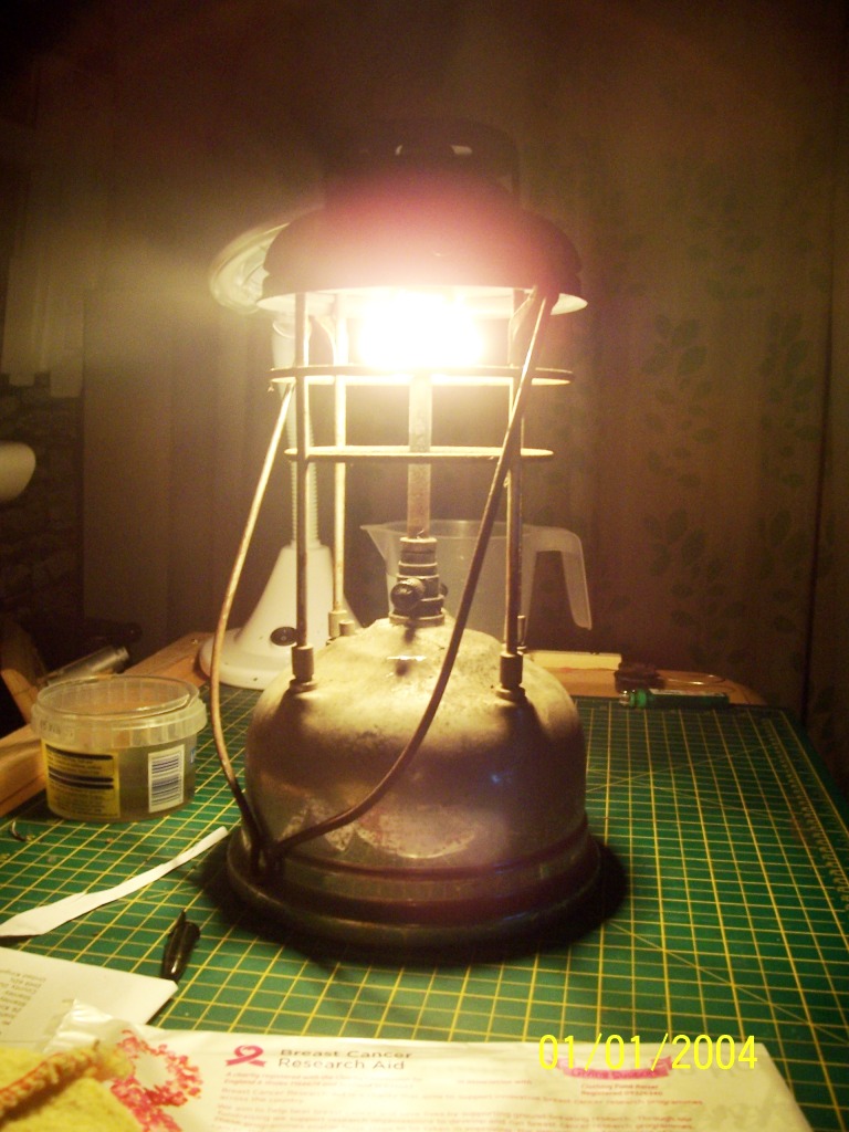

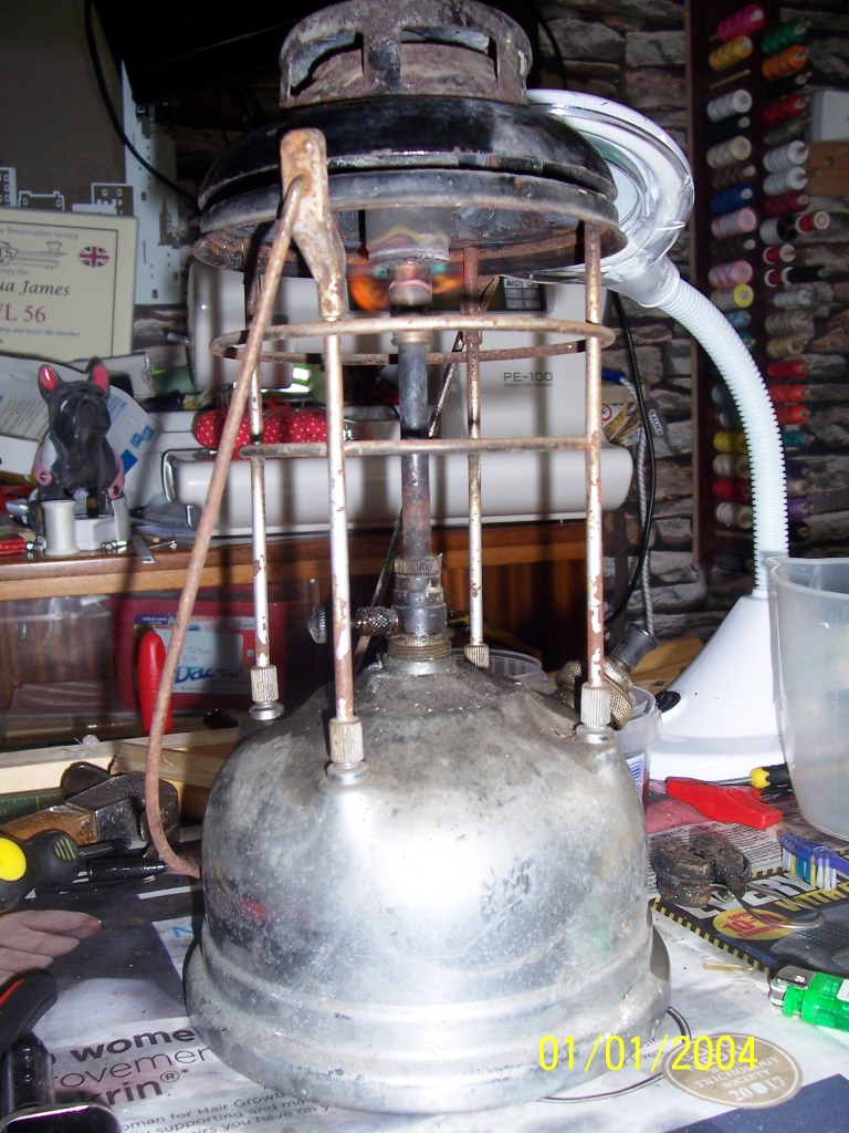

    09:30. stripped pump again, no pressure. Moved onto one of the Guardsmen. This has had nothing done to it. tested it without a mantle Attached my money shot. Nice Bunsen flame but a yellow skirt. Will add further photo tonight when dark. Would love to fit mantle (have several 164X - will they fit)?. I know once fitted the fettling work will mean destruction of the mantle. 100_2287.JPG 100_2288.JPG 100_2287.JPG 100_2288.JPG

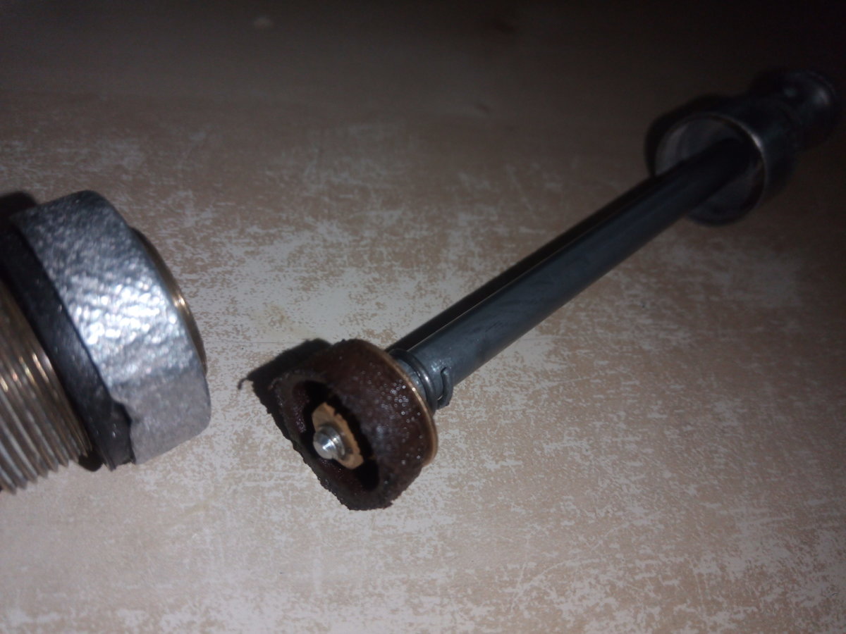

    The Bucket (Leather Pump Cup) The correct way round.
    Before fitting soak the leather cup in 3 in One oil or some use olive oil so it become nice and soft. Work it in with your fingers as well
    Dissasemble the Non return Valve and make sure the hole in the end of the brass pump tube is clear, replace the rubber bung with the correct type (square for later models round for earlier)
    The end nut has a hole... keep this clear...
    Make sure the pump barrel hole is clear as well
    Happy Fettling

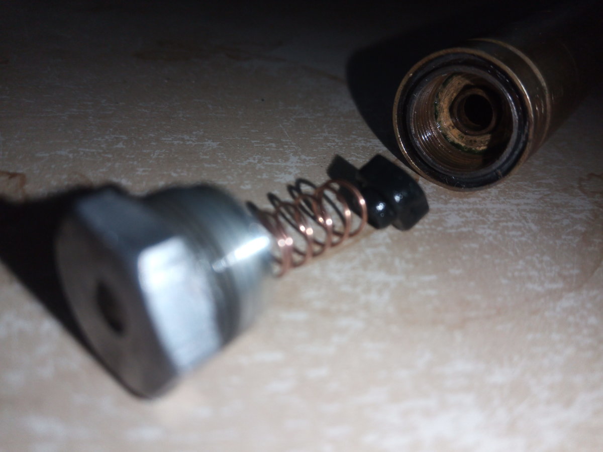

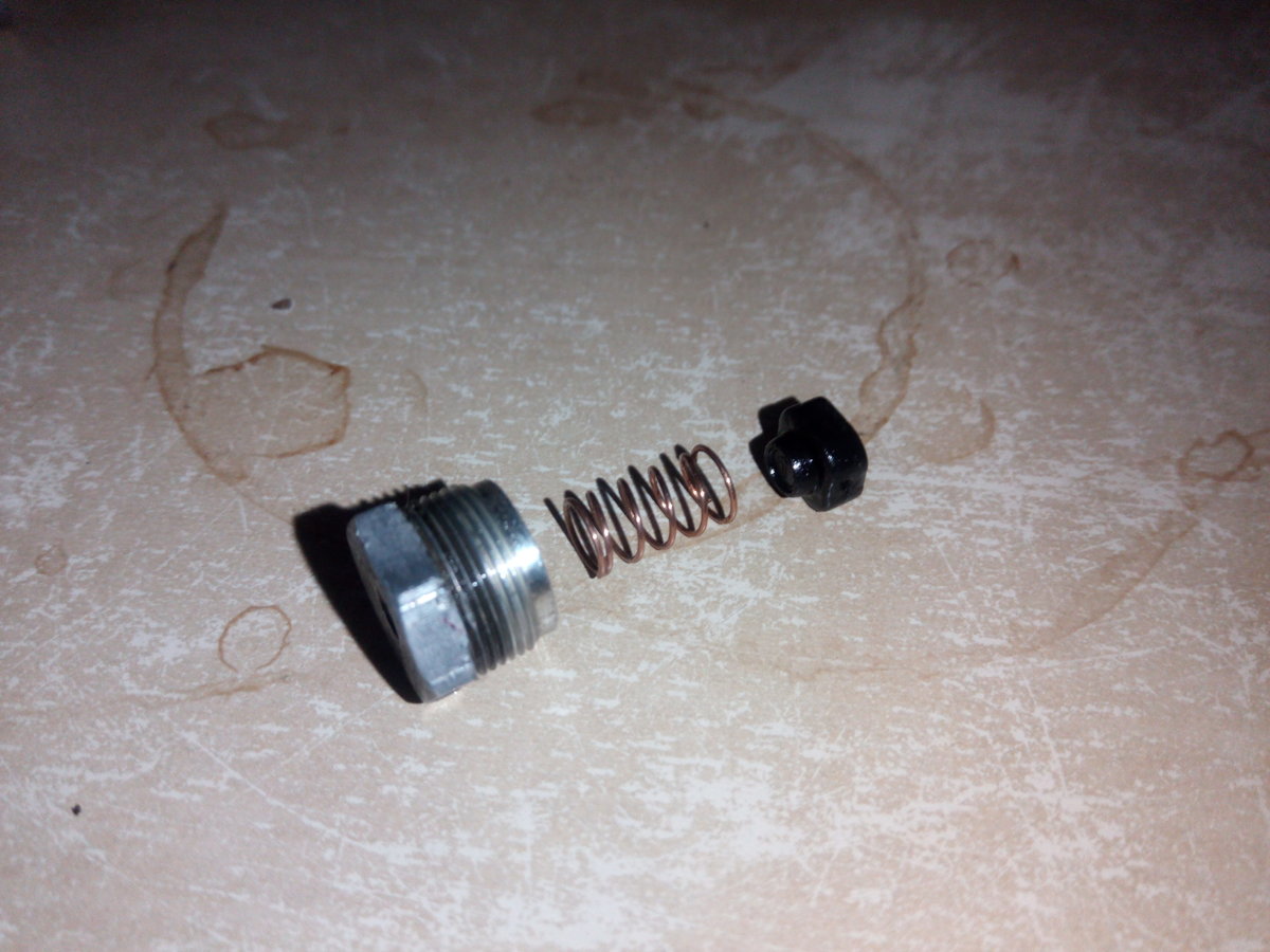

    I did understand your sketch. My pump is as set up in the photographs. When the end brass piece is screwed up the "tit" on the NRV is hard up against ther pump outlet hole, seems to prevent air passing through. the spring on mine appears to have more coils than the one in the photograph.removed the NRV and air pushes out of the end hole.

    And you have the rubber valve and spring in the right way round,,, the rubber seal facing toward the handle end of the pump, as in my photograph and the spring toward the bit that screws out with the small hole in the end. All logical I know, but it has been done before!

    I'll sort it eventually. In the meantime, here is an untouched Guardsman first lighting. 100_2291.JPG

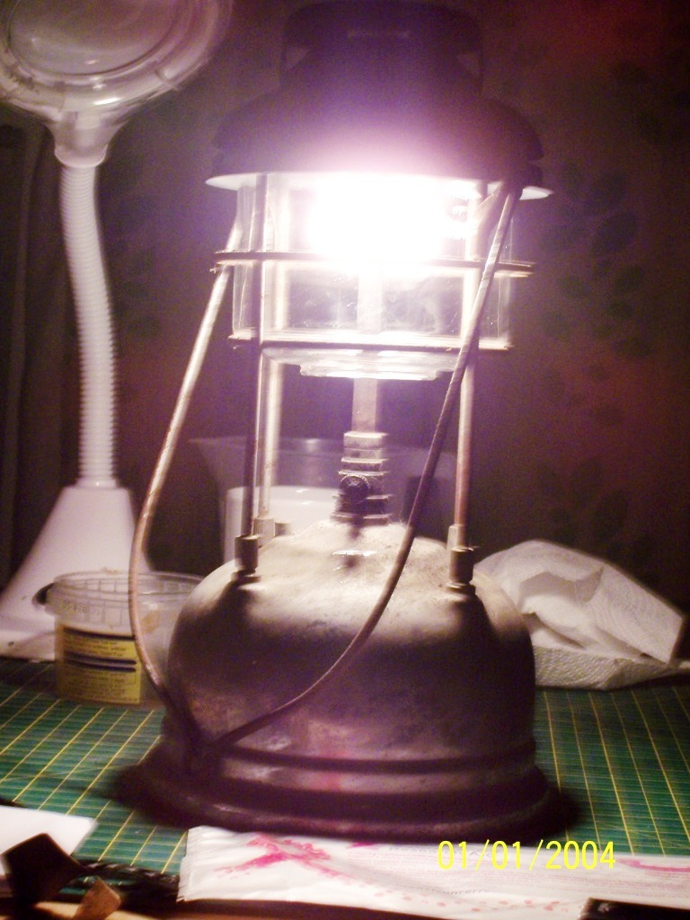

  22. Joshua James United Kingdom
    Feb 15, 2020
    11
    County Durham, England
  23. ROBBO55
    4,358
    Welcome to CPL Joshua.
    Too many coils in the NRV spring can become solid when compressed and jam the pip against the exit hole.
    A previous owner may have changed the original spring and now with your new pip there is no room for movement.
    Did the pip you changed look like the one shown by Plantpot?
    The early 246B's had the same flat pip in brass holder as the 246.

    The pip is definitely against the hole. it is a square rubber, the one that came out was round. With this removed air will pass through the hole. Will look for the originalspring and rubber.

    The spring on mine appears to have more coils than the one in the photograph.

  28. David Shouksmith
    This may be the nub of the problem. The X246 'Guardsman' has a circular NRV washer (Part No. 155) which sits in a brass cup (a 'jumper' in plumbing terms). Corners were cut ('twas ever thus with Tilley as the years went on) and the X246B had a shaped washer that sat on the end of the spring without a jumper cup. These parts are NOT interchangeable.
    Now, there are two types of seals kit 498 (similar to the SP1 service pack but without the spring, knob etc) - there's the so-called 'old' 498 which contains the 155 NRV washer and the (new)498 which contains the shaped NRV washer. I'm assuming the situation with the SP1 service packs is similar - there will be 'old' and 'new' versions. So, X246 lanterns need the old versions and X246B lanterns need the new versions. I can't for the life of me remember what the X246A NRV arrangement is but it's academic because you haven't got one!
    Anyway, a well set up Tilley pump should generally make a satisfying farting BBBRRRAAAAPPP sound when operated out of the tank. If it doesn't, then there's probably something not right with it. Hope that helps...
